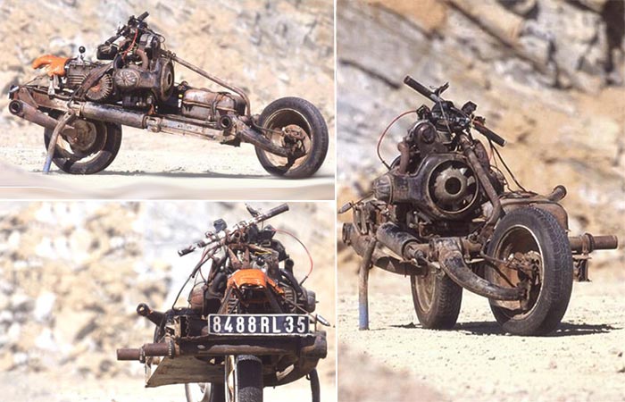

  9. It's a nice story ( guy crashes his 2CV during a desert raid, chops it up, builds a motorcycle and rides it out) but I'm not buying it. Myth Busters tried it and it was unridable

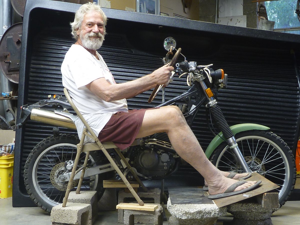

    I have an idea for a cyclecar that I've not seen before but I think will be big fun. I am curious to hear what this group thinks of it.
    What I need is a tiny car to winch up nearly vertical behind my motorhome that will hold 2 persons and a small dog and will be used to explore around while camping out.
    I already carry a 2003 Kawasaki 250cc Super Sherpa on the back bumper. I want to get another and build a ch***is between the two. With a 38" bench seat between the bikes the overall width is 58". I will pair up the clutches, gear shifts and throttles with lots of fine tune adjustments possible. A golf cart rack and pinion looks good to go. Kawasaki says the 250's will give 30 hp each at 8500. Dry curb weight should be around 600 max. That gives a 1 hp to 10 lb power to weight ratio and should make a quick vehicle. Here's an early mock up. Seat bottom height is 25" Why have I not seen something like this before? It's a cheap way to get to a small 4 wheeler P1050530.JPG

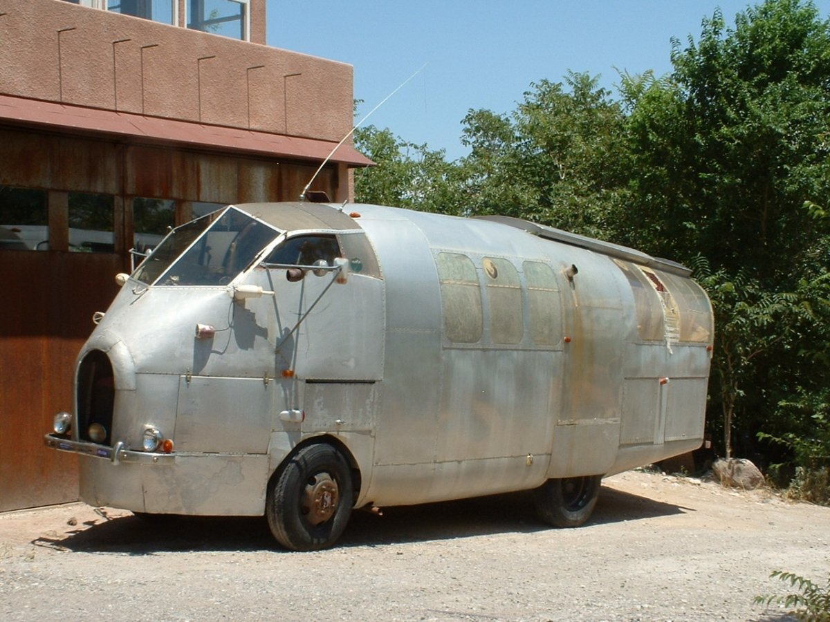

    Tell us, is your avatar a home built RV?
  22. Daviedoall
    Joined: Oct 14, 2019
    Posts: 4
    Daviedoall
    Yes, it is, thanks for asking. I built it in 1981 on a 2 ton Chevrolet ch***is. Recently back on the road with a 5.9 ***mins diesel and getting over 16 mpg with a gross weight of 10,500 lbs.

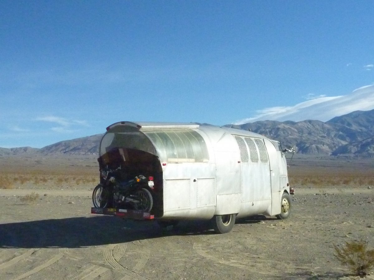

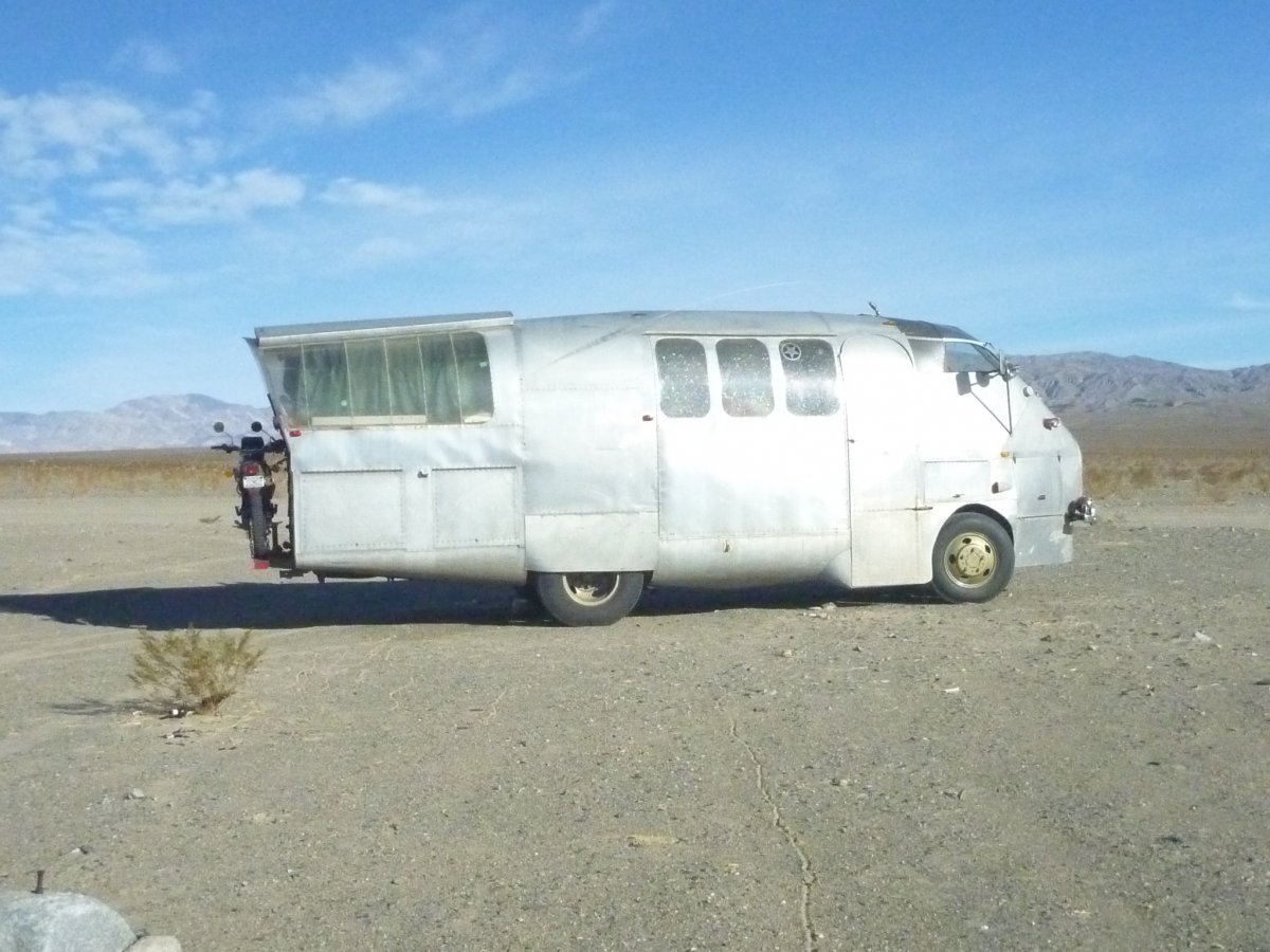

    Thanks for sharing, Davie. I like the RV. Airstream inspired or maybe airliner with a Bugatti grille.
    If I my offer an opinion on the dual Sherpa plan... think about a lower seat height than 25" for the sake of CG.

    Bingo! You are quite right. Last night I lowered the seat to 21". And it can maybe come down some yet. The top of the fork tubes are the thing to see over and will drive the cowling up. I put on another chair and the 48" track seems wide for the 54" wheelbase. I'd like to keep it short to fit behind the Flyer. The 80" overall length of the Sherpa will tuck in below roofline winched up near vertically astern.
    I had a flash to think of this rig as 2 bikes and 1 sidecar. Know of any available Sherpas?
