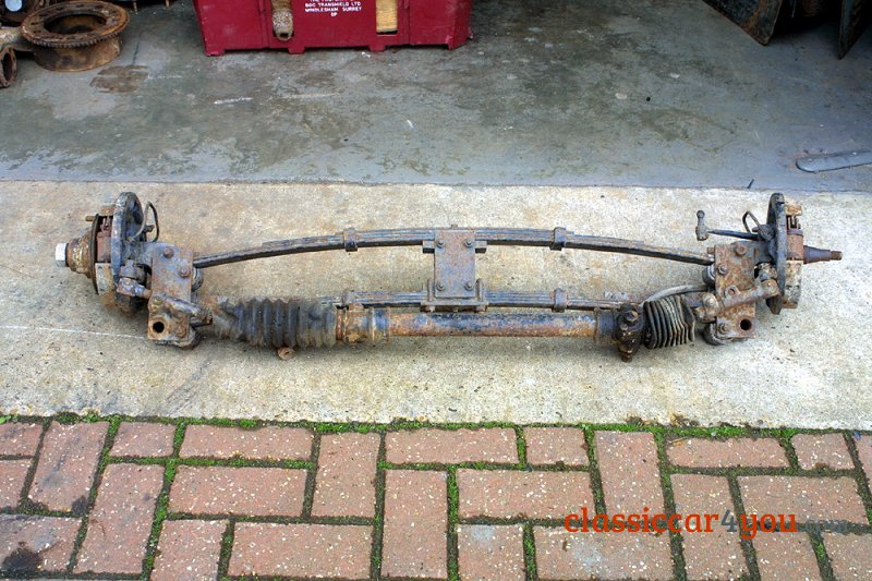

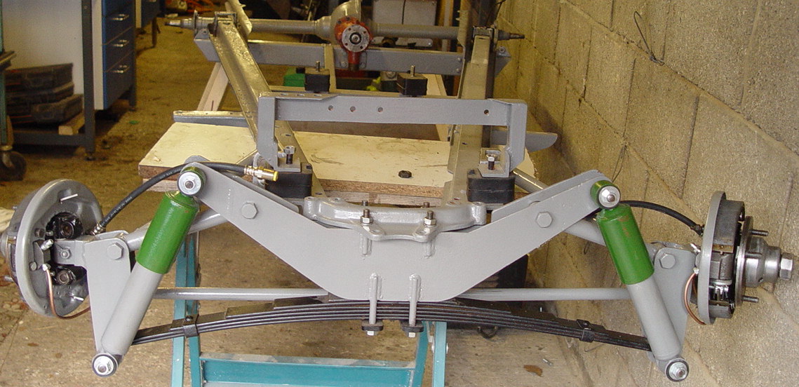

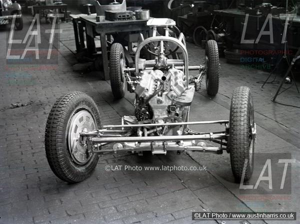

    Austin-7 racer 2ohcChassisMS.jpg austin 7 front shock7.jpg Austin-7 racer 2ohcChassisMS.jpg austin 7 front shock7.jpg austin-bowden conversion1.jpg austin 7 front shock6.jpg

    [​IMG] Could we see more photos of this one? Tires are a bit wide, but I like it. What is the reason for the dab of red paint on the axle? Bob

    That is the only pic I have of that car but here are 2 more with similar axle. They both look like a stock axle that has been flattened ( could be an aftermarket axle). The spring has been mounted underneath. On the yellow car a new spring mount was added underneath. On this new pic he just used the radius rod attachment point to mount the spring.

    It's a forging, hot rivetted. don't know what the exact specification of the steel is, but it's an extremely tough material to drill into. It is quite a heavy piece on an otherwise light car, and because of its shallow section it doesn't do much for ch***is rigidity. Here's the forging and front of the ch***is rails photographed from the top. I fitted this setup on my avatar car to stiffen the front end. It also provides the mounting for the Panhard bar. BTW, you can also see where I have replaced a loose rivet with a bolt through a reamed hole on the right hand side.

  12. For circuit racing you have to have a towing eye. There's one above the red paint on the axle - perhaps a visual indicator for the marshals as to where to look for a towing point?

    Thank you! I can see the eyelet that is also red. Makes since, owner picks the tow point. Bob

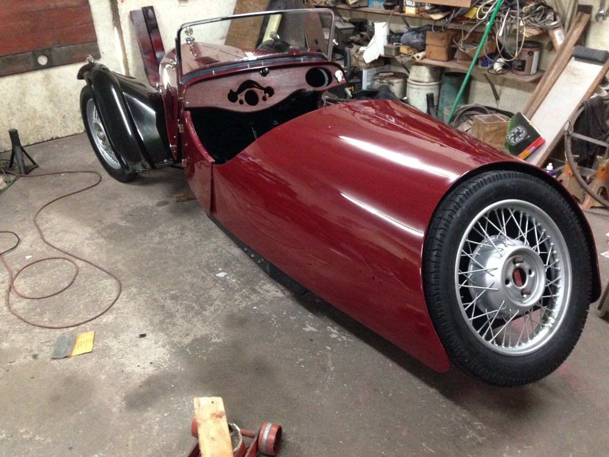

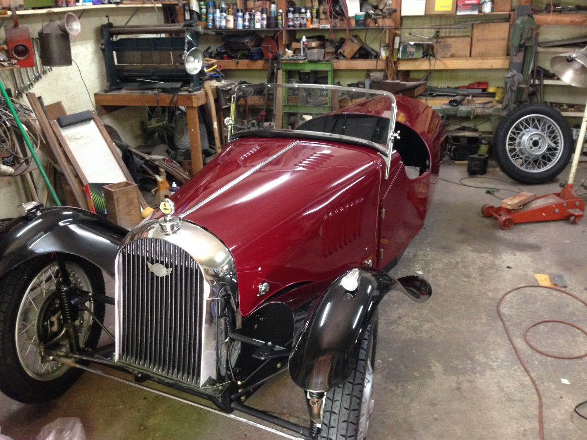

    I've made some big progress on my Morgan build big step.JPG big step2.JPG big step3.JPG

    She's a beaut, Fred
