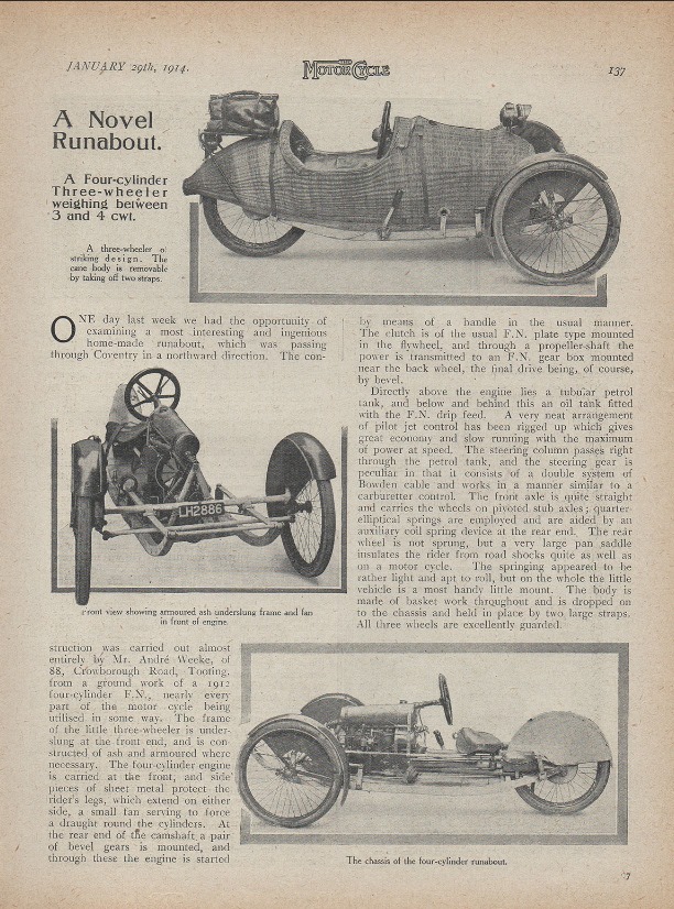

    EVERYTHING goes better with wicker!
  2. SR100
    Joined: Nov 26, 2013
    Posts: 1,353
    SR100
    At that weight, you could say it's quicker with wicker... :rolleyes:
  3. fredvv44
    Joined: Dec 11, 2013
    Posts: 737
    fredvv44
    That is a very interesting car. Too bad it didn't make it into production. Maybe FN wouldn't cooperate.
