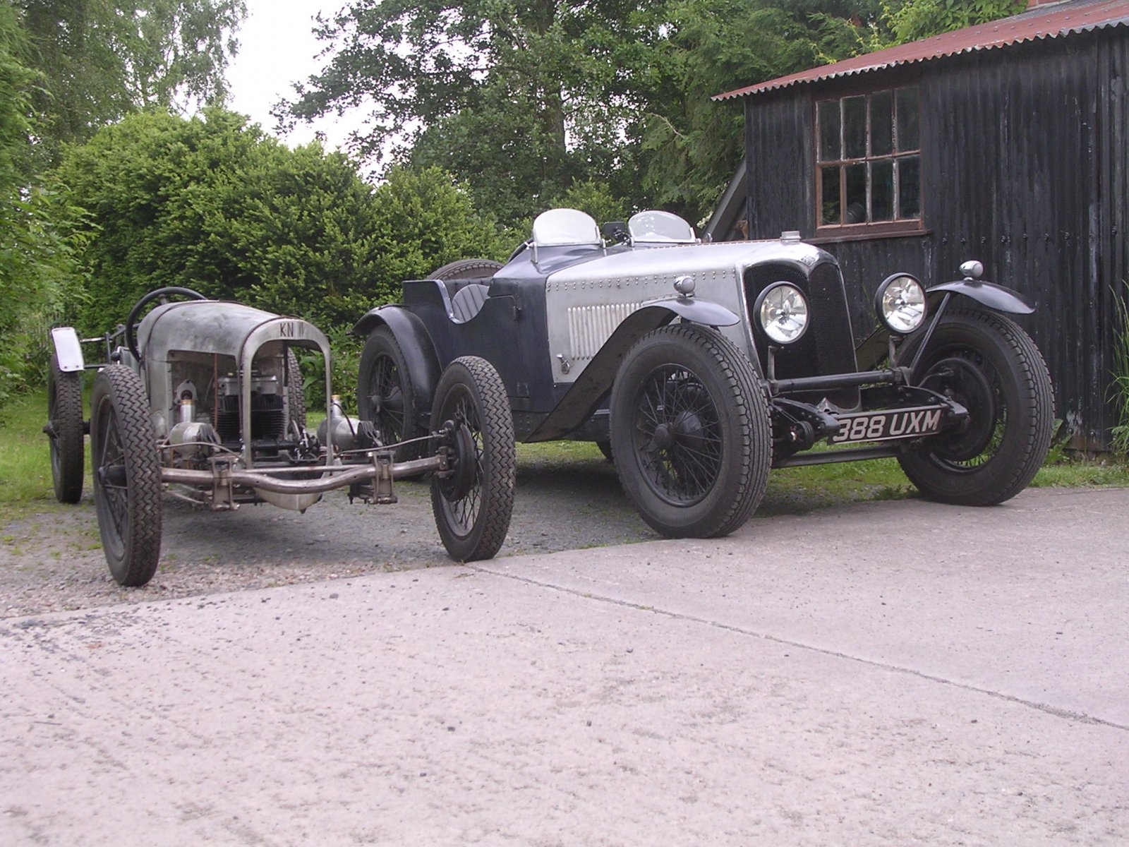

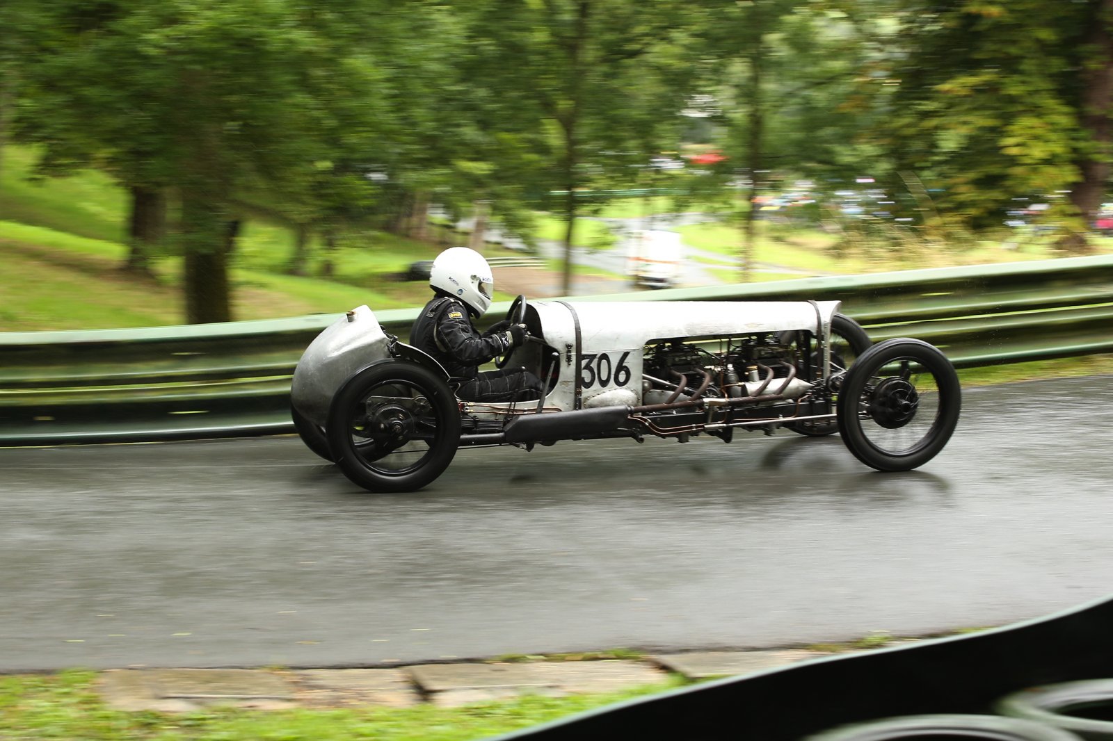

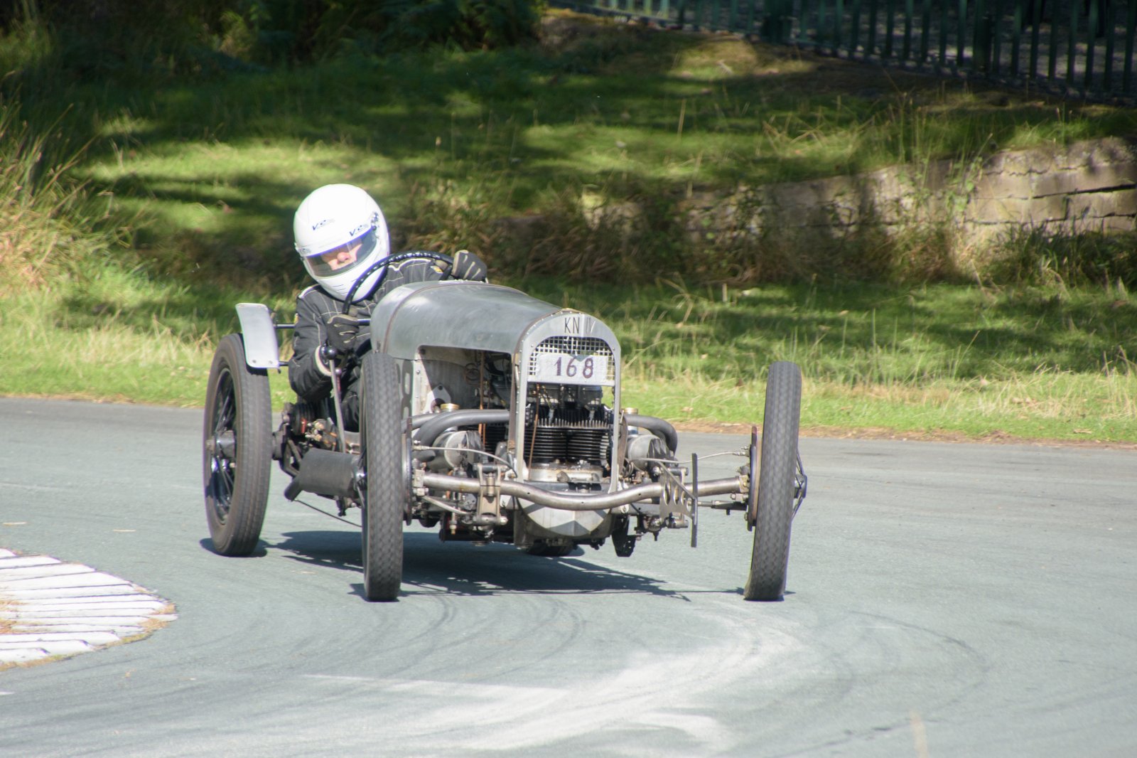

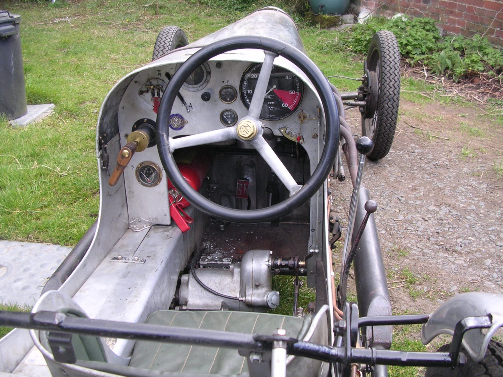

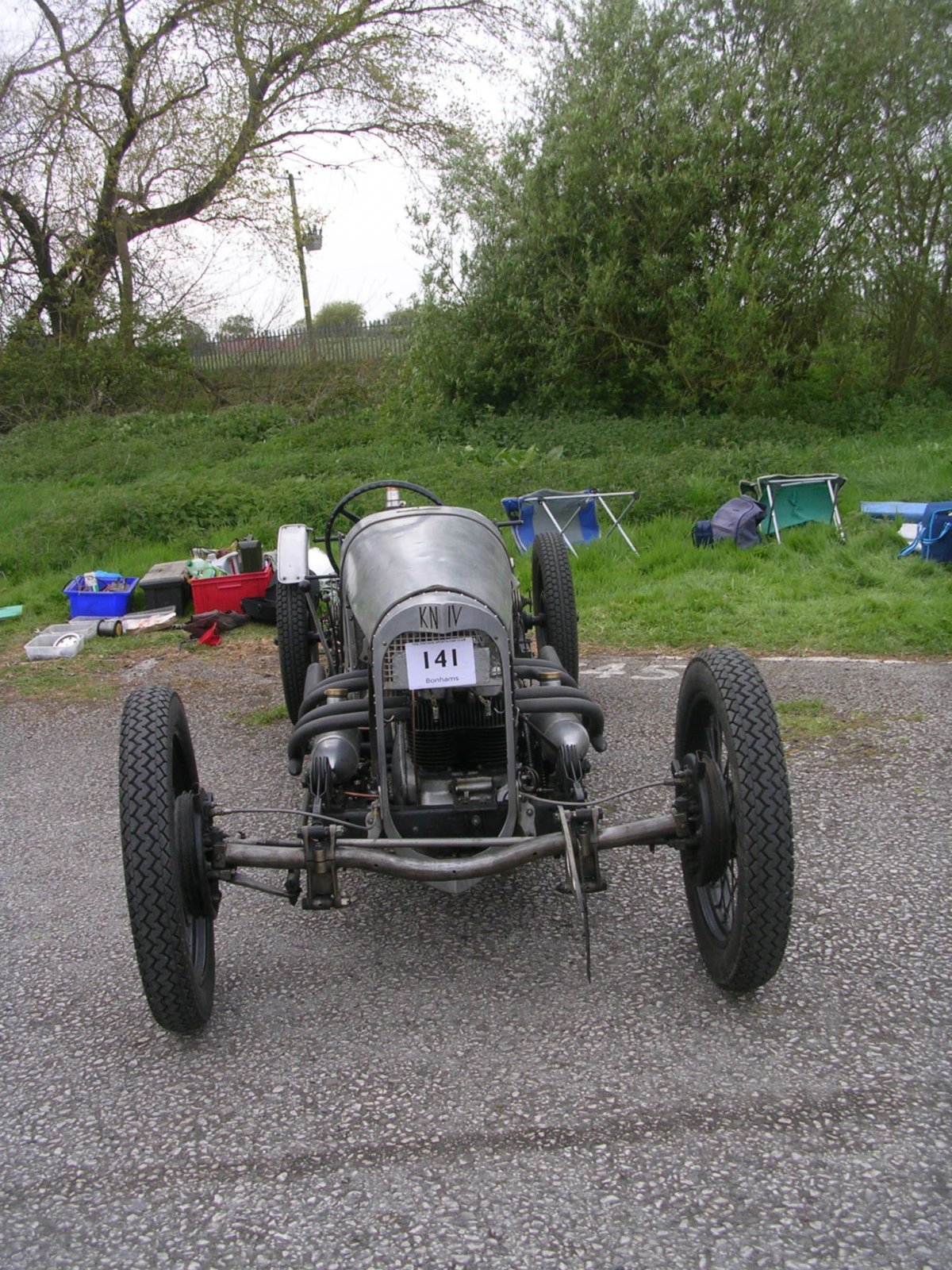

    14.JPG KN Riley 1.JPG The first picture is at a past & rather wet Prescott, the second shows it (minus front engine) next to the Riley, just to give a better idea of scale, it's not very big. ***uming the other photos upload, they probably don't need explanation (I'm better understanding and dealing with ancient mechanical technology than modern, I'm not really cut out for this cyber world!)
    The car is known as KN IV, it was put together at the end of WWII by Kenneth Neve who was a schoolmate of John Bolster and also a past VSCC president. It's quite historic in its way, having much history & is generally very popular, perhaps not with my neighbours. Kenneth devoted a chapter to it, his 4th compe***ion special car together with his earlier pre-war specials in his book 'A Bit Behind The Times', that's well worth reading.
    Trawling back through this thread I see it has popped up now & again and there have been requests for more information about it but I have been an infrequent visitor here & had missed them, however if there is still interest I can (and do) go on about it ad infintum and there are plenty more images. I am pleased that some of you are interested even if it's not strictly a cyclecar.

    The Riley does make it look rather small, but regardless of size it is rather good looking.

    What a lovely car, I did see footage of you going up the hill too!
    Such a privilege to have a car with such history!! we ev

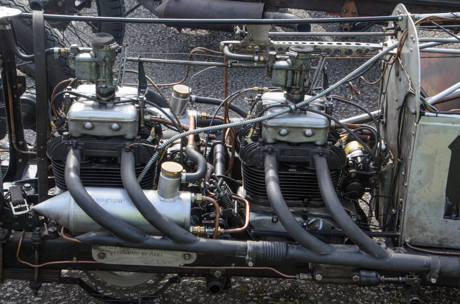

    I would love to hear more about the drive train. What engines are those? From the exhaust it looks like V4 or maybe a square four??

    The engines are Ariel 4G, the pre-war square four, linked by a chain to each other from each of the back crankshafts. Originally a double sprocket and chain conveyed power to a Burman motorcycle gearbox and from there to another double sprocket at the geometric pivot point for the rear suspension and then by chain to the solid rear axle.
    I have replaced the Burman with a Norton Dollshead gearbox and recently introduced another double sprocket between the back engine and gearbox which reduces the thrashing of the previously rather long chain and has enabled me to fit a starter motor there. Bump or push starting has become increasingly inconvenient! The second pic shows 2 crankshafts and central camshaft. You can see the gearbox in the ****pit photo, I have just moved the gear change lever from outside to inside the ****pit too, getting a little crowded in there! Curb 17 engines.jpg

    Thanks for the pix. How are the 2 cranks linked, i.e. are they geared or chained together in sync or at 90 degrees or? Same question with the 2 engines. I've seen some videos of GN's racing and they look like a terror to drive. My Morgans have really quick steering and require very close attention just street driving. Tons of fun!!
    I have replaced the Burman with a Norton Dollshead gearbox and recently introduced another double sprocket between the back engine and gearbox which reduces the thrashing of the previously rather long chain and has enabled me to fit a starter motor there. Bump or push starting has become increasingly inconvenient! The second pic shows 2 crankshafts and central camshaft. You can see the gearbox in the ****pit photo, I have just moved the gear change lever from outside to inside the ****pit too, getting a little crowded in there! View attachment 5144319 [/QUOTE]

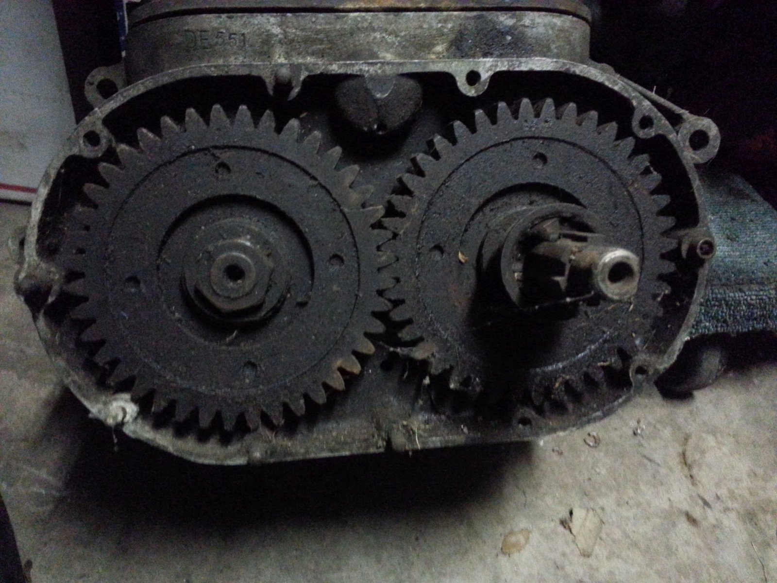

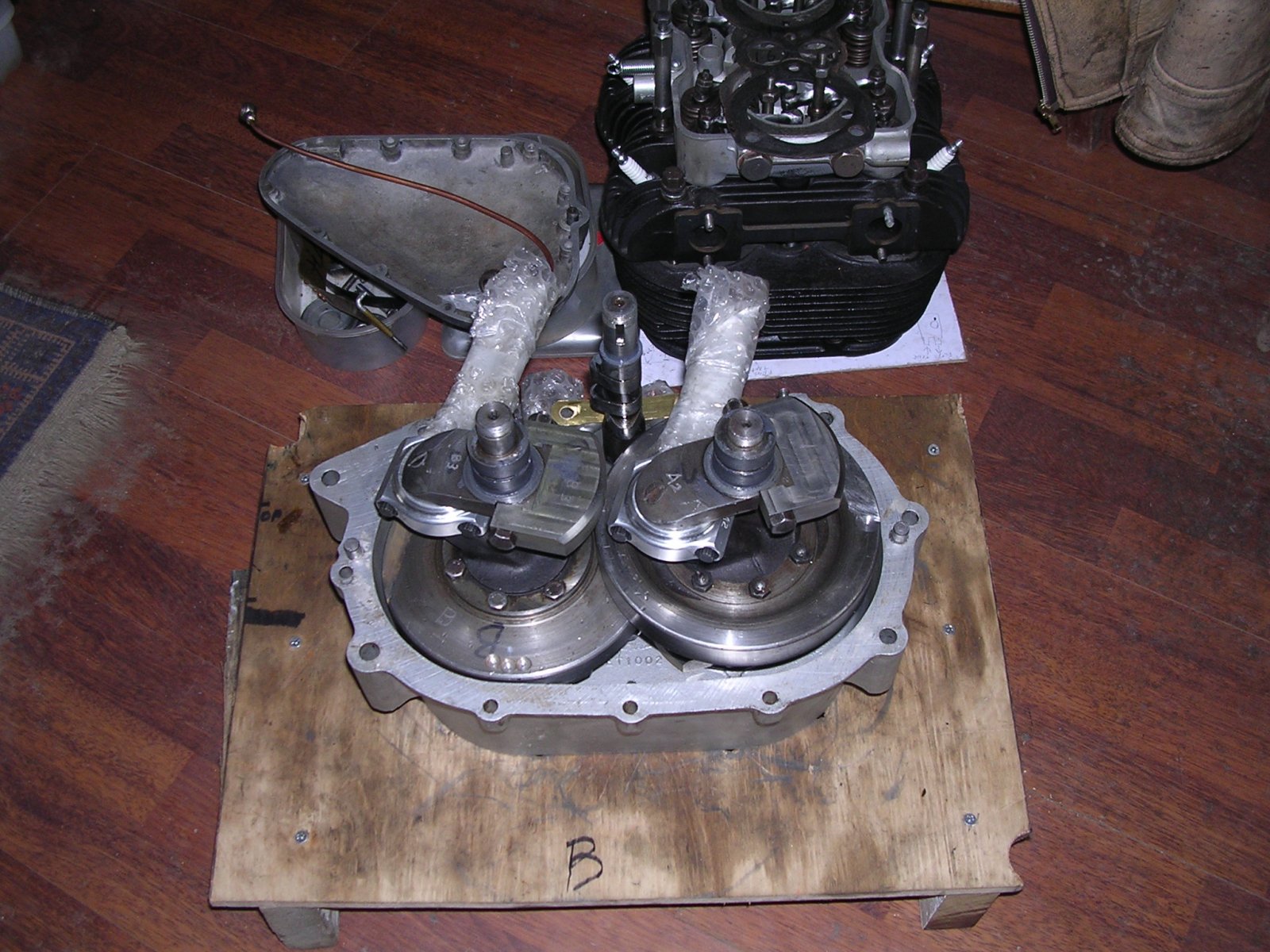

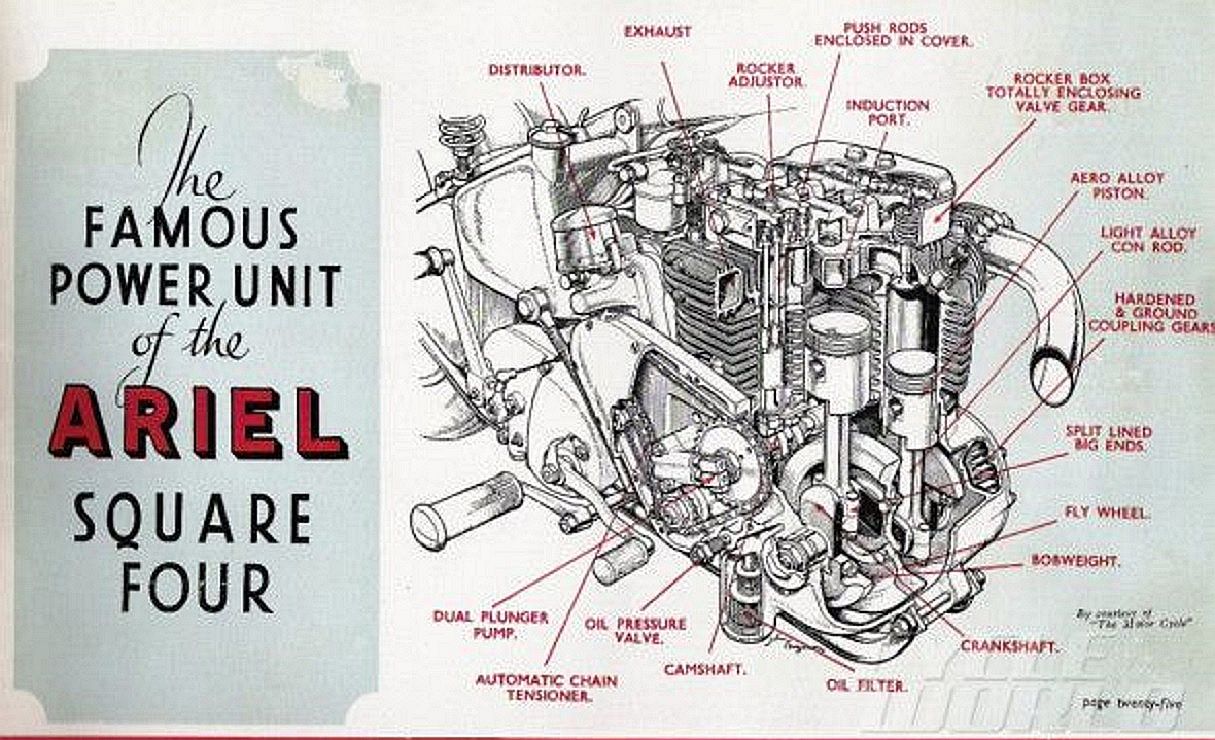

    Ariel Square four motors are essentially 2 500cc parallel twins geared together at the crank. The simple gearing means counter-rotating crankshafts which (in theory) should make for a very smooth running engine.
    The other question is about the downdraft carb setup? It looks like you have some custom counterweights and other goodies in those motors..

    Fred, basically you should think of the engines as 2 Triumph 500 twins sharing one enlarged double crankcase, these and other engines like the Daimler V8 were all designed by the same person, Edward Turner. As Bruce's photo shows, the cranks are mated with a pair of gears and so counter-rotate. When the rh piston of the front crank is at tdc, the rh piston of the rear crank is at bdc, so 180 degrees separate, each piston is at 180 degrees to the other piston on the same crank, if that makes sense.
    I run the second engine at 90 degrees from the first but it doesn't really make much difference how you set it, running them together as a 'big bang' setup is a possibility.
    GNs are pretty engaging to drive, with this kind of power you don't sleep at the wheel. The solid back axle makes for interesting cornering, especially in the wet (I do live in England!) and the quick steering, half a turn of the wheel lock to lock, is neccessary to stay on track.

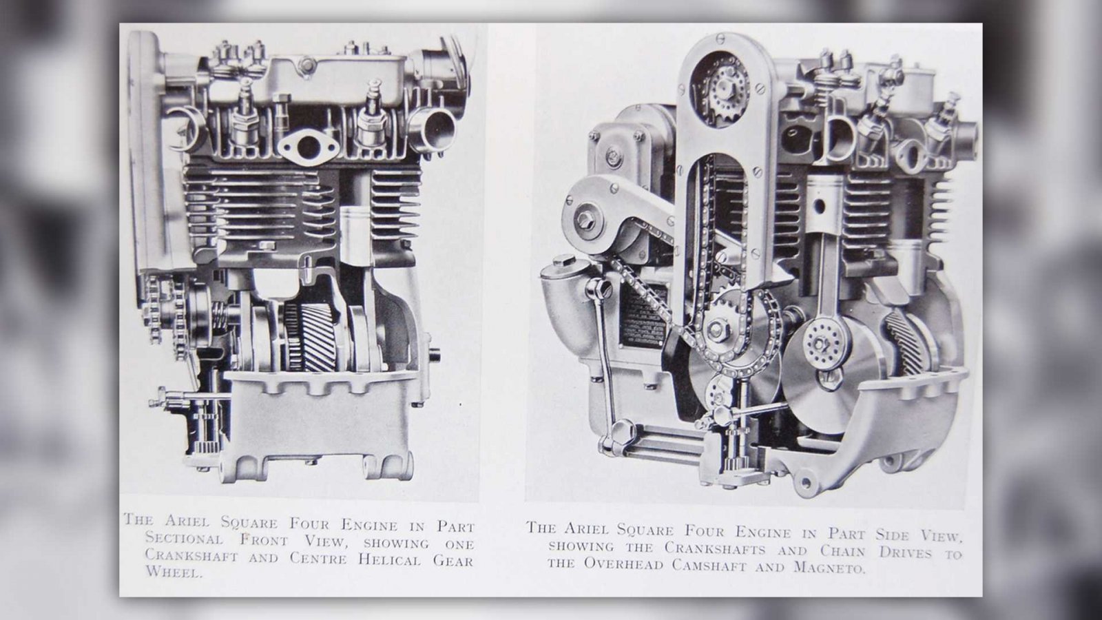

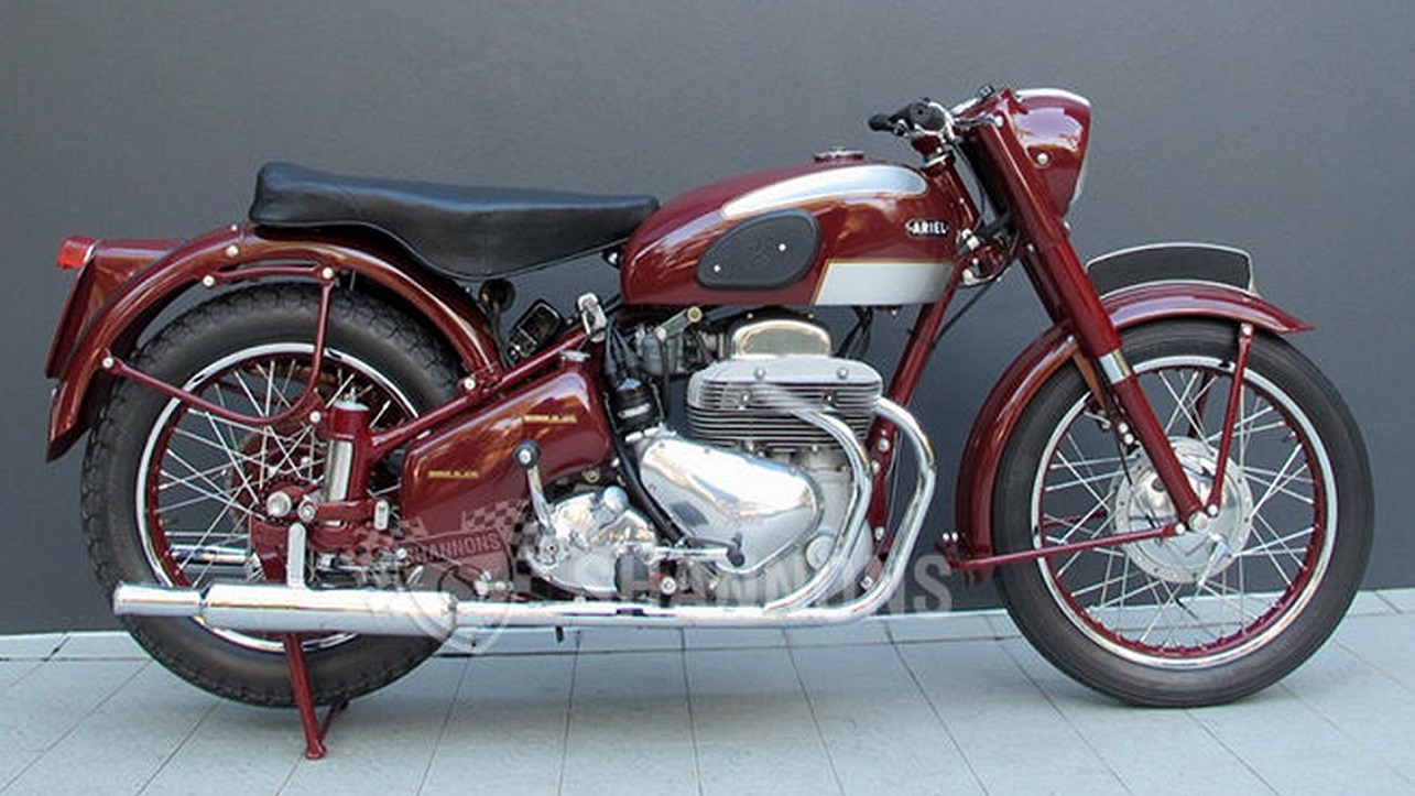

    Now, a little theory about the Ariel Square motorcycle engine - some pictures with sketches, diagrams and photos are attached. Great engineering and cute engines!
    Well, my favourites: just behind aero-engines in automobiles, the second place is for double-engined automobiles and the third place is for motorcycle engines in automobiles... There are examples where all three variants are used in combination, no matter if in cyclecars, bigger specials or veteran-vintage monsters...
    Ciao, Zoran
    Ariel Square engine.4.jpg Ariel Square engine.3.jpg Ariel Square engine.2.jpg Ariel Square engine.1.jpg

    ... the bigger picture of crosssection!

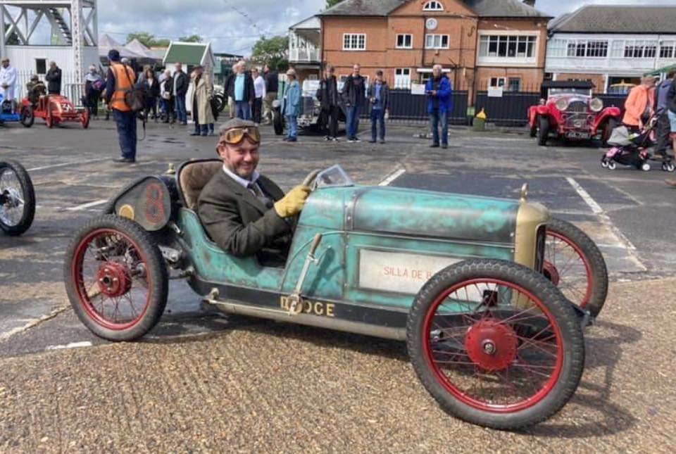

    All I know is the picture was taken at Brooklands.

    Well,
    That photo is taken at Brooklands, during the 95th anniversary of the first British GP..
    But, that is not the original DODGE or any other original vintage racing car! That is scaled-down replica, built as CYCLEKART, similar to some that a few members presented here like to build.
    If you pay attention, you could notice that wheels are taken from the light motorcycles, mostly honda 90 and that engine is in the tail, mostly Honda 200 clone, with TAV variable transmission (belt and pulleys)... In the same way is built cl***ic Renault GP racer, red car in the background, in the left corner.
    Members from British CycleKarts GB were invited to the celebration!
    https://en-gb.facebook.com/groups/CycleKartsGB/
    Small autos, great fun!
    Ciao, Zoran

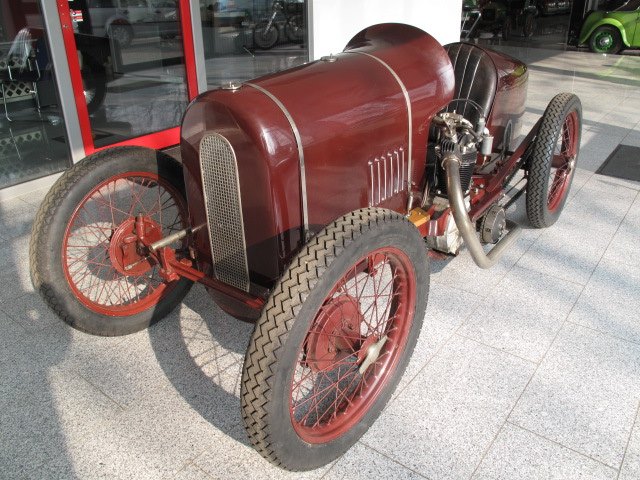

    That looks a lot like "Schasche". I don't know if that is a brand name or a given name. My favorite cyclecar. schasche E.jpg

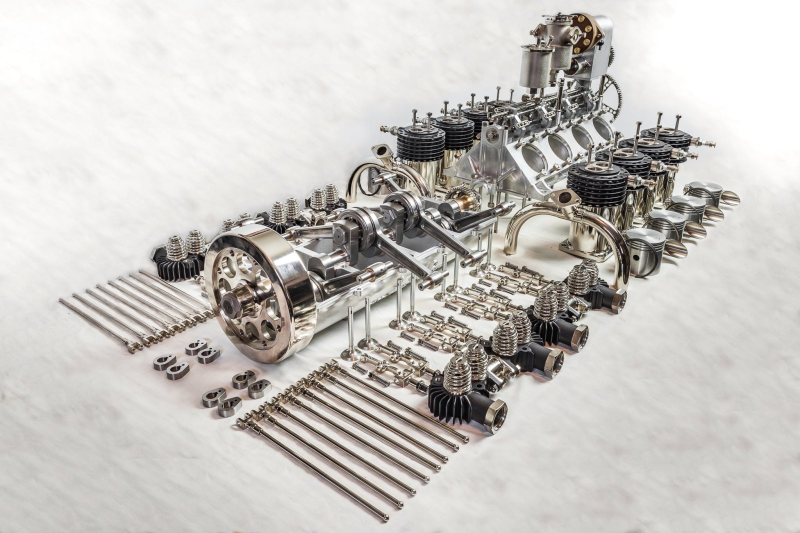

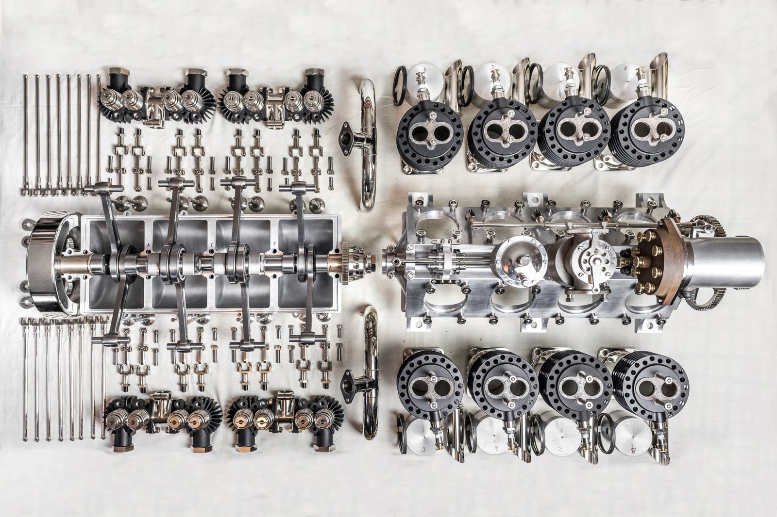

    Here's some pictures of the V-8 J.A.P. engine Pavel Malanik is building from SCRATCH. He was able to measure an unit on display in a UK museum. 241142110_4333863843340504_2347634165022925609_n.jpg 241152102_4333864783340410_3011803067246981467_n.jpg 240962960_4333864350007120_9143678482077807910_n.jpg
