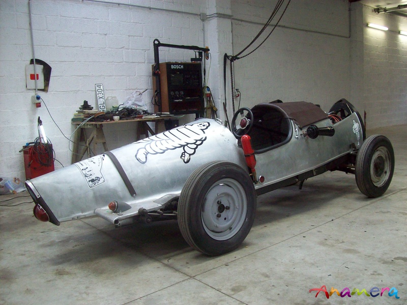

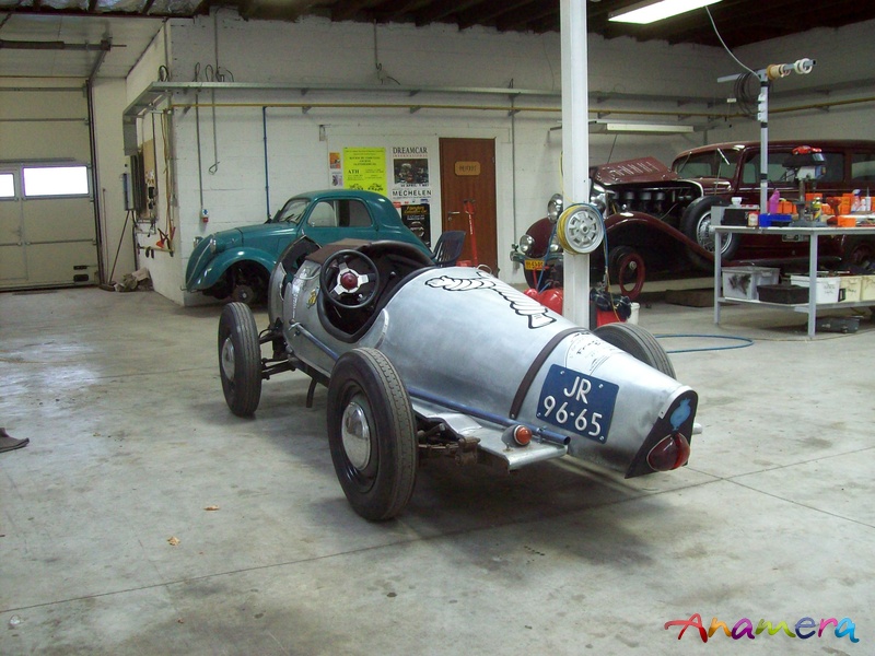

    Hi ,
    I am Anton Deja from Belgium and this is my firts home made Cyclecar .
    Ch***is = Austin 1949
    Engine Morris Minor 1956 1000 CC
  5. Anton,
    Welcome to the HAMB- please share more pics if you have them; that's a great build!!!

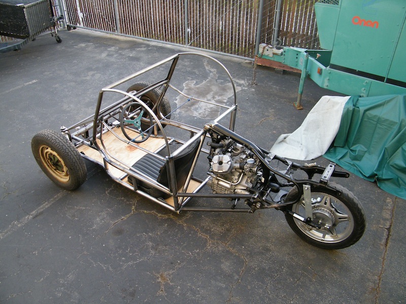

    Great website.
    I've read on this site about using VW front suspension, Honda CX500 motors, and Velorex cycle cars. I thought I would share my project since it uses them all. The picture explains the project the best. I used the VW front end because it's easy, has good brakes, and you can get good roll stiffness by replacing the top torsion leaves with a sway bar. The CX motors have been used in cars with good success and are cheap. I bought a whole running bike that had a clear ***le for $400. It didn't run very good, needed carb rebuilding and a new CDI unit. It still needs a new charging stator. My plan to license it? Just use the CX500 bike plate and go! 75% of the bike is still being used. It works for me. I hope the photo up loads and I will post a more current photo later
