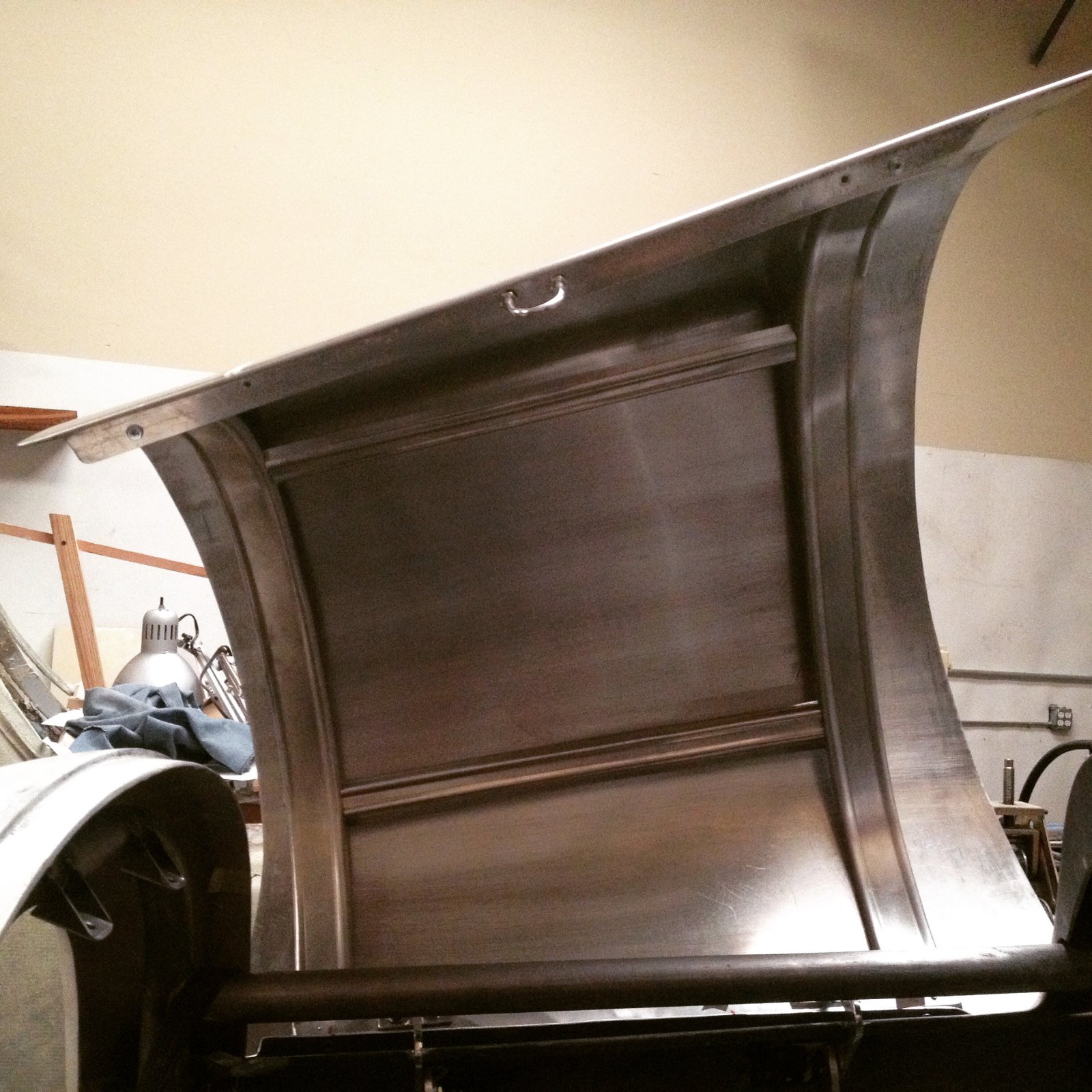

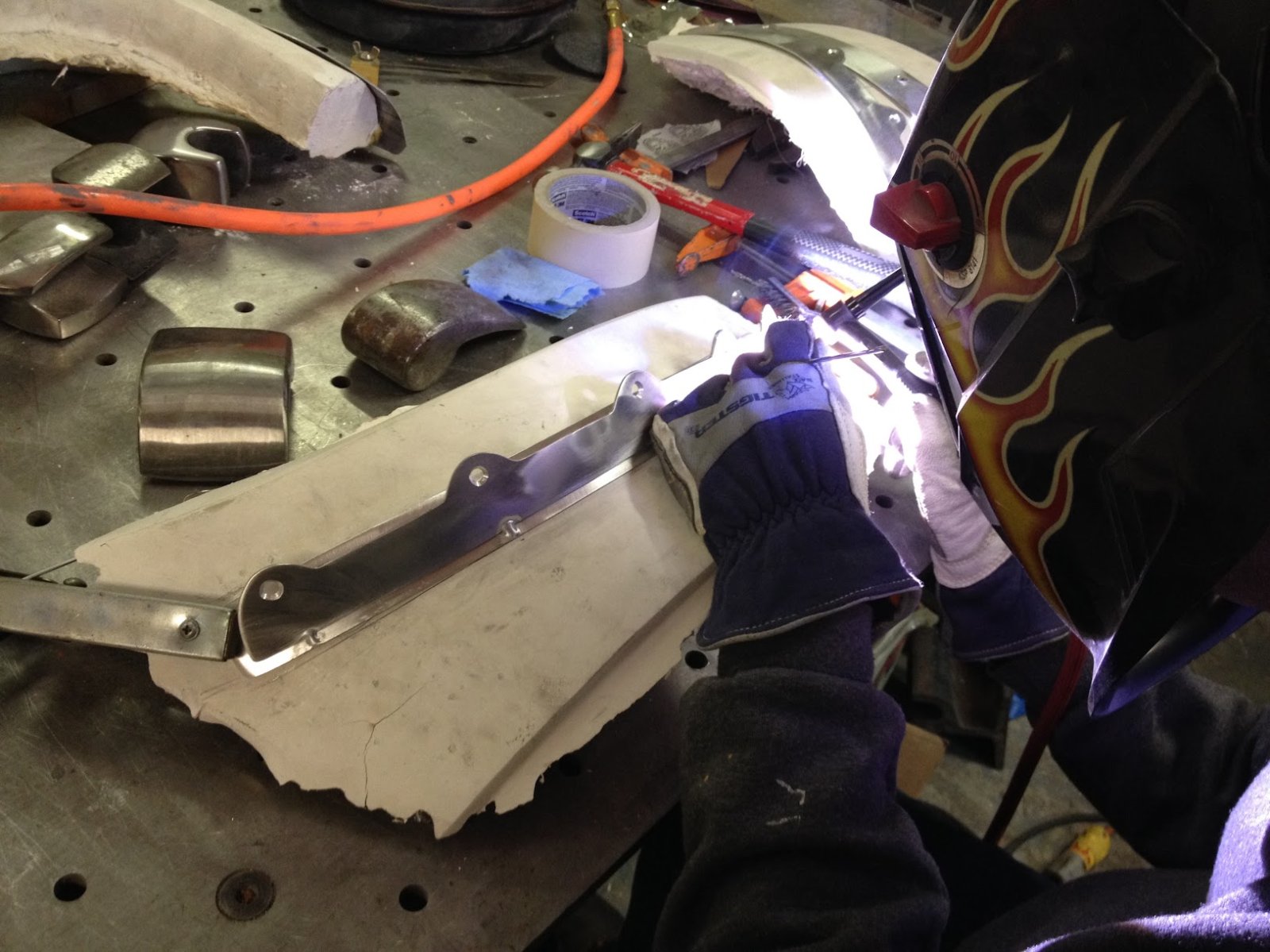

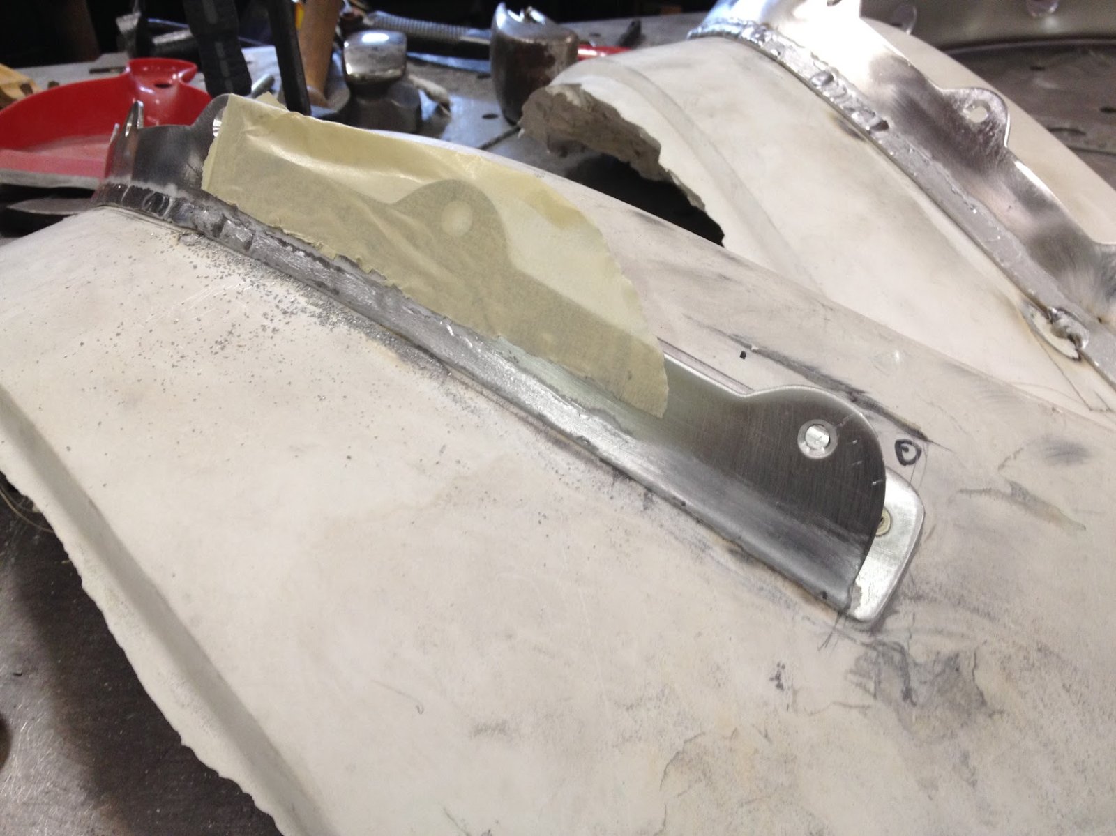

    087B56C6-6E00-4F7B-AFBB-849C536306C4.jpg IMG_3898.jpg IMG_2975.jpg IMG_3875.jpg Grille shell fabrication. Plaster model, wheeling panels, welded ***embly, flange for hood seal.

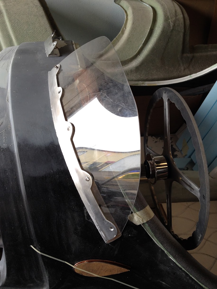

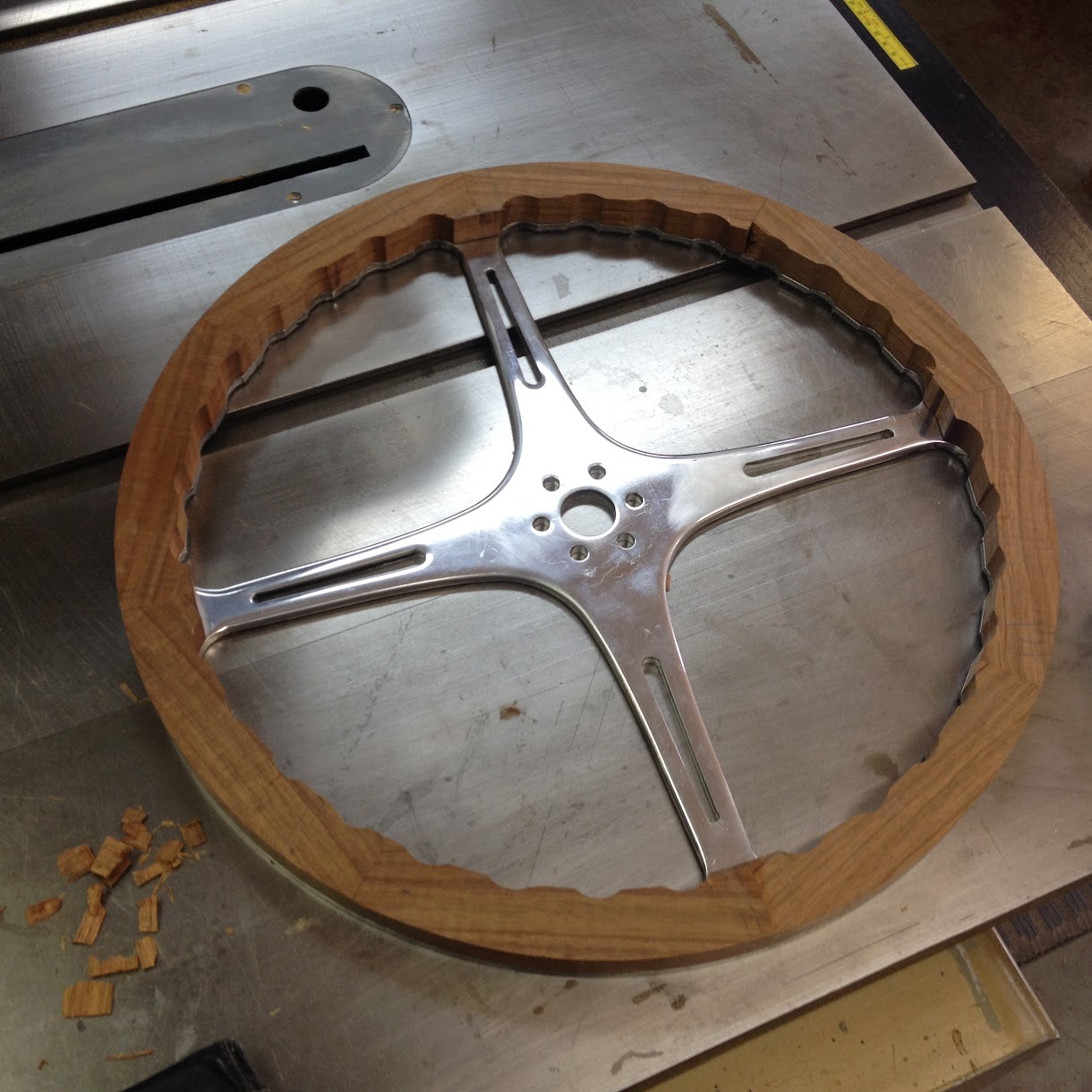

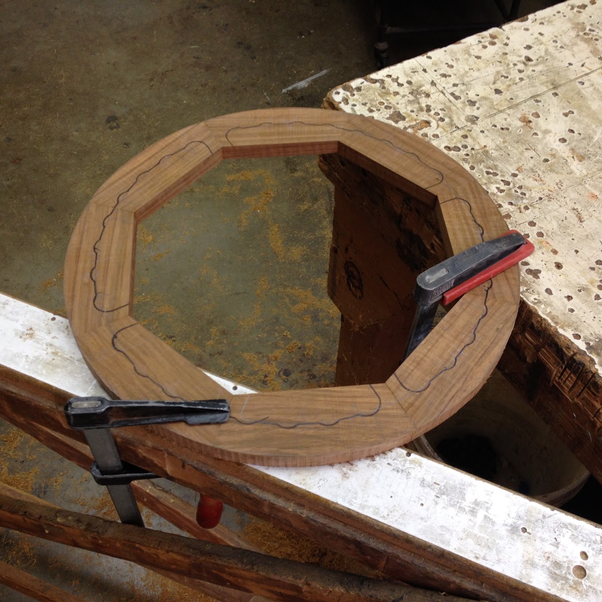

    IMG_2952.jpg IMG_2954.jpg IMG_2967.jpg IMG_2946.jpg IMG_3391.jpg IMG_3390.jpg IMG_3764.jpg IMG_3606.jpg IMG_3611.jpg Wind deflectors in poly carbonate with aluminum mounts.-

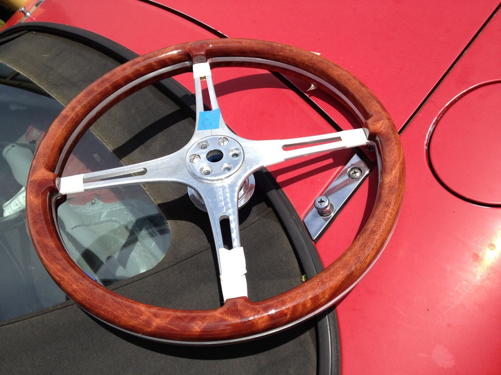

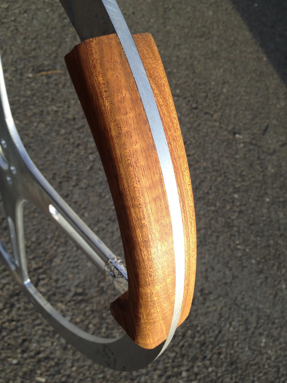

    Wood rimmed steering wheel in 2 hardwoods with 6062 T6 aluminum center.

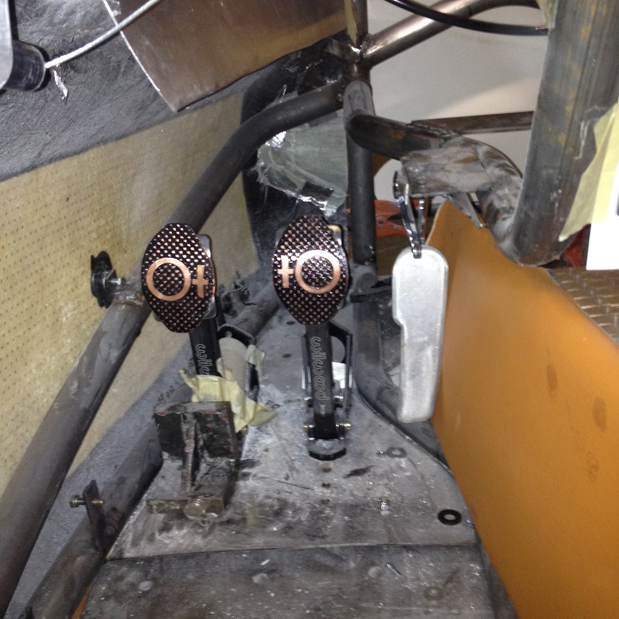

    Pedals are Wilwood units with etched copper pads.

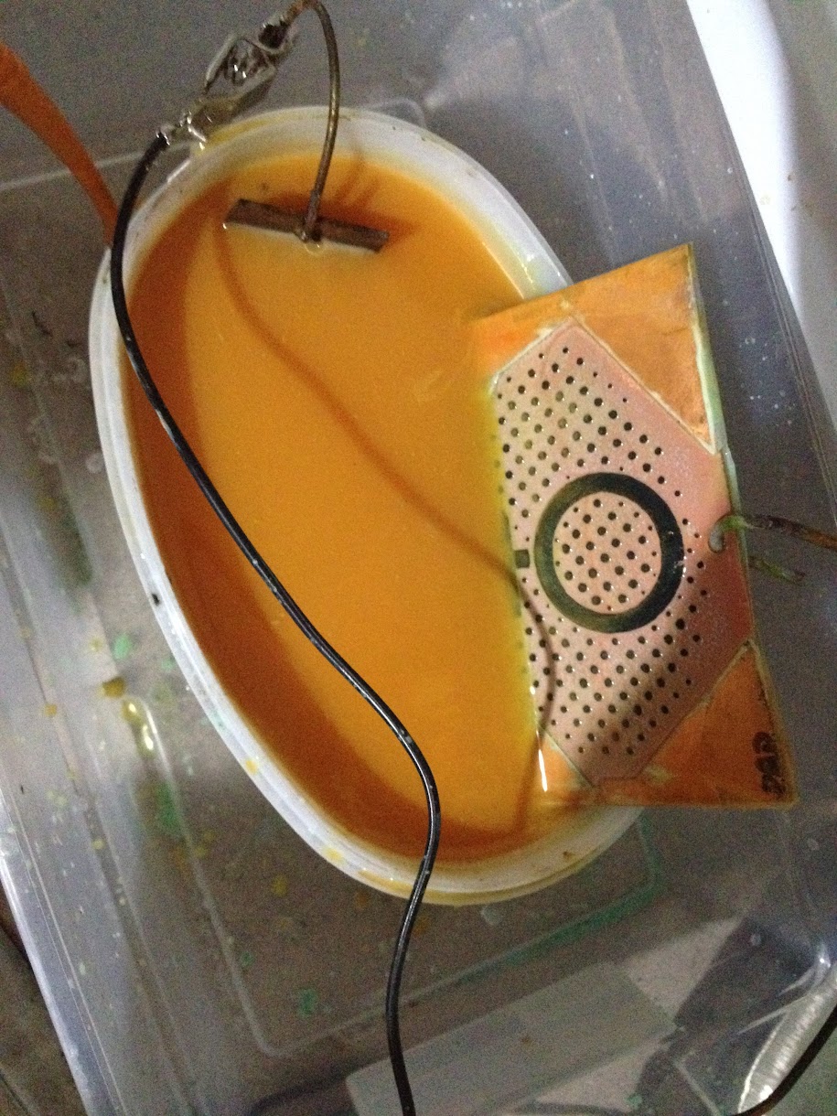

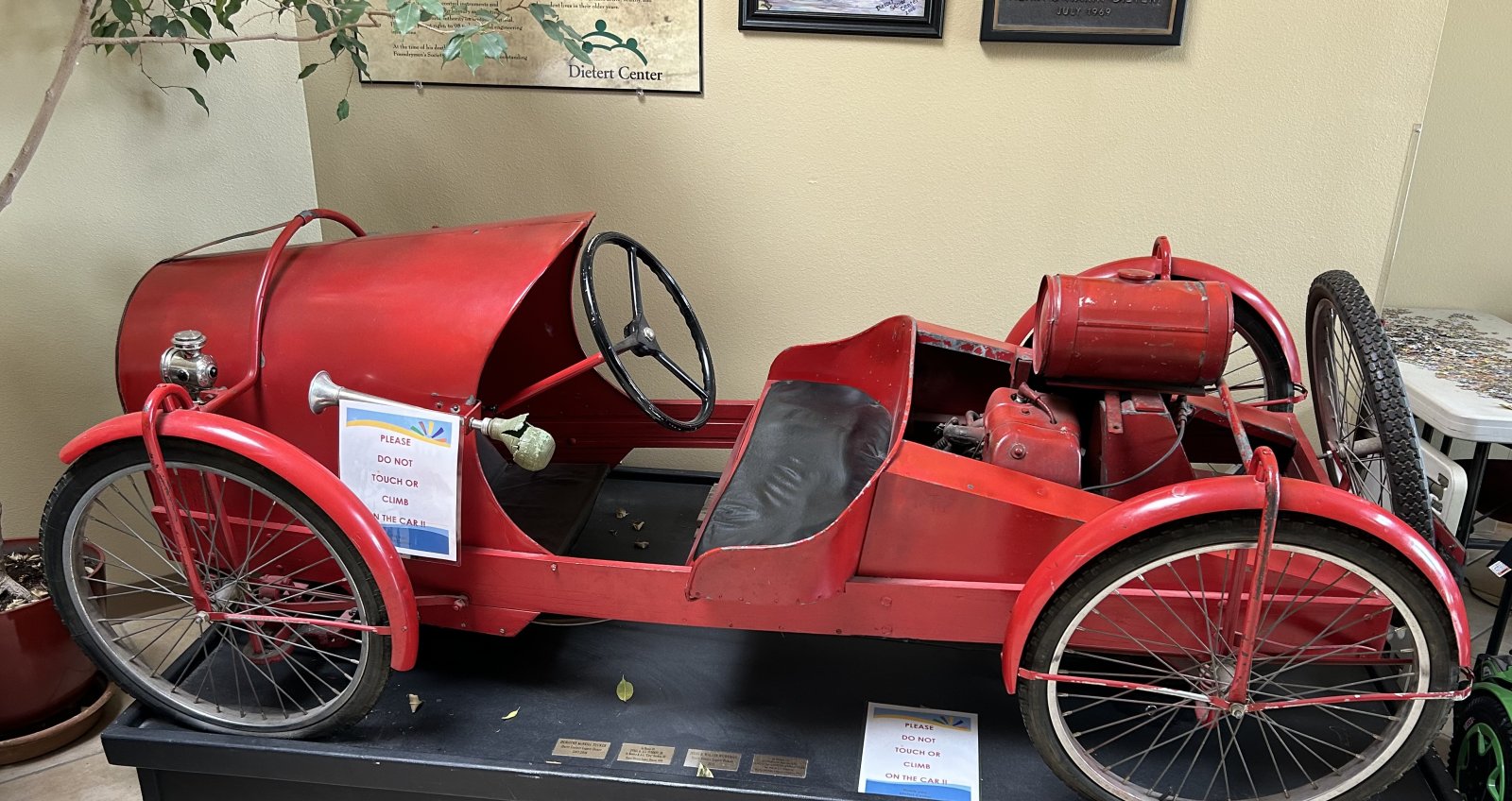

    IMG_4537.jpg IMG_4701.jpg IMG_3501.jpg IMG_3788.jpg IMG_4454.jpg IMG_0998.jpg IMG_1480.jpg IMG_0234.jpg IMG_0236.jpg Upper and lower A-arms with heim joint ends for adjustability. Rack and pinion steering with no bump-steer. Engine turned dash and cowl panel with bead roll. Adjustable pivot steering wheel. Front trunk with brake and clutch reservoirs. Engine turning is done with fine valve grinding paste on felt pads for deeper scratch than a Cratex stick. Lockable glove box contains front hood release lever.
