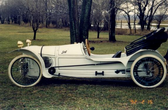

    As I promised in my introduction, here is a picture of the 1913 Imp cyclecar my brother and I restored back in the 80's. We started with a basket case missing numerous parts, back in the early 70's. Al of our research, over a 17 year stretch, found 7 or 8 Imps total in the US. My brother also restored the Trumbull shown in an earlier post in this thread. The tan one with red wire wheels.

    I know nothing about cycle cars. But I like them. And I just love the way this thing looks. The chain guard is just wonderful. Gary

    Whippet96 - That Imp is stunning, well done. Does it get much use?

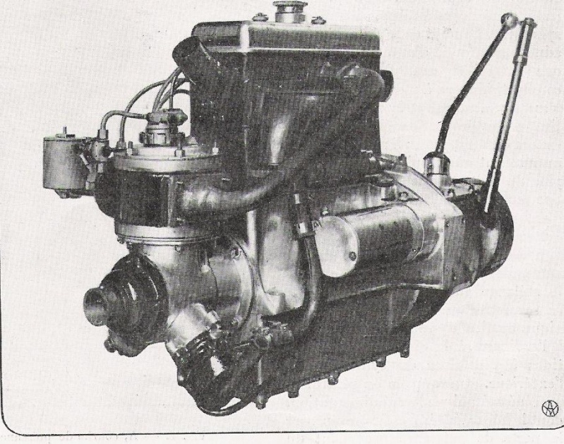

    Ah, proprietary engines. They really need a thread of their own!
