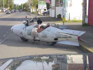

    Cylclarocketcar

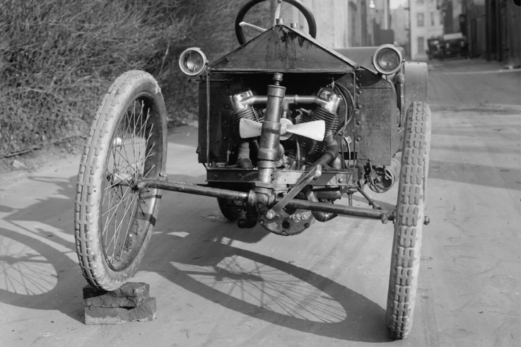

    Spacke Deluxe Powered Cyclecar

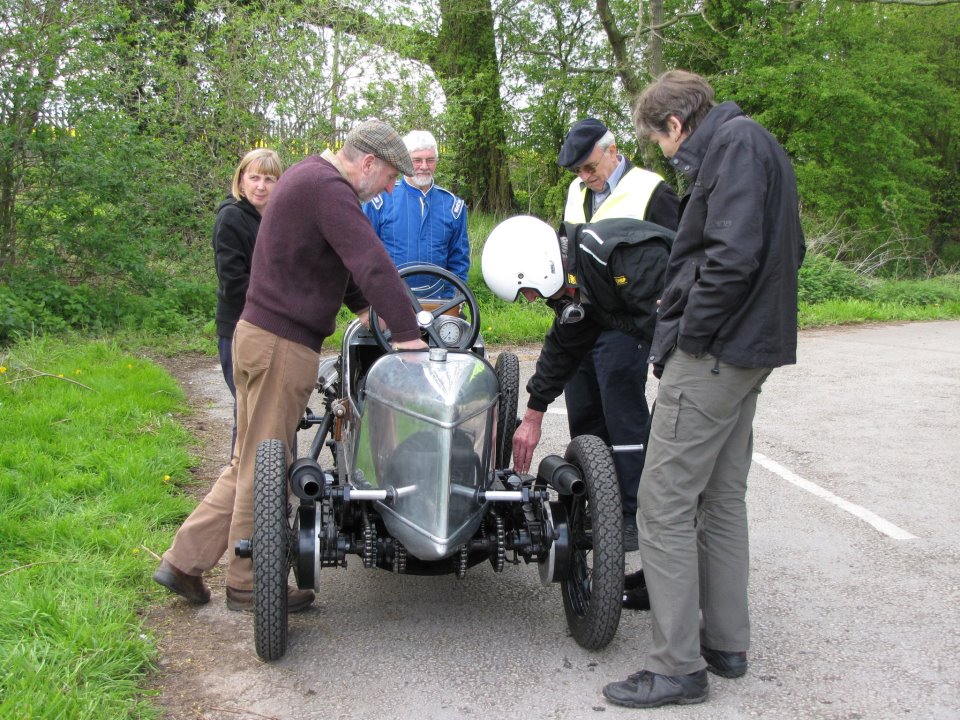

    Morgan. Curborough VSCC Meet. Graham Little image.

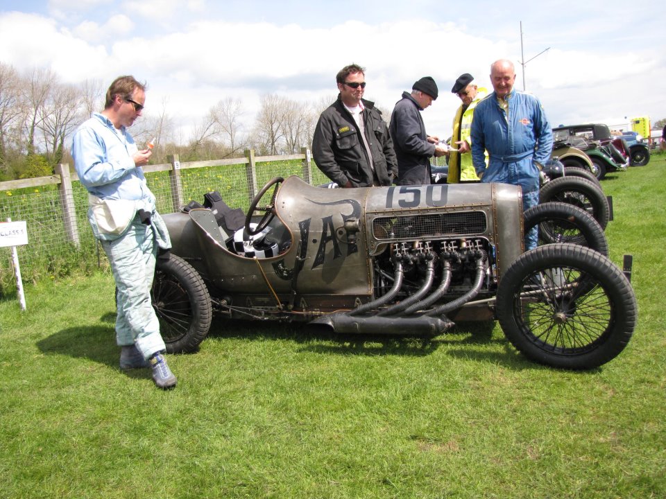

    Scaldwell's V-8 JAP GN. Graham Little image.

    It looks as though the photo of the "Spacke Deluxe Powered Cyclecar" was shot to show how the "Center-Point" steered front end was capable of accommodating bumps and holes in the roadway.
    After thinking some about it, it occurs to me this feature wasn't (apparently) universal to all center-point steered cycle cars.
    Seems as though, without the ability to either pivot or in some other manner accommodate roadway irregularities, the frame of those cars lacking some sort of pivoting arrangement would transfer some or maybe most of the twisting moment to the frame and body - - - not something that suggests a very long or useful life for the vehicle.
    Anyone here have any thoughts or explanations on this curiously apparent potential area for ch***is problems?

    The car itself is quite light, and would most likely bodily move up and down to negotiate such irregularities. Some of the forces involved would go into deflecting the tyres, however; and what remains would twist the frame.
    I wonder how the articulation on the above SDPC was achieved, and whether it incorporated any sprung resistance to roll. I mentioned the loading of the outer front wheel in turns and the consequent tendency to steer opposite to the intended direction in a previous post. Having no resistance in the articulation would make that loading and tendency go away.

    Just guessing here - - but the center of rotation for the front steering/spring ***y. of the "Spacke Deluxe Powered Cyclecar" looks to be located a few inches or so above the top of the front frame cross-rail.
    Fooling about with a crop of the front end geometry produced this - - (someone with better computer skills should be able to improve on this).
