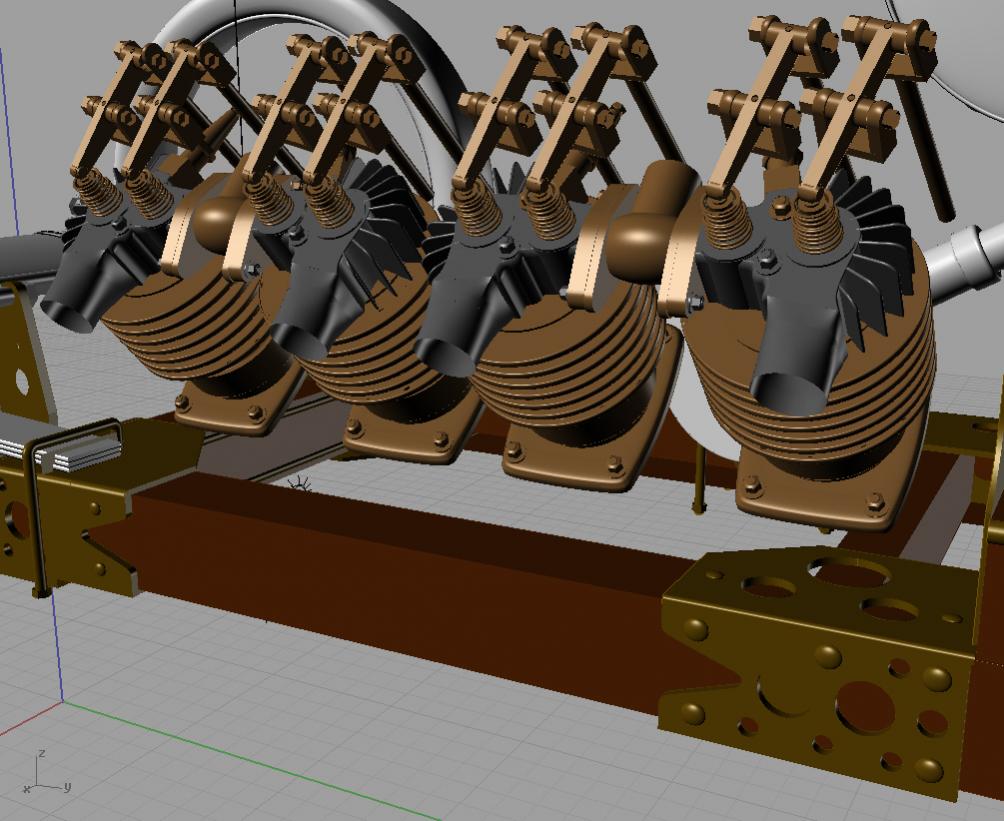

    Great thread. Not to get too off subject but what more accessible V8 engine could be used in lieu of the JAP 5 litre? 2 siamesed straight 4's vintage motorcycle straight 4's perhaps? I can't think of anything that gets even close to this. Especially considering it's an air cooled V8.
    Let's hear some suggestions.

    4 harley knucks inline?

    You beat me to it! though I was about to suggest eight knucklehead barrels and heads on a fabricated 90° crankcase.

    Or better yet,8 BMW jug and head ***emblies from R1000 bikes on a fabricated crankcase!

    That sounded all wrong until I realised you'd have to rotate the ***emblies 90° to get the porting to work. All these have the disadvantage that the pushrods would sit between successive cylinders, making for complexity and a long engine.
    But what about eight Continental/Franklin/Lycoming/etc. barrels and heads on that crankcase? Used upside-down the porting would all be in the right place.

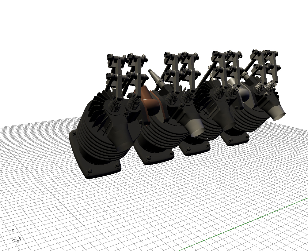

    Very interesting ideas here. I was thinking large bore VW cylinders with replica heads cast and a custom cast block. Fab up some rockers on bearings and keep the oil in the block. It would be nice to find an existing crank to use if that is possible.

    Don't know why I didn't think of it sooner: Porsche 911 heads. They do have a single overhead camshaft stringing them together, but they will certainly work.
    I was already considered a middle-aged walking automotive encyclopaedia by those who know me when I first learned that real air-cooled 911s have six individual cylinder heads:
    The cam-box is a single piece over the top of them, though, which opens the way for a cobbled-together open rocker arrangement instead.

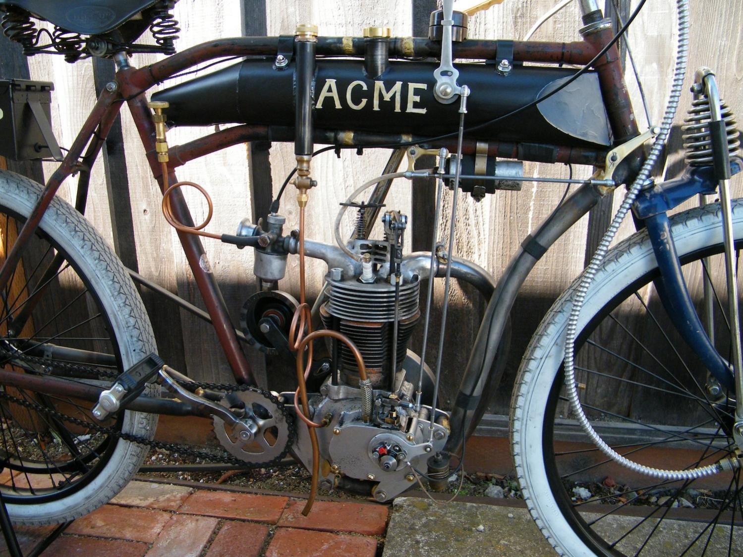

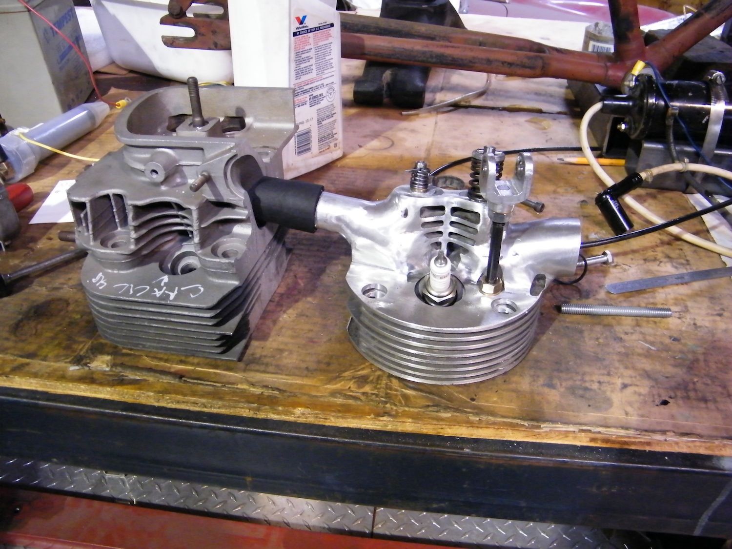

    I have to chime in on the fabricating ( cobbling) a V8 air cooled motor. Here's an idea on the VW cylinder theme. I made this bike motor using a VW 1200cc top end. The pictures explain it pretty well. Honda 125 crankshaft, top of the rod cut off and then I welded the top of a VW rod on. Super short stroke. Half of a B&S cam, atmospheric intake valve. Fabricated crankcase. It's about 260cc, and about 2HP.
    A V8 could be made with this same top end idea. I would use 1600cc parts, and a real inlet valves. Maybe you could use the VW rods narrowed on a wide rod journal inline 4 crankshaft. Flat crank, air cooled, fabricated crankcase V8.
    It may not be a good idea, but it's a thought.
    Cheers, John

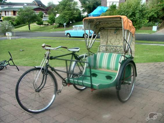

    Since I own a somewhat down on its luck sidecar rickshaw already I thought it would be great fun to build a Sociable replica using most of its frame and mechanical parts with various elderly heavyweight bicycle, aged motorcycle and light car fittings I already own thrown into the mix just to help it all along.
    I do have the original wooden rickshaw sidecar body which is in good enough condition to use after a little repair work and a decent coat of paint so I seem to have most of what I'll need already. The 2 seater sidecar body is basically cyclecar-like in shape and with a new plywood nose and a door on the left hand side it should look every inch the part :)
    Believe me when I say that my rickshaw looks waaaaaay better in the photo than it does in real life. It had a hard life and needs work, but nothing too serious fortunately. I will be using a convertible top on my Sociable, but not that one as it's not in good shape and the stays and bows need replacing.
