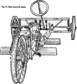

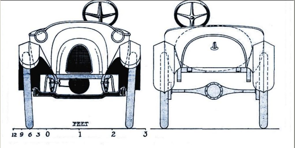

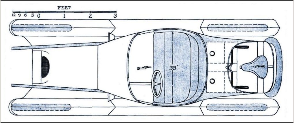

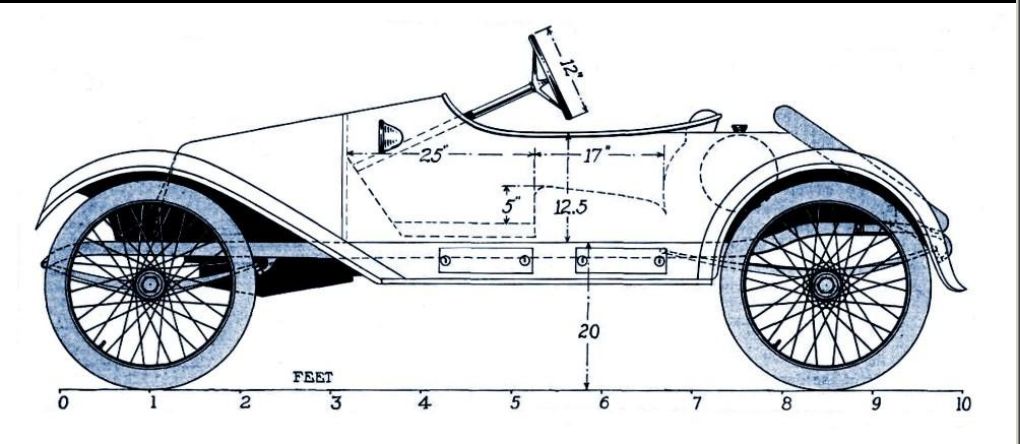

    George J. Mercer designed cyclecar published in the 'Automobile' magazine; The 'Little Microbe' cyclecar. There you go Chu** :)
    I included an interesting photo of a 1911 West cyclecar ch***is as well.

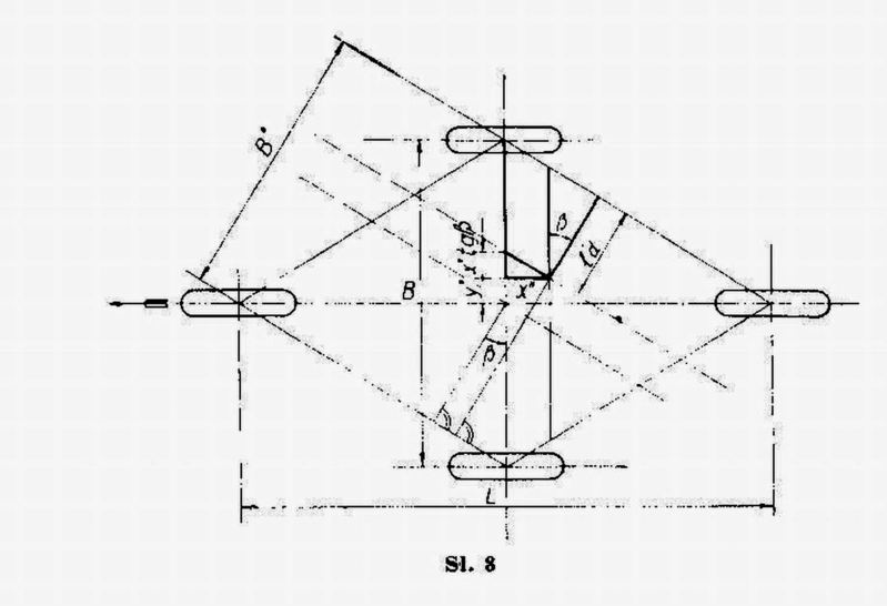

    Here you go :D
  19. SanctaRosa
    Joined: Apr 12, 2010
    Posts: 199
    SanctaRosa
    Hope this helps :)

    Like a miniature Gordon Diamond:
    The central articulation is interesting. I explored a lot of this sort of thing in terms of equivalent interconnected sets, and kept running up against effective equivalent track being less than the actual track, resulting in a condition where under lateral acceleration a vehicle would lift one wheel and flop over onto its bump stops too long before reaching its theoretical tipping point. I think I might have a solution, though.
  21. Zerk
    Joined: May 26, 2005
    Posts: 1,418
    Zerk
    Smashing! THANK YOU, Sancta Rosa!
  22. Zerk
    Posts: 1,418
    Zerk
    Thank you for the very interesting comments, Dawie!
    This effect you mention as limiting lateral acceleration, perhaps severely; would the use of larger diameter side wheels, using tires of low aspect ratio have a greater adverse effect? The vehicle I envision is fairly low-slung, with larger side than fore-and-aft wheels, and very little coachwork.
  23. Ned Ludd
    Joined: May 15, 2009
    Posts: 5,586
    Ned Ludd
    Zerk, I'm talking specifically of equivalent interconnected sets, i.e. two wheels and an interconnecting mechanism, which, though physically arranged in the conventional way with one at each corner, behave in certain ways like a diamond-plan or three-wheeled arrangement.
    Because the diamond plan is effectively two "trikes", the stability of each against tipping over will be limited by the effective track of a "trike" being that proportion of the two-wheeled axle's track that corresponds to the location of the centre of gravity relative to the wheelbase. It is modified by the fact that the two "trikes" share the same two-wheeled axle, so the instability of one will in some ways be cancelled by that of the other, to the extent that they are similar in weight (i.e. a very heavy "trike" might tip over simply taking a very light one with it).
    When this gets translated into equivalent interconnected sets we get the situation where instead of load being distributed between the two wheels of each set according to the geometry of whatever mechanism links them, one wheel gets lifted off the road while the other drops onto its bump stop. If we are talking a literal diamond plan this won't happen. The closest would be the above weight-bias situation, with the vehicle simply tipping over.
    I don't think your wheel diameter idea should be a problem, except in so far as tall wheels might tend to raise the centre of gravity, especially if they are conventionally driven. Keep everything low - and evenly balanced - and you should be good.
  24. Zerk
    Posts: 1,418
    Zerk
    Thanks for the explanation, much clearer now. The front and rear "trike" behavior hadn't occurred to me.

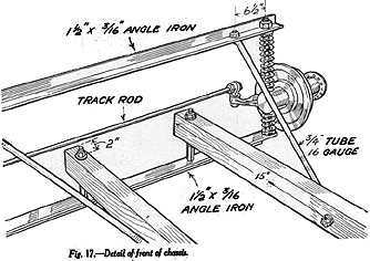

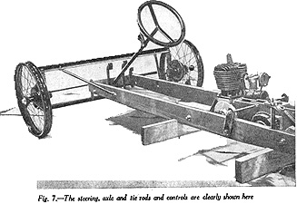

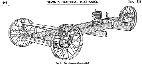

    I've been looking over the PRACTICAL MECHANICS cyclecar articles today and I made the decision to use as much recycled and s****yard material as I can with this build. Things like bolts and the like will all be new of course, but as much as possible will be genuinely old and discarded which should give the car a nice patina so it doesn't look brand new. For the ch***is rails I'm considering using Rimu which is a native New Zealand timber and can be found in the local demolition yards easily enough. A suitable rear wheel from an old European motorcycle is already to hand, but at the moment I'm not sure what I will be using for front wheels. I do own a pair of Ford 10 stub axles which I'd like to use, the alternative being a pair of Morris Minor stub axles fitted into a custom made carrier which is a lot more work, but more authentic looking.
    The magazine articles describe the front suspension as being copied from a Carden, but as shown in the drawings there are quite a few of the bracing rods normally found on a Carden entirely missing from the front suspension. Needless to say I will be fitting these in place when I build my car!
