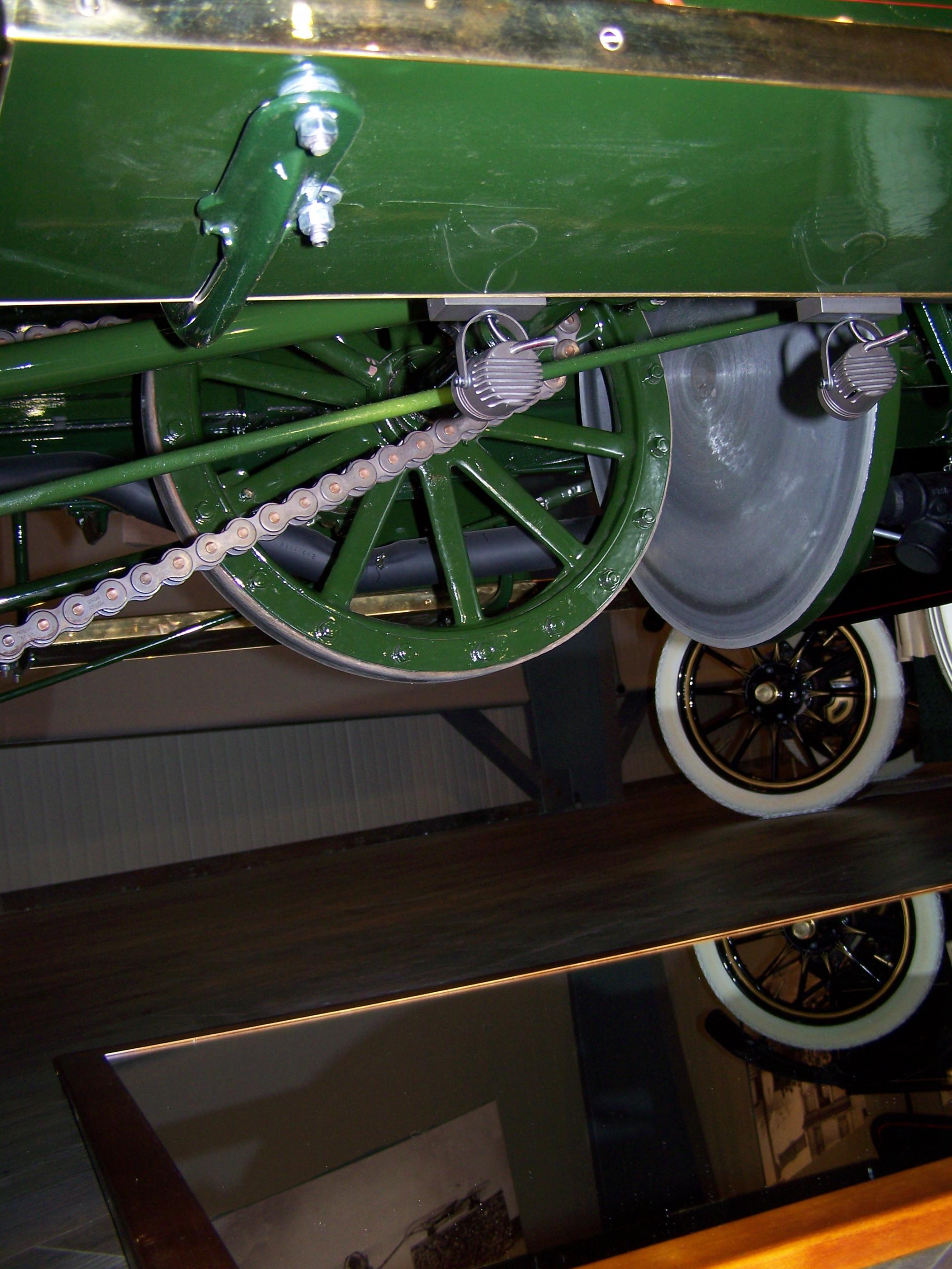

    Variable speed disc drive,CarterCar

    One of the problems with friction drive is if you engage the drive too slowly the wheel skids on the other causing a flat spot on the wheel which then causes vibration and the only cure is to either skim the wheel or if there is not enough friction material it's a reface job,
    Good points the car can go as fast in reverse as going forward , drive taken from other side of the disc to o backward

    Not feeling any love for friction drive if a simple gearbox is available.

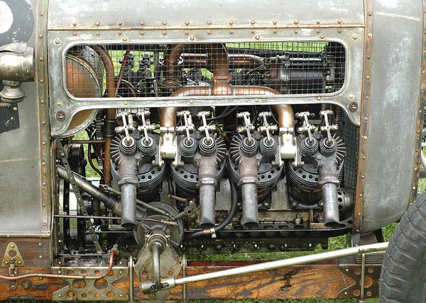

    I think Rick Scaldwells V-8 J.A.P. GN is a pretty good example of the plating where need be over wood rails.

    That pretty much settles any doubts as to whether or not wood makes for a sound enough ch***is :D

    I read the old thread on wood frames. Any thoughts on treating the wood with oils or chemicals or coatings prior to use? Looks like Scaldwell's GN treats its frame with motor oil any time that JAP is running.

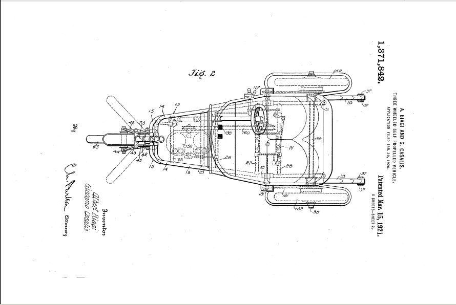

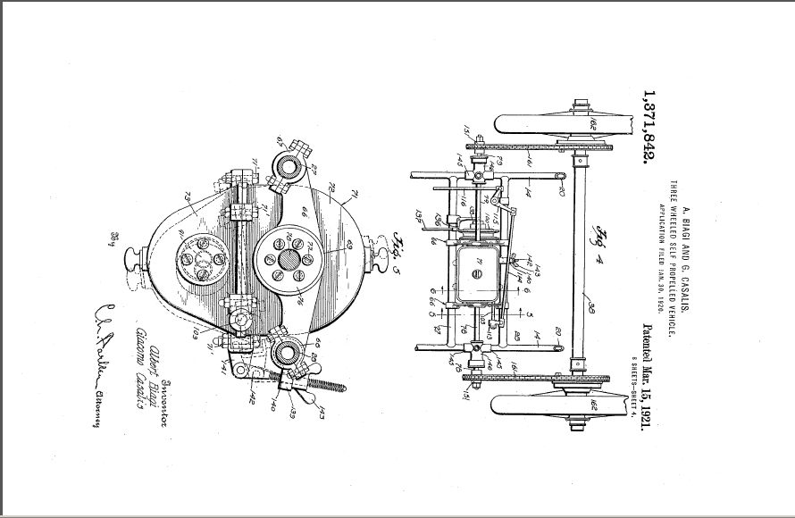

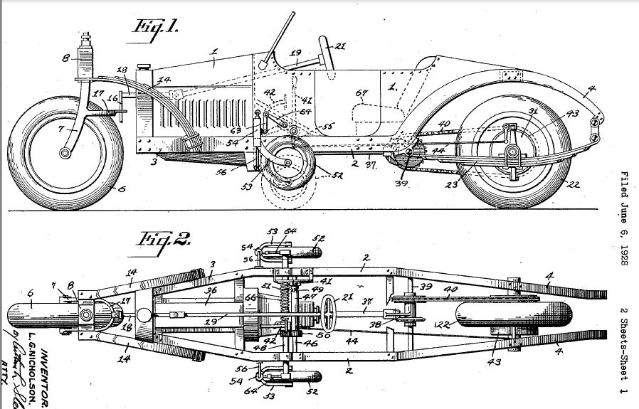

    Patent searches can be fun :)
