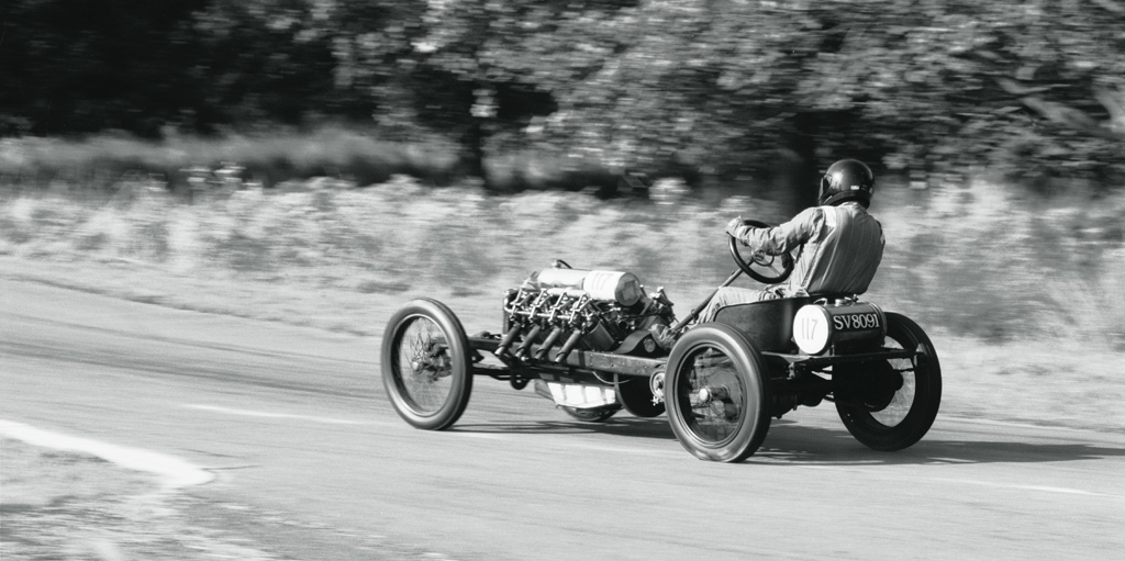

    After all this time... I just have to know... what the heck are those vertical blades extending from the front of so many of these cars? Bumper subs***utes? Tag holders? Curb feelers? Varmit slicers? Gary
  4. noboD
    Joined: Jan 29, 2004
    Posts: 9,050
    noboD
    Gary, I asked that same question a ways back. Someone said it is to trip the timer for timed events.

    Yep,that's the equalizer.Not the front tires ,but the flag out front.

    The sticky out the front things, they are timing struts , they are there to break the timing beam at the start and finish of hill climbs and sprint events ,
    They always seem to be the last bit to be made on a car and the most often forgotten parts when packing for an event , so it's not uncommon to see them lashed up from items begged borrowed or stolen from around the paddock, I did see one made from a wooden s**** and card ,

    A timing trigger. Nice to finally know.. you guys are just too clever for your own good. Gary
