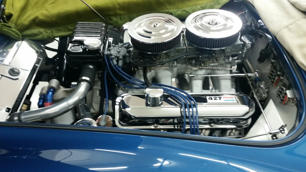

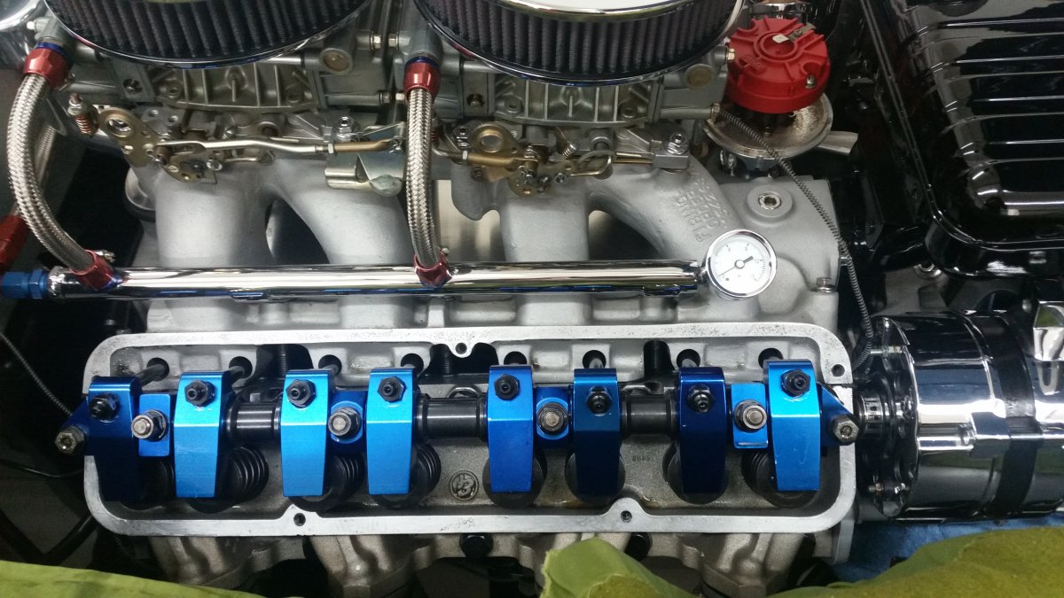

    I like the edelbrock heads. I'm using a tunnel wedge intage with dual holly 600cfm carbs. Stock fuel log modified for fuel to enter from the firewall end.

    Are you using a Ford tunnel-wedge, or the Dove? BBM has one on the drawing board, but progress seems to be at a standstill...
    No self-respecting FE guy will use the Edelbrock. If you cant afford a proper 2x4, use a Streetmaster or Holley Street Dominator with a port match and the ears ground out of the plenum. Either one will just flat out bury any of the cast iron 4bbl intakes...

    I'm using a dove. The Ford intakes are almost impossible to find. I was lucky to find a good dove that needed just a little machine work, everyone into fe's knows doves past and problems. Yea only hollys belong on top of an fe motor. I like edelbrock products just not the carbs.
