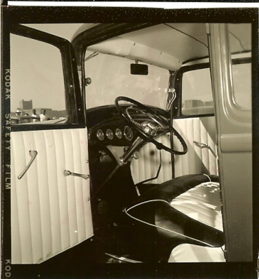

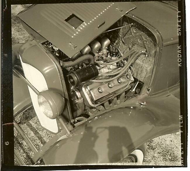

  8. My vote's for the cross-steer setup.
    The pics below - courtesy of KiwiKevin - are of a five window from back in the day.
    I understand he used a 56 Ford pickup steering box although the car came into town in 1955 running an Olds Rocket.
    It spent some time getting the Desoto engine, but that was probably done within a six month period - if that.
    So it's conceivable the column is an F1 and a 56 pickup wheel added later.
    Even so, the interior shows the column angle.
    I sat in the car once and everything felt about right.
    If the drag link has to angle back a bit, that shouldn't be a problem.
    We all try to get draglinks in cross-steering setups parallel with the tie rod, but if it's required to bring the drivers side end back to match up with the pitman, no big deal.
  9. I meant to add this last pic.
    Hope it's a help.
