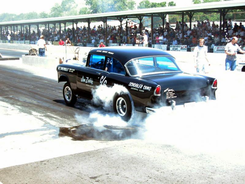

    I have used film tint on lexan with no issues, just that the lexan has to be free of scratches and nicks, thats what gives you bubbles. Chuck, if you remember my black 55 with blue windows, that what I used on it.
