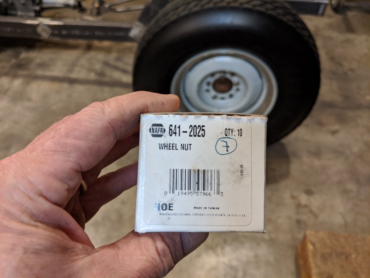

  3. You can tell by the part number that they are Dorman.
    Paul likes this.
  4. squirrel
    Joined: Sep 23, 2004
    Posts: 60,985
    squirrel
    dorman number for those nuts is 611-026. How do you tell that 641-2025 a dorman part? Just curious.
    JNKYARDDOG_1 and Paul like this.
  5. Well at least in Canada.... many dorman parts cross into Napa numbers. Always three digits, a dash and four digits. Here Napa puts their own number and logo on them.

  7. keith27T
    Joined: Jul 10, 2012
    Posts: 592
    keith27T
  8. Dorman Nuts start 611- and studs start 610-
    Went to Dorman site and....
