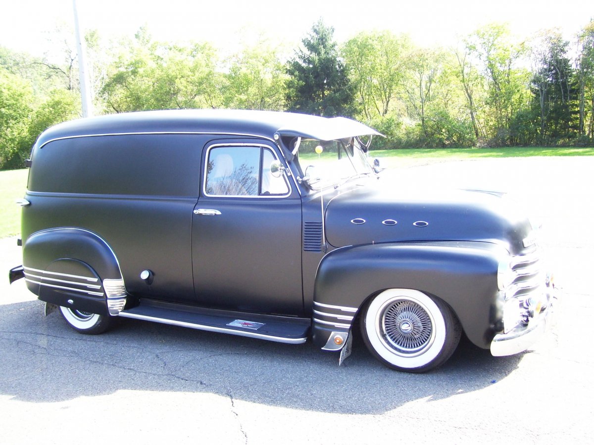

  17. keith27T
    Joined: Jul 10, 2012
    Posts: 592
    keith27T
    Yes the dorman 611-015 is the right one for this application. Napa has them.
    Picked up 1 to check out and it fits. So tomorrow I am going to get the other 9 they have. 2 short, but will ask if he can get more in. $1.76 each Canadian.....Thanks again. Lordco here is special order.
