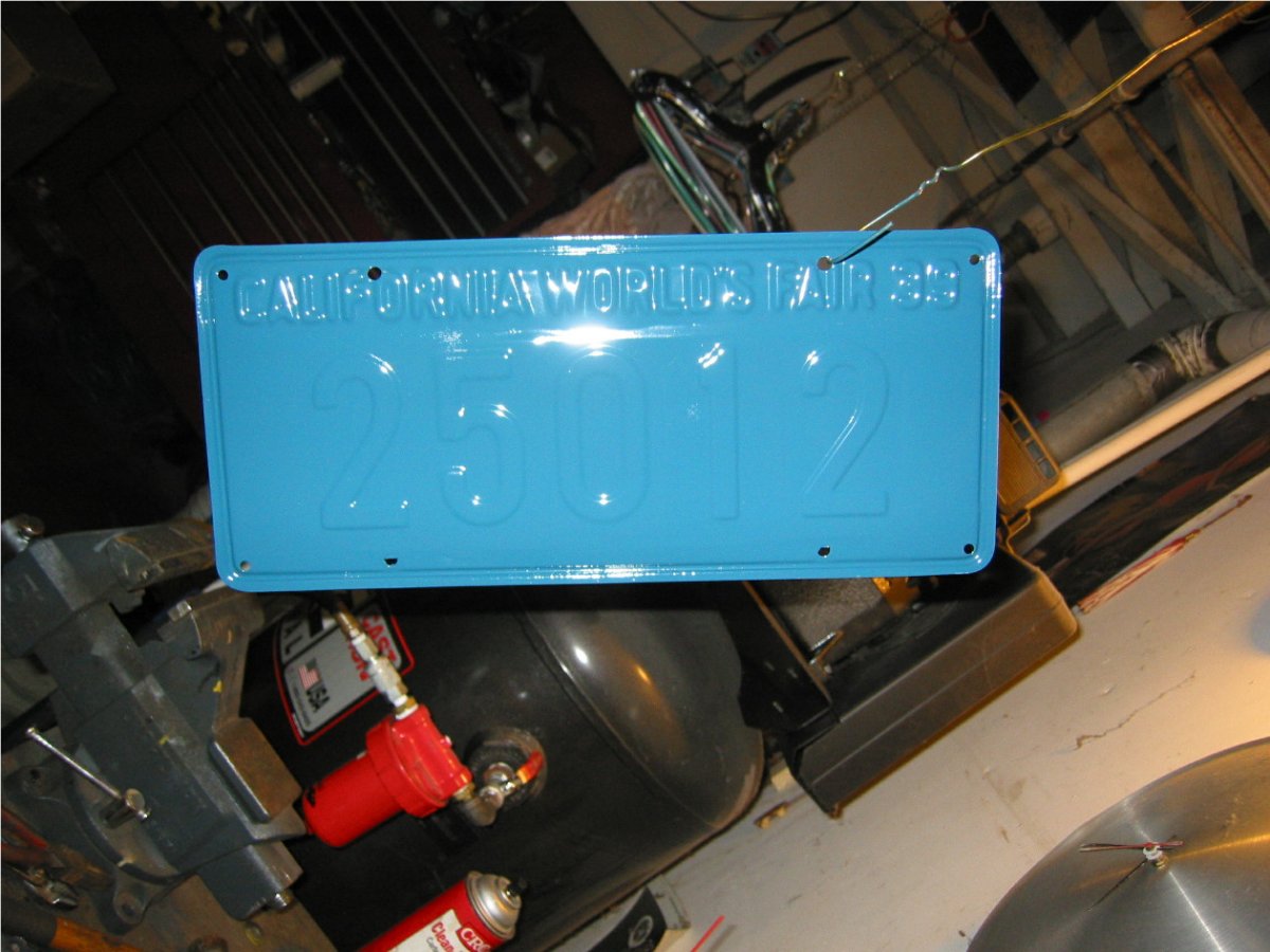

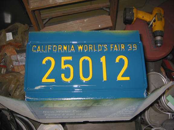

  12. El porto, those look really straight and you could re paint them yourself if you wanted too. Do a search on here for posts, there's a few different ways of doing it. Mine is to clean up (blast), light prime, med (few layers) letter paint color whole front of plate, light background color whole plate (front and back), color sand to get letters/numbers to correct color and then clear coat. Use good automotive paint.
    My house numbers in spray can:
  13. Nice job. Were contemplating the DIY suggestion. Thanks
