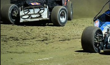

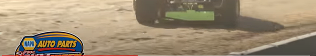

  1. I am always confused by this statement, racecars don't have to deal with the same physicals as street cars, racecars don't have to deal with rough surfaces or are street cars somehow superior in handling than racecars?
    How so have you ever been to a weekly short track particularly a dirt track?
    They are anything but smooth, in fact they are incredibly rough, my home at my home track Fonda the cars enter turn 3 at over 90 M.P.H
    Somehow bias plys can handle this on a race track by not on the street?
  2. gimpyshotrods
    Joined: May 20, 2009
    Posts: 24,631
    gimpyshotrods
    Lateral forces on dirt, versus lateral forces on concrete or asphalt do not well-compare.
    One weekly short track event on dirt is shorter than my trip to go buy supplies across The Bay, and yes, traffic is going over 90 in places.
    Alos, while a dirt track may develop ruts and holes, they are unlikely to have rock hard edges, or have rebar at the bottom.
    I-680, Fremont California.
    My 3-mile commute to the shop includes a 2-inch recessed manhole cover, where you hit the outer ring if you do not swerve, and a pair 2-1/2 inch truck tire worn concrete culvert deck edges to avoid.
    If those appeared on a track, they would suspend racing.
    This is why comparing a well cared for hard surface track, or a dirt track, to a public road is not a useful comparison. The hazards simply do not match.
