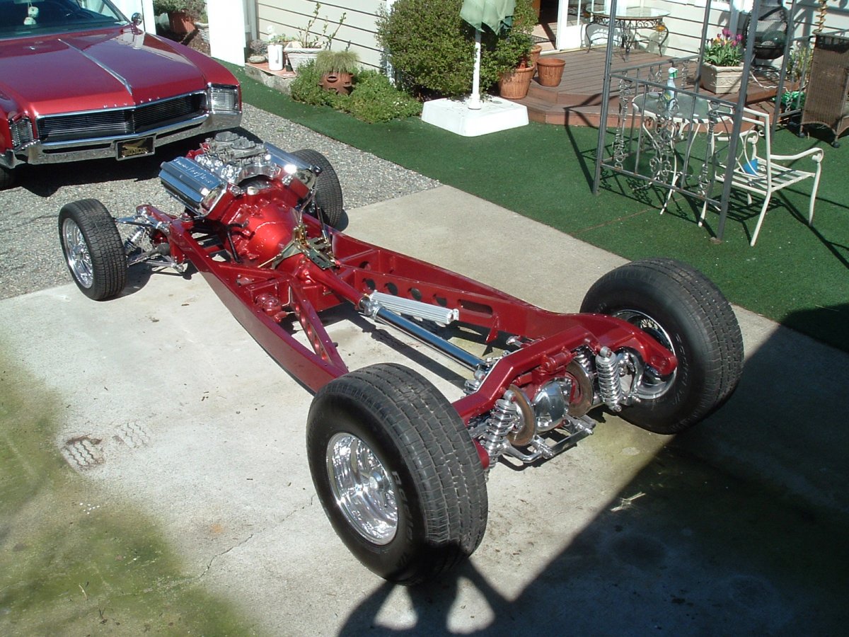

    My ride is out of commission for the foreseeable future. This pisses me off, leaves me deeply disappointed and leaves me bummed beyond words.
    Yesterday the Torque Flight gave up the ghost (almost). 34 still moves, and shifts but it was smoking, and first and 2nd are slow to accelerate from a standing start, 3rd and reverse are ok.
    Because I wasn't thinking right when rebuilding the fame, I welded in the tail trans mount
    instead of building a bolt in and so that means engine AND ****** have to come out together. (I'd post a pic, but the car isn't HAMB friendly.) As I have said, I'm now 80 and the aches & pains and deteriorating health of an old man may well play a huge part in getting this accomplished. I'll do my best to be certain, and hope I can get-er done. The task before me means crawling under to take out the drive shaft, removing the tail shaft bolts from the ******, unbolting the seats and removing them, taking out the carpet to get to the trsnny cover to unbolt the the Lokar shift linkage, unbolt the motor mounts, unbolt the exhaust at the headers, unhook all motor wiring, taking off the new carbs, removing the radiator and grill, and anything else I've missed here. Then there is the hooking on to the thing and trying to pull it out. Then unbolt the trans from the engine, take it to the trans shop for repair, fork out who knows how much $$$$$$$$, bring it back and reinstall all I went through above. I'm sure I missed something above but who knows?
    I'll maybe post the progress (if allowed to do so by the moderators) along the way, but It won't be very soon. Just to discussed with life right now, and I have to clear my garage up some by selling my recently deceased middle daughters 97 mustang I was going to do next) So that's my crybabies story for today and don't think I'll be involved here so much for some time to come. DAMN IT, I REALLY WANTED TO DO THE GOODGUYS NEXT MONTH.

    Going to post a photo of this non HAMB friendly frame just to clear up what I'm speaking of. Again this is not intended to violate the rules, I understand with the IRS/IFS it is not considered to be "traditional", and I run the risk of this post being deleted. Picture 224.jpg Kinda hard to see the crossmember, about mid way on the tail shaft. It is right up against the floor.
    DAMN IT LAR, DO IT RIGHT NEXT TIME
    (My apologizes HAMB moderators, I mean no validation malice.)

    After seeing the pic of your frame I can see why you don't want just anybody hacking on it.
