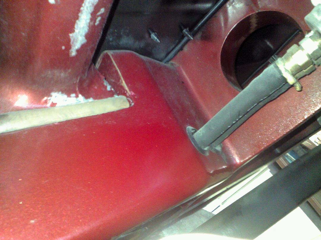

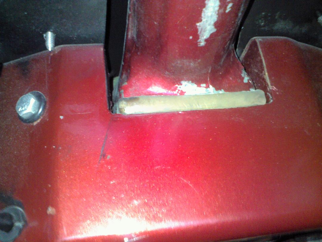

    Here is the first installment of what I hope will be "the fix" I believe I can do this with a lot less work and hassle than what I posted in the OP.
    This then is the cross member as it is today. It will be a week or so before I "get "into it as we are headed out on a 5 day vacation trip. Wife needs time away and so do I. (Unbelievable family issues with the damned great-grand kids)
    So what you see here is the cross member I built and installed originally and welded in place. Right now I'm planning on just cutting the space under the tail shaft out. Unbolting from the engine and dropping it down after dealing with the shift linkage. I'll keep the piece I cut out and reinstall it using 5/16 X 1-1/4 (maybe wider), flat bar and bolting it across the bottom of the and stubs from the fame for correct height and then reinstalling the removed section piece and using 5/16 x 1-1/2 FB and bolts through the re-installed member piece and the stubs in the vertical cuts made when I took it out. I'll drill it all before cutting it out so I'm able to position it as close as possible to its original position.
    I'll cut vertical cuts from bottom up common to the "pocket" save that piece and reinstall it using FB and bolts so that the future guy(s), won't have the same issue as the original idiot fabricator created.
    I'll keep this updated as I work it, but that's the plan for the present. I'll also include what left and right of this fix. The left side with the fitting showing is the fuel line and the right side are the transmission cooling lines. That is 5/16 wall tubing and I'm a retired from the iron trades, and Boeing manufacturing Engineer and with my knowledge I'll be using the correct size of bolts and materials i believe. The plaguing issue is this old man human body and laying on the cement and how long I can endure doing so. (Might get under there and have to call the fire dept boys to come help me to my feet. :):eek::rolleyes:o_O
    So I'm open to suggestions from any one with better ideas, but I do not want to get into any welding of any kind.
    Left side with fuel fittings for necessary routing to the engine and battery cable from the trunk. r hand.jpg
    Right side with transmission cooling lines.

    Larry I just found this thread and read it all. What you showed us is a beautiful piece of art, and I agree totally with your reluctance to let "just anybody" touch it with a wrench, much less a Sawzall!:eek:
    And I certainly understand the effort and potentially painful effort it's gonna be to do the job. I'm a little closer to 82 than 81 myself and don't enjoy working on a creeper either! I'm facing a somewhat similar job, except I hope I don't have to do any cutting and refabbing, replacing the clutch in my "A" Hiboy roadster with a McLeod dual disc in order to reduce pedal pressure required to drive it. It's either that or go to an automatic transmission sooner or later.:confused:
    An idea is running thru my head is to take advantage of having built the car myself and the same applies to you. We both know pretty well what wrench sizes/types we need already. I'm going to put all the wrenches, sockets, and etc. on a shallow drip pan I have and place it where it won't be in the way of my work, but close enough that I can roll the creeper over and get what I need. That way no struggling to get up and down from that damn creeper, which is a struggle more than working while on it!
    A good friend has offered the use of his shop and a lift, but I'd like to do it in my shop so as not to feel obligated to hurry and get thru with the job to free up his lift and shop. Don't plan on doing this till after good roadster driving weather is over and Winter arrives and when topless roadsters ain't too much fun. So I'll have time to work at my own pace and not feel guilty if I don't get on it real fast.

    One of the best Mopar trans men in the country used to be over here in Grandview but I don't think he has worked on them for years. He is around 80 too though.
    It's kin of a danged if I do, danged if I don't on cutting that trans crossmember out. You can probably cut it right next to the welds and with a bit of trimming weld flanges on it that bolt to the X member like they were there to begin with. Lots of work if you have to lay under the car and do it though.
    On the other hand, I was just wondering if you can even snake the engine and trans out of the chassis with the body on it. That looks like it is going to be a pretty tight fit.

    48 see , my post above on how I plan on getting trans out.
