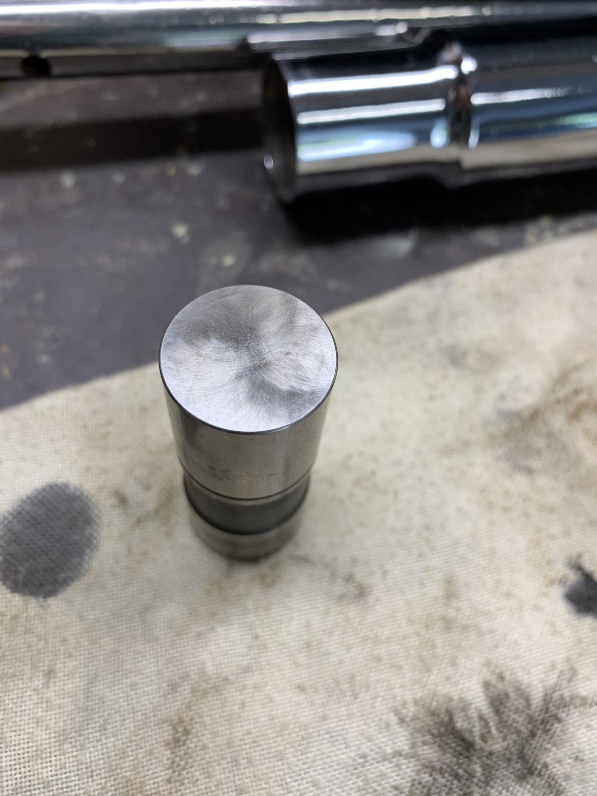

    I picked up a so called rebuilt 327 about 4 years ago pretty cheap. The guy said it was rebuilt about 5 years before. I think it was much more than that. It was one of a pair he got with a boat. The boat was determined not salvageable. The engine was much later than the boat so I think they replaced the short blocks. I just tore into it check it out. The heads (1.72 intakes nothing special) look to be rebuilt. I have a set of Edelbrock heads that’ll go on. I found the engine is bored .060 over and has a slight ridge on several cylinders so not recently rebuilt. I’ll check the bearing clearances. Has a new double roller timing chain. The lifters don’t seam to have wear, do these look new? Do new lifters have slight across the whole face? IMG_3670.jpeg

    Lifters are ground on something like a 60” radius, they will be convex. You can check them by putting two together or using a good straight edge, and be sure to keep them on the lobe you removed them from.

    The lifters look new to me:cool:

    yeah, definitely a new lifter....
