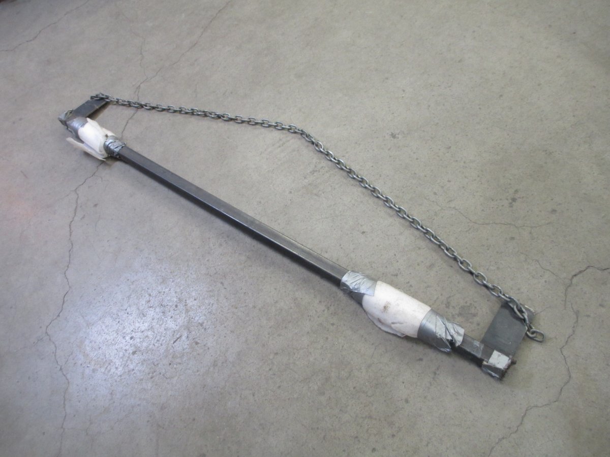

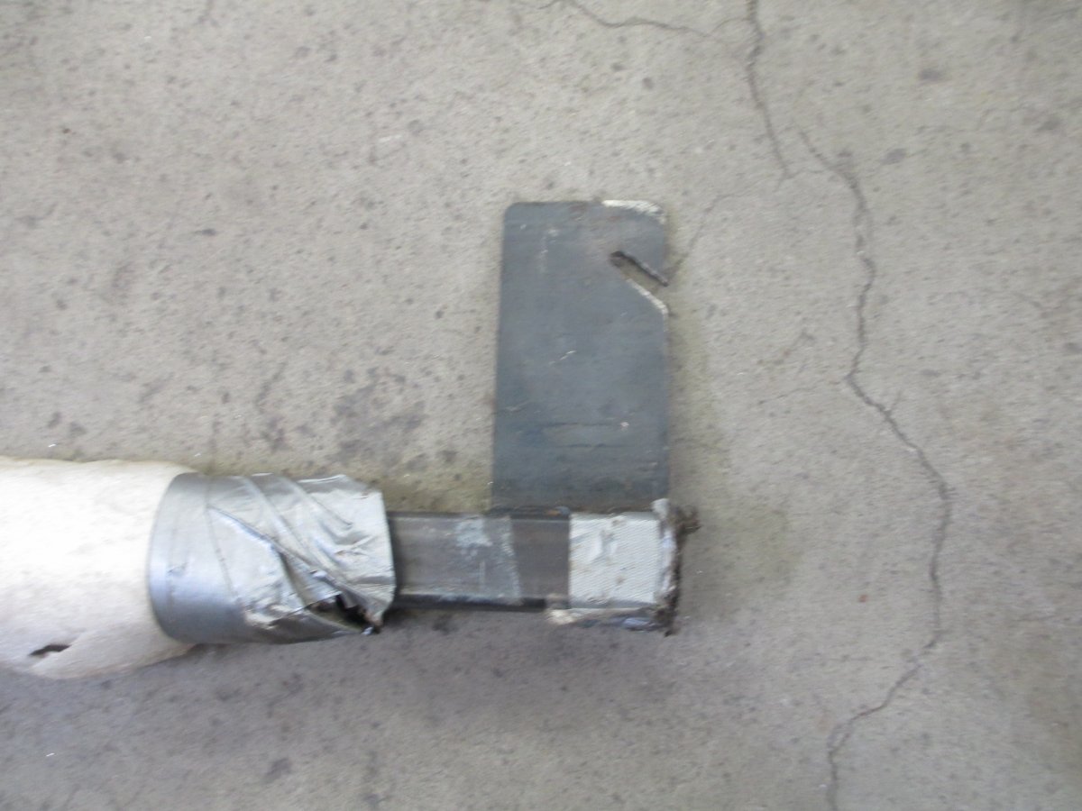

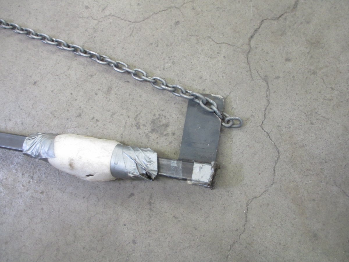

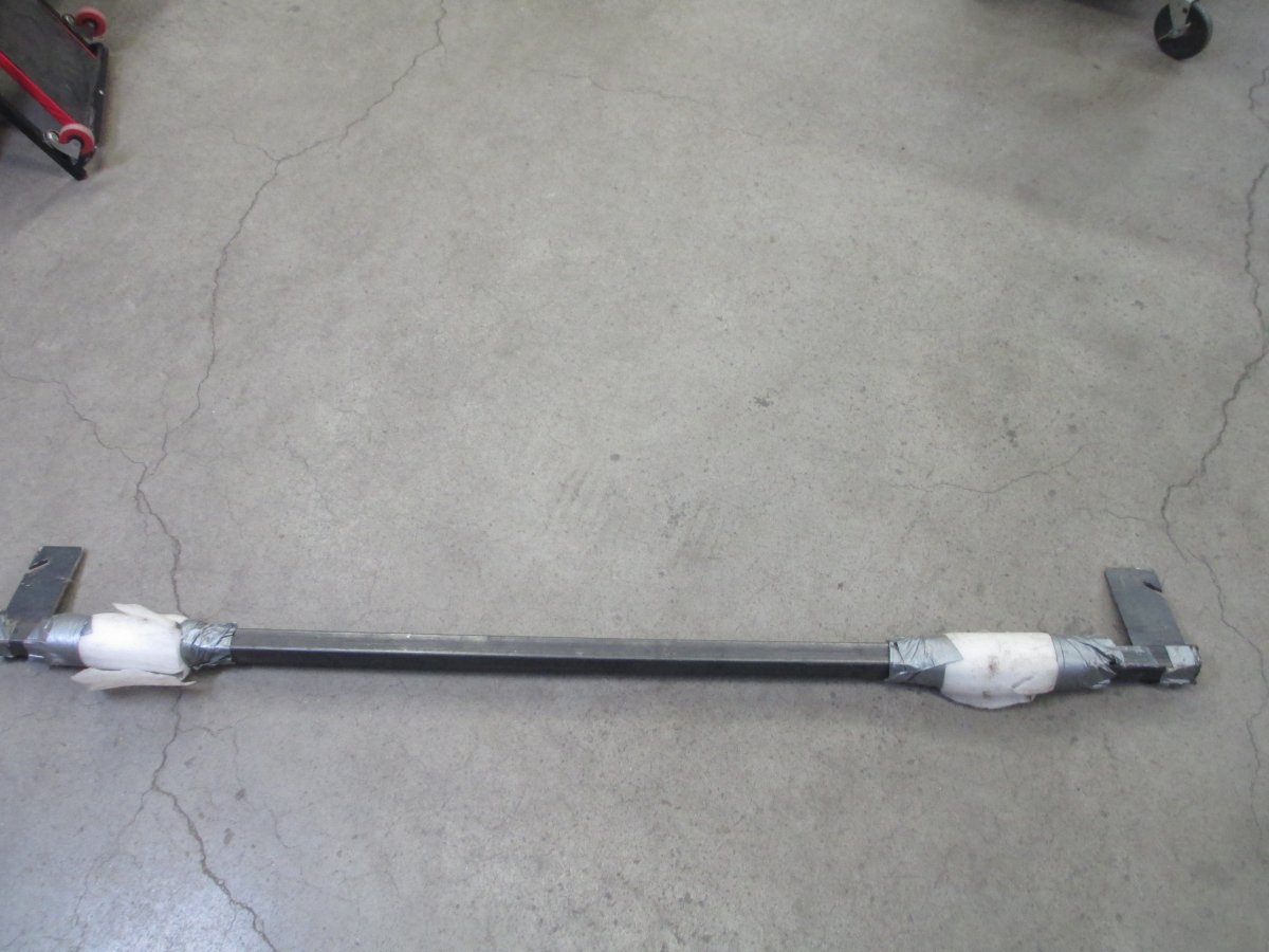

    This simple spreader bar is what I have been using for 35 years, safe and works every time. IMG_2817.JPG IMG_2818.JPG IMG_2819.JPG IMG_2820.JPG

    The thing I don't like about straps is, the pressure it puts on drip rails, a spreader lifts vertical without drawing the body together, especially ones with an opening in the roof.

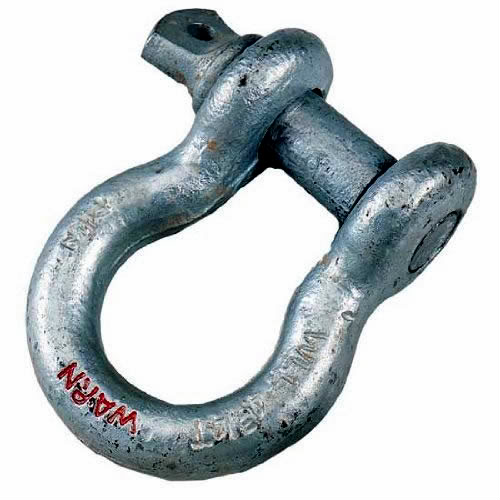

  23. Quite useful when rigging with straps
    Round pin goes in hook and the strap loops go in the ring.
    olscrounger and Hnstray like this.
