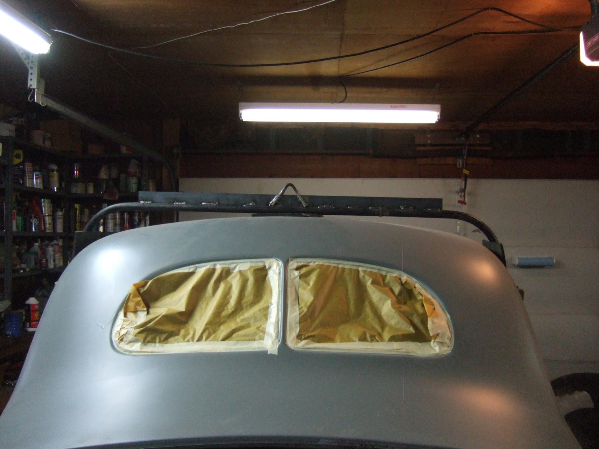

    This is what I use...

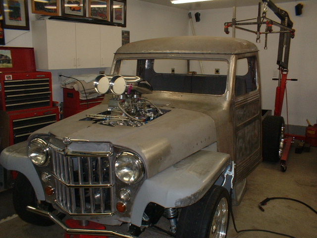

    Here's my contraption; I don't have much room to lift so this is about as short coupled as I could get

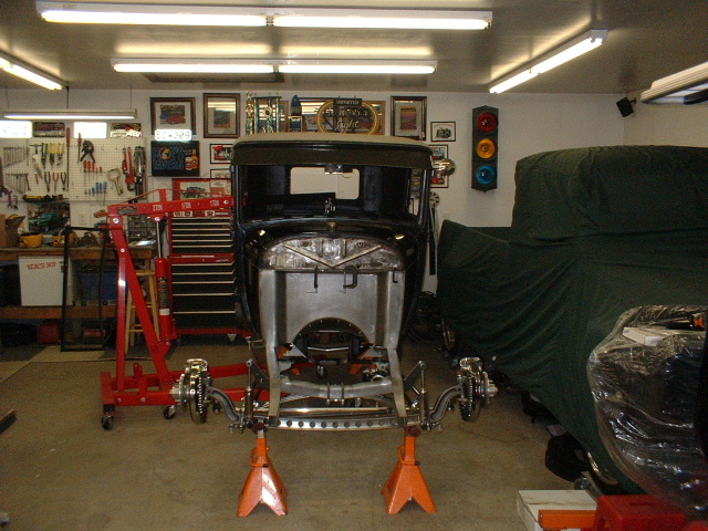

    I lifted the cab of my 48 Chevy PU off and on the frame lots of times by myself using an engine hoist (cherry picker) and a couple of motor cycle straps. Had the doors off. Stuck the engine hoist into the middle of the cab, one strap under the floor through the door openings at the A piller and one at the B piller. Cranked it up and rolled the frame out from underneath. Worked great.
