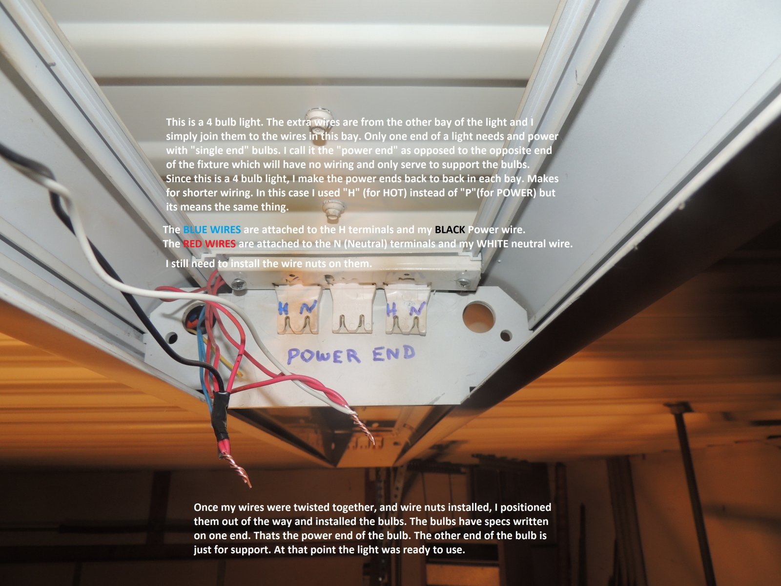

    Moving along.........There are multiple types of LED bulbs out there. The nice thing is that if anyone has existing light fixtures or can pick up old lights cheaply.......then converting them is really really simple. I'm using bulbs that are designated TYPE "B" SINGLE END . What that means is that the power for them is only applied to ONE END of the bulb. The other end has two prongs but only hold the end of the bulb in place. Its basically just like plugging in an electric cord in your wall.
    You get rid of the old bulbs and remove the ballast.
    If you have a 4' light, you simply run the three wires in one end. Hook one wire to the fixture for ground. One wire to the right side of the "tombstone" and one wire to the left side of the tombstone. Put the LED lights in and turn it on.
    What I did (for consistancy) was designate the left side of the tombstones as black wire and the right side of the tombstone for the white wire. You will have two tombstones on each end of the light. Each tombstone will have a left and a right contact with a wire attached. The wires can be any color (red/blue/yellow). It doesn't matter.Cut them off about 10" long and strip the ends. Use a continuity test light and see which 2 wires are for the left contact. Twist them together along with your black incoming wire. The other two wires will twist together and be joined with your white (neutral) wire.
    Then install the bulb and turn it on. No more ballasts to worry about, more actual light, lower electrical use. I'm telling you it really brightens your work area.:)

  4. 73RR

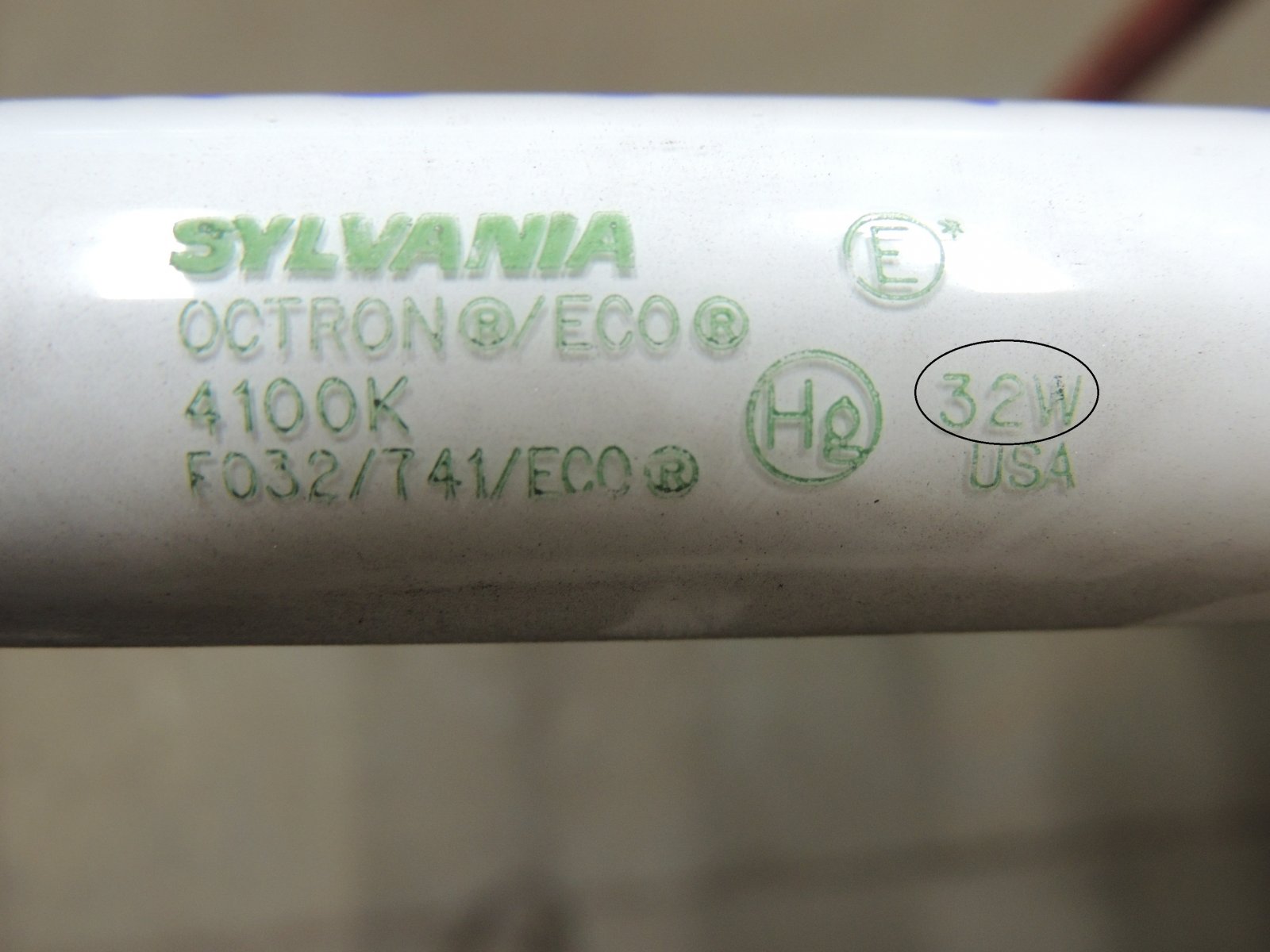

    How much power does it say they use? How many lumens do they say they put out?
    I think the flourescents are rated without the ballast. Just like modern HID lights for cars are rated jsut for the lamp, 35W lamp but total consumption about 42W with the ballast.
    Yup, that heat costs power.
    Old lights lose efficiency. The old flourescent lights are less bright than new ones long before they die, and LED lights are said to have reached the end of their life when they just give 50% of the original light - so while the difference may be big when going from old flourescent to new LED, the long term difference isn't quite that good.
    ***uming they actually use half the power, the math checks out.

    Here are some pictures of how simple the wiring was for me. Also some pics of the bulbs and ballast from old Flourescent and new LED. 32W for the old bulbs and 18W for the new LEDs. The Ballast basically says 1 amp (.98). I don't think the flourescent lights produced anywhere near the same Lumens (brightness) of the LED which says 2200. Didn't see anything on the Flourscent bulbs.
    So here are some pictures.

    Some google work and we find this, the highlighted line is the one in your picture.
    2800 lumens new, 2520 after 8000h. So, actually a bit brighter than the 2200 lumen leds. But add some dust on the old ones in a barn and the situation may change.
    Another thing is the color temperature of the light, the flourescent is at 4100 kelvin, the led at 6000K. Higher means whiter, with a hint of blue, low is the red-yellow spectrum. High color temperature tends to fool people into thinking it is brighter than it actually is.
