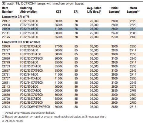

    Depends on the era they were made. Only old ballasts had PCB's in them, so all newer non electronic ballasts have "No PCB's" written on the label. And all electronic are OK to toss away.
    When I looked at the prices on retrofit LED lamps it was double the price of a whole new 4 ft. strip light. So I tossed all my old fixtures in the s**** bin.

    Good Info G-son !:) While I agree that the light is a different color (more white than yellowish), I have to say that its literally "nite to day" difference in how easy it is to see things now. Kinda like going from one of the older style greenish view welding helmets to the newer clear view ones. I have to say that I really do like the new lights much better than the old ones whether its fooling my eyes or not. :)

    I run 16 4 to 6 bulb T8 LED fixtures, one single T8 LED fixture over my primary workbench, to take away the shadows, and three panel lights, to get rid of a few more shadows
    Mine are 4,000K in color temperature, and came frome Primelights.
    It is as bright as daylight, even at night, and there are almost no shadows, anywhere.
