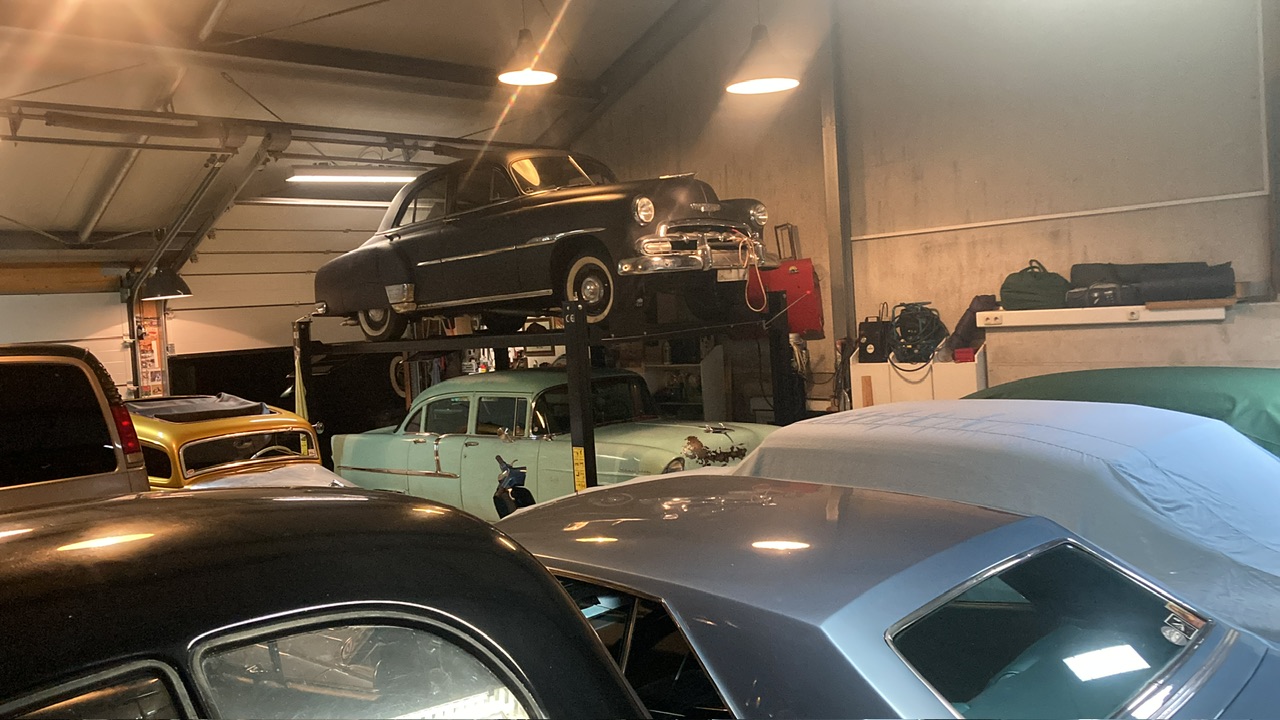

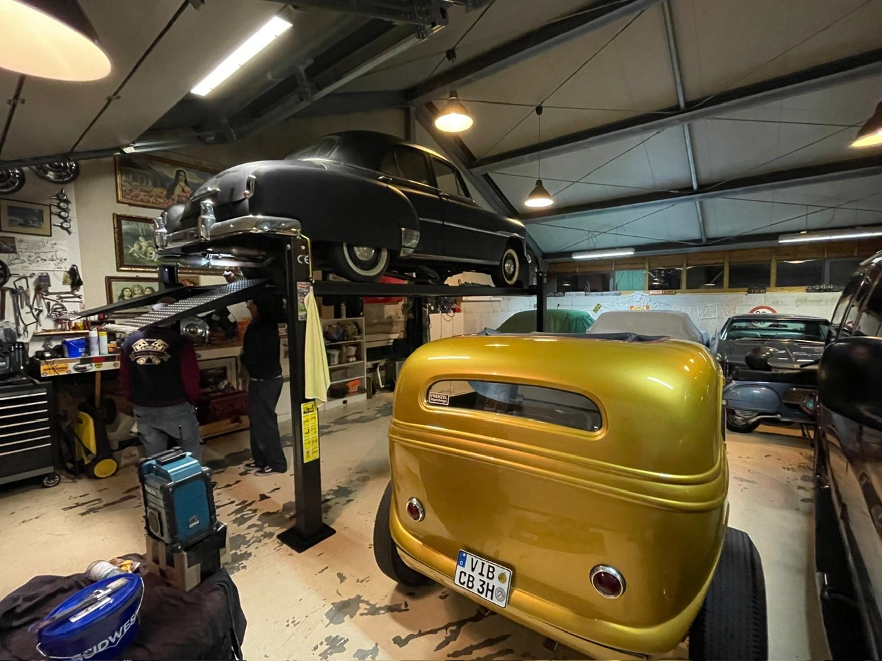

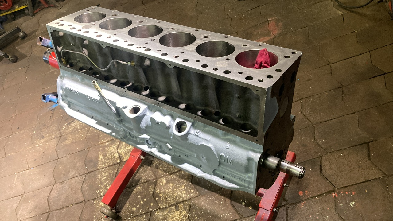

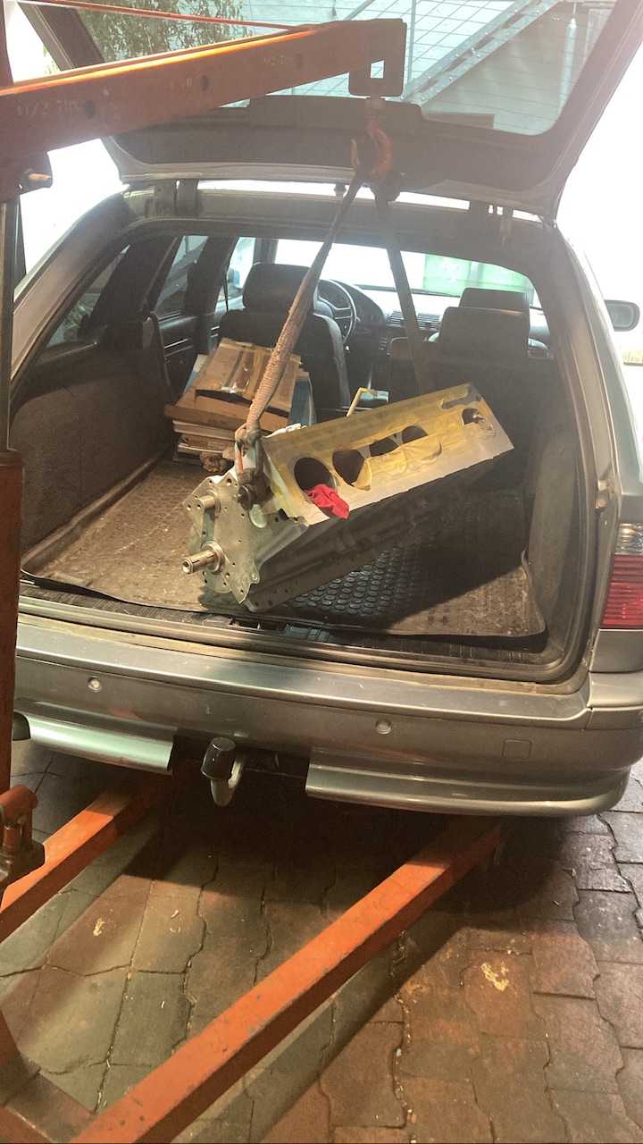

    When we arrived back home Saturday night, of course the first task was to put in the lift and check out the car.
    Of course the 52 is not a show piece by any stretch, the falt black paint is shot , it peels off in various places, but it seems the just painted of the old and worn thin og paint and flat balck didn´t adhere well.The engine is out of the car,the body has a few bondo spots and looks to have been hit once or trice, but floors and rockers are solid, it still has the original floors which are solid aswell, chrome is pretty nice, interior is all there and looks like it´s been done sometime ago.

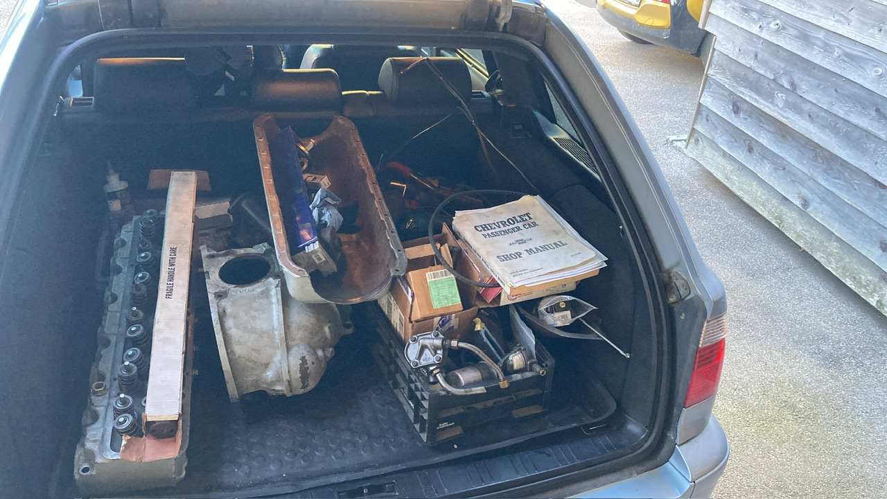

    I spread all the parts out on the floor and it seems like everything I need is there, some things double and triple. 6 engine gasket set, 2 timing gear sets, 2 new camshafts and lifters, 2 main bearing sets and 4 rod bearing sets... the block is 80 over and the old .060 pistons look almost brandnew aswell. I really wonder why they took the engine apart...maybe bearing damage.
    The head has been cut, converted to nylon valve stem seals, new valve springs and retainers, very nice work from what I can tell so far. The crank is already in the block , but I´m still going to open the mains just to make sure and plastigage them.
    I´m happy as I could be!
    Dani would prefer if it was an auto, but she also drives my 55 235 / 3speed OD car flawlessly, and I just don´t want to open that can of worms at the moment. I love the old stovebolts and I´m not ready to swap the whole drivetrain .
    If you guys have any tricks and things you are willing to share about these 49-54 Chevyies, I ´m new to them and trying to learn as much as I can, please share!
    Thanks for checking in and I´ll promise to do updates !

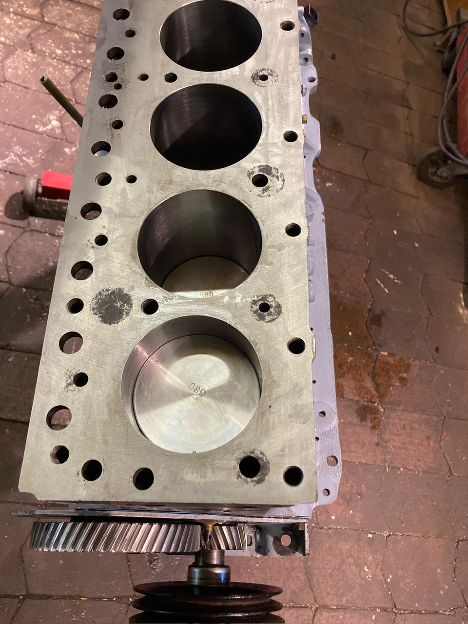

    Tonight I checked the main and rod bearing clearences, which were perfect at .0015". Gapped the rings while I was there and Xaver, our 3 year old, helped torque down everything.

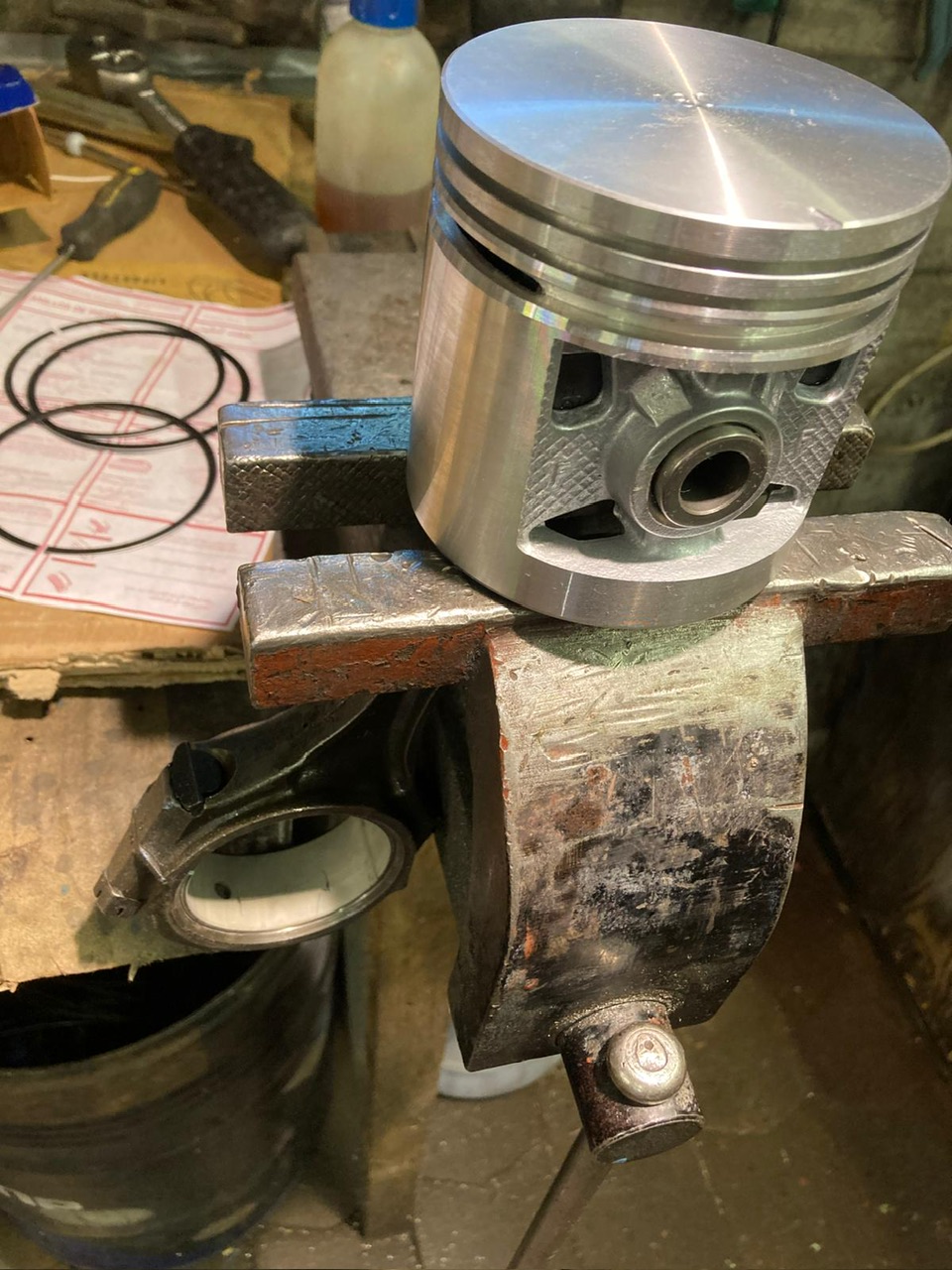

    As for @SS327 ´s photo request... I don´t have one of him torqueing down main caps, but Sunday I took one of him eating ice cream on the trunk of my 55 Chevy and one of him harvesting corn during a walk around our little village.
    (And of course I did not clamp the rod down in the vice, I just set it there to mount the piston rings after measuring the ring gaps.)

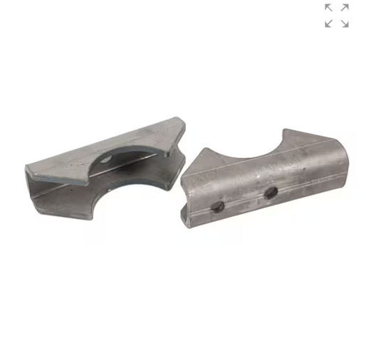

    With any rear axle you were to swap in you would have to buy or look at photos and fabricate the spring seats for the axle. These being for older Torque tube Chevy pickups but will work for 54 and earler cars.
    One would probably have to use (US measurements) 1-1/2 X 3 or 4 rectangular tubing with thick wall and then put a 1/8 spacer on the sides to get 1-3/4. With the offset from center of axle hole to properly locate the axle.
    The only advise I have with the pressure oil 235 is that you need to run and early water pump with the adapter or a 54 water pump for fan to radiator clearance.
    Every V8 swap in those that I have seen has had some cutting done on the firewall to frame supports for clearance that I never liked.
    All those fees for shipping things across the pond including taxes works both ways. I was lookng at some components for the wheels on my OT ride last night and taxes/tariffs would run the tab up a bunch.
    At any rate if you decided to install an open drive rear axle sometthing like this could be fabricated to get the job for far less than you could buy these for when you add up all the cost of buyng and importing them. You will have to cut the old axle seats and any other brackets or ? off any rear axle you put under the 52 anyhow. Finding a proper rear axle with 5 on 4-3/4 bolt pattern in Germany might be a challenge.
