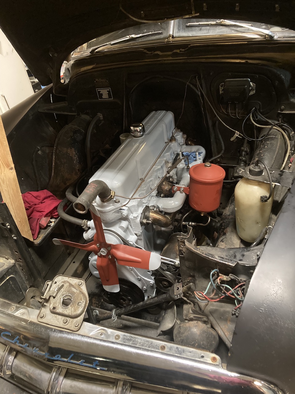

    I pretty much ****oned up the engine after work this week. Today I‘m gonna give it a coat of fresh paint and finish ***embling. The engine had been run without the byp*** oil filter, and with everything being brand new now, I‘d certainly like to add at least the byp*** system. We will see if I can come up with a stock unit or maybe something I can adapt. A bit of filtration would be better than none I guess IMG_0357.jpeg IMG_0358.jpeg B4EF8ABA-70BF-48F3-801B-51439E1E19B6.jpeg IMG_0365.jpeg 1EF5B4F1-4D50-4994-95C7-47AB64B07D9F.jpeg

    164246C1-3D5E-4890-B5F7-0FC2B56118F9.jpeg 4B0D6A2F-130C-450E-8BA3-084386D83DCD.jpeg A3C3CA90-C275-4A38-9300-5EE2506D3BA3.jpeg I don‘t know what an oil spinner is.The byp*** system I have on my 55 Chevy seems to be doing quite a good job . For the last 80k miles or so I‘ve been running 15w40 oil in it, with changes every 4-5000 miles, that´s at about the time I notice that the oil becomes darker on the dipstick.
    I ´ve found an old flathead oil filter canister in my pile of parts, Jay gave it to me when I got his 40 Ford. It was a little gummed up and rusty, but it´s perfect for what I intend to do. I drilled off the flathead mount and made a little bracket that bolts to the manifold. I good cleaning and a little paint make me the fabricator I ain´t. Must be true if it rhymes, hahahaha

    Saturday night I put the engine back in the car, all fit well, it went down like fat kid on a water slide. I finally figured out the motor mounts as you can tell. :D
