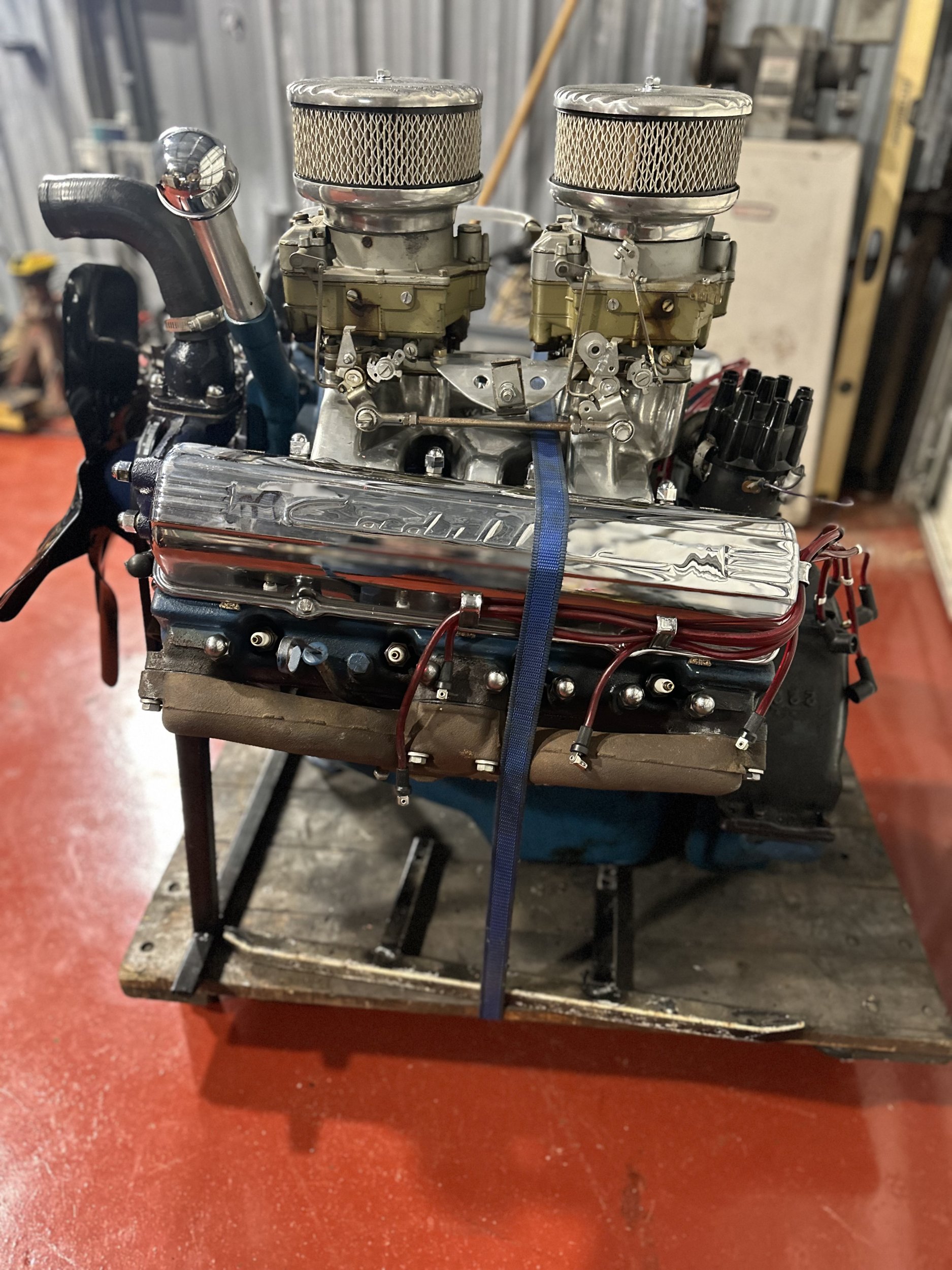

    and this is the Alexander Bros 331

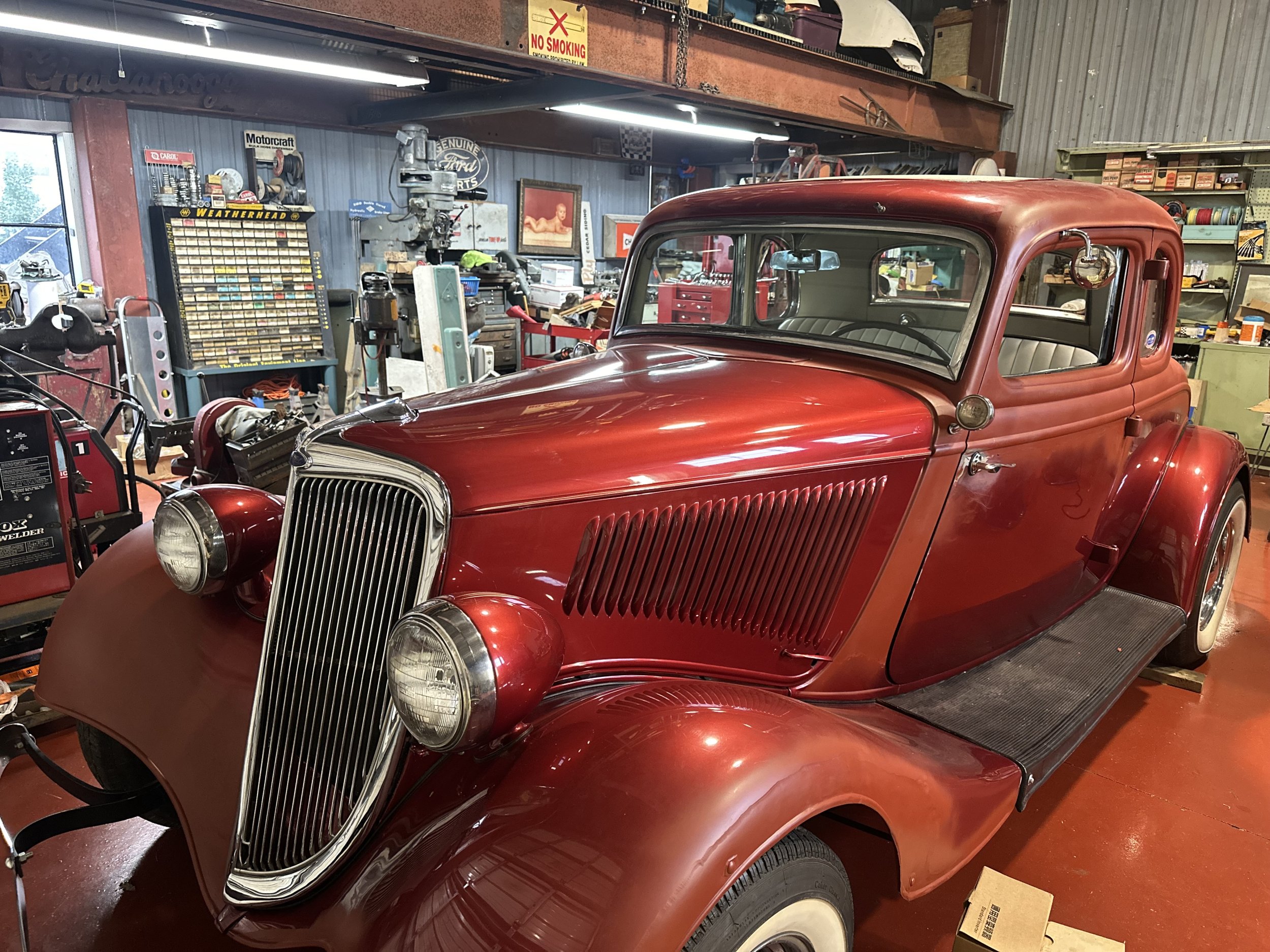

    here’s the new 34

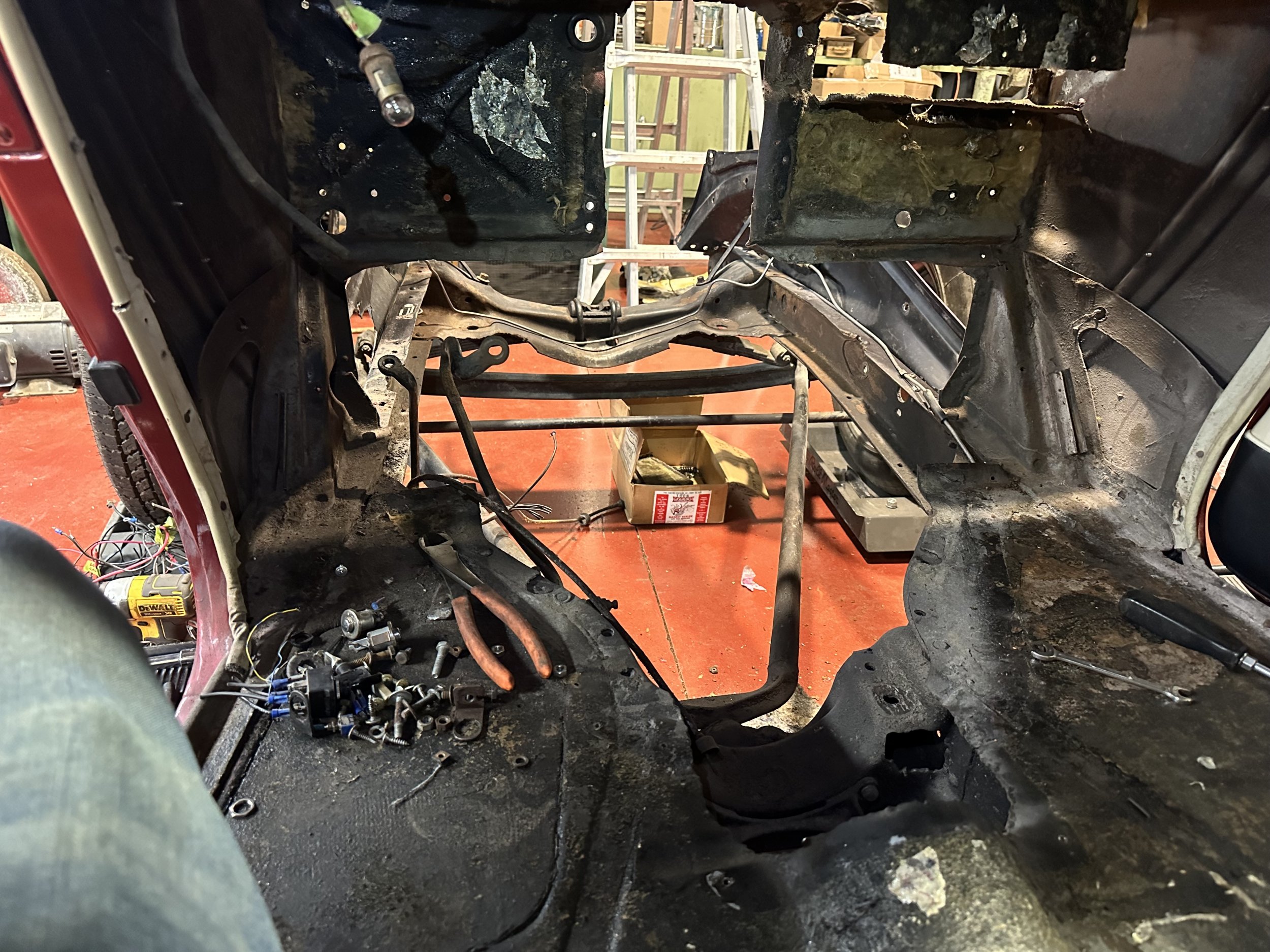

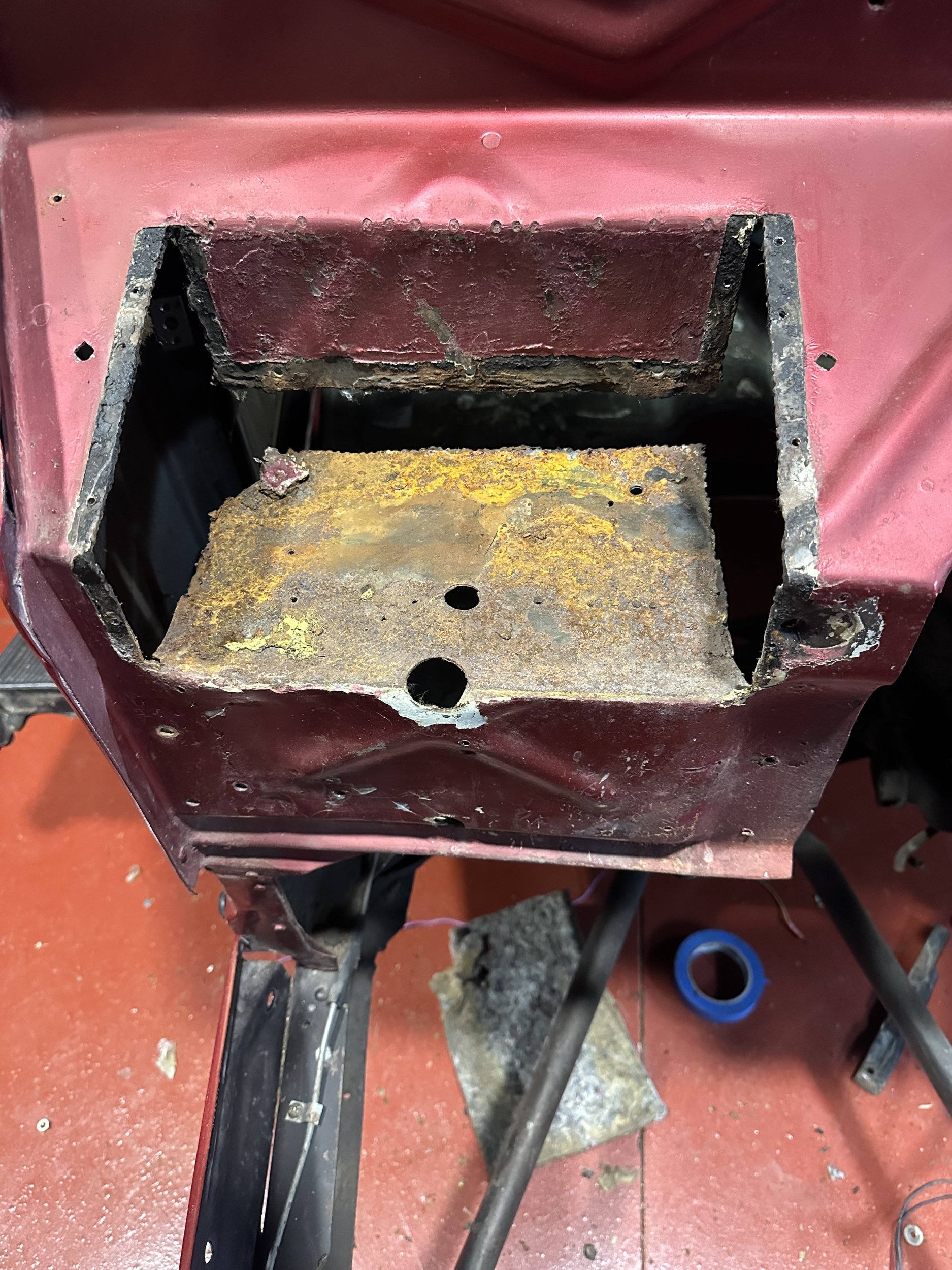

    So I got the seat and carpet out tonight and the good news is there’s no rust!
    the bad news is it’s an old hotrod and has been cut on a bit.
    thankfully I knew that going into it so it wasn’t a big surprise and it’s mostly in the toeboard area and that’s getting reconfigured anyway with the firewall getting set back a bit.
    btw have any of yall noticed that no one that does a post on firewall set backs talks about the toe boards?
    I’m guessing it’s because it’s super easy but all the same I’m excited to get it behind me.
    Gotta work late tomorrow night but hopefully Wednesday I’ll get the firewall cut and drop an engine/trans in there and see how things are gonna fit!
    also check out the panel made to cover the factory hole for the battery. Specifically note the phone number!

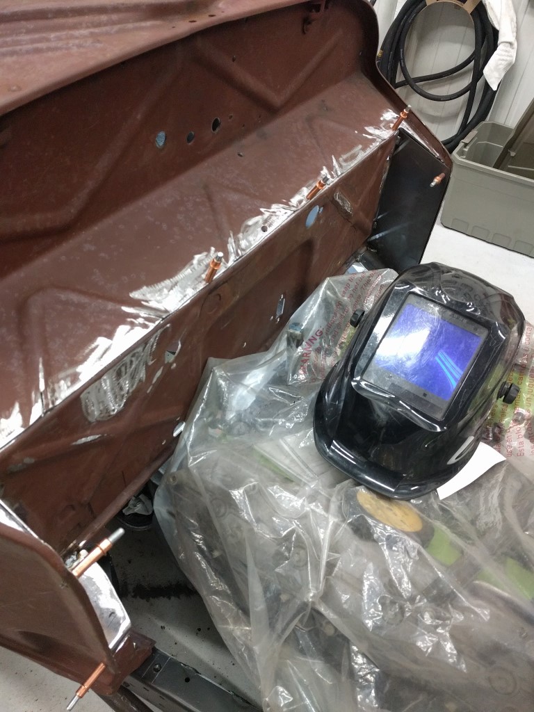

    Probably not applicable to your car; but on the three '33s I did, the angle of the toe boards changed. The new lower firewall sections angled to meet the floors but the angle was not as steep. The one in the picture had a hanging pedal; the others had non stock underfloor pedals I built to fit. Stock style pedals seem like they would require a toe board close to the stock angle to work; but the ***embly would probably have to be moved rearward so the pedals would be behind the firewall. Maybe why Ansen pedals were popular.
    swade41, Sharpone, porkshop and 12 others like this.
  21. hotdamn
    Joined: Aug 25, 2006
    Posts: 2,682
    hotdamn
    that’s what I’m concerned about. I’d really like to keep the stock clutch linkage which requires keeping the stock pedals…
    I also do t want to make this into a science project. I’d like to keep it as simple as possible.
    thanks for the insight and the pics on the inside, that’s helpful

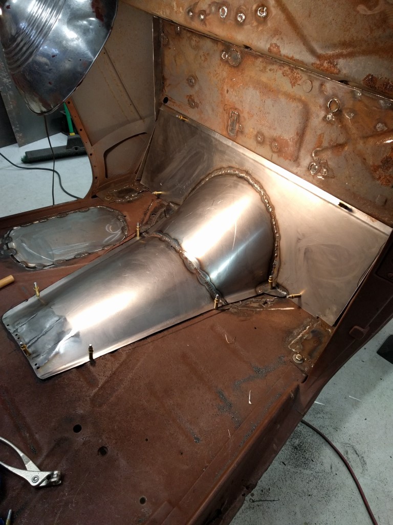

    so anyways, we did shop night at my place this evening and while @sinticket and I wired my compressor up @hotrodderhaag and @Silvair @Crooked road got all the wiring out as well as the CF that was my toeboard!!
    hopefully I’ll have an engine and trans in by the end of this week and things will start to look like something!
    In the mean time check out this gas welded hodgepodge of a trans tunnel and admire the pieces of an old washing machine used on the toeboard!! Also take a gander at how they made the battery box on the firewall, the cut, flattened and folded in the original firewall and then used some thin tin to cover it. Grateful they didn’t just lop it out!! At least I’ve got something to work with…

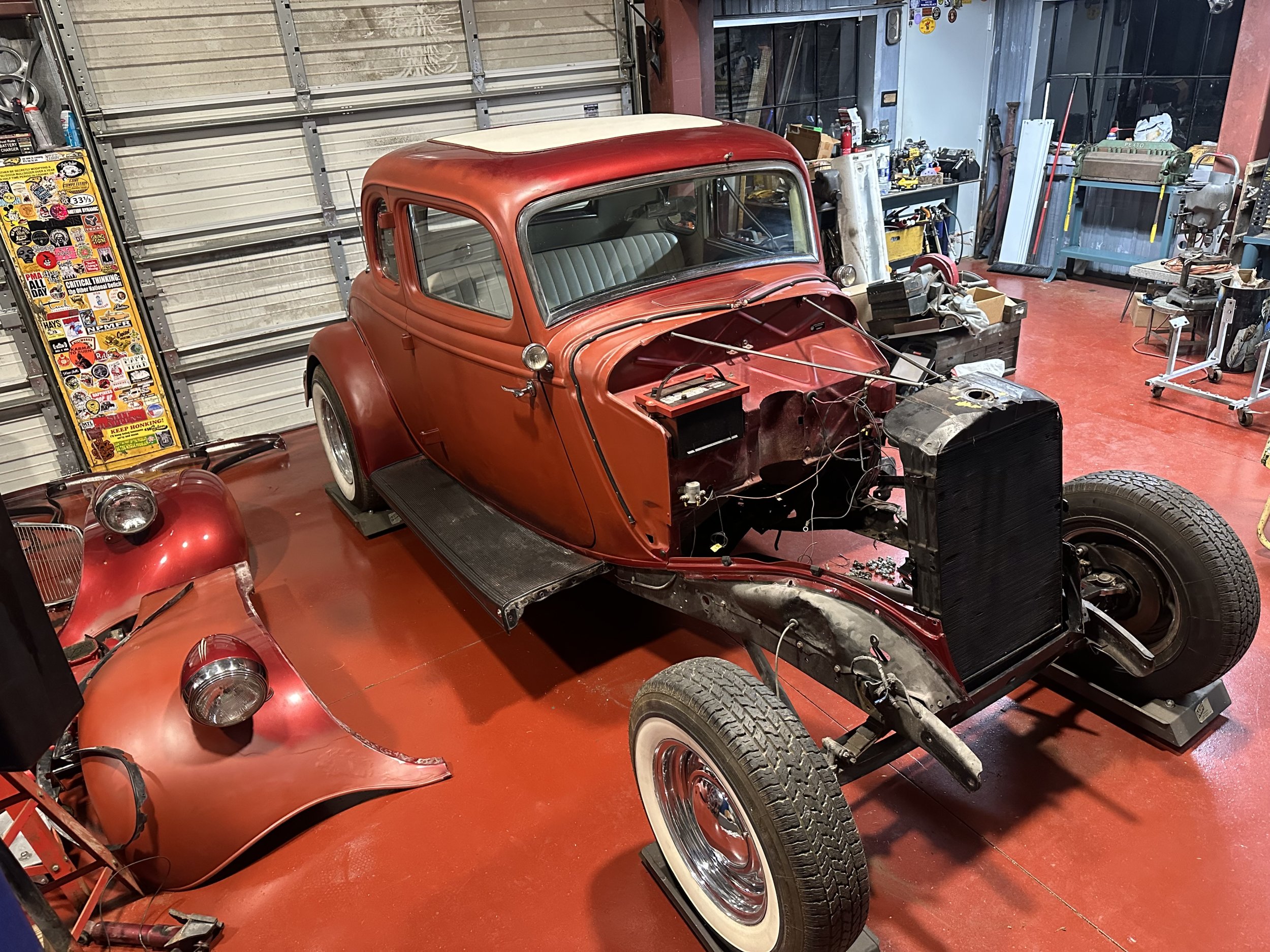

    Made some visual progress tonight!
    after a lot of measuring and anxiety in relationship to my measurements we finally went ahead and cut the firewall and popped the engine and trans in.
    im still not 100% sure im going to be able to use oem clutch linkage but im about 70% sure i can.
    which im happy about because i prefer mechanical linkage when at all possible.
    I will use a set of anson pedals if i have to. But as i said my preference is mechanical.
    the pedals that are in there now were modified to pull a clutch fork back vs push a clevis forward so thankfully I’ve got another set of oem model 40 pedals in stock.
    so I’m gonna swap them out tomorrow in hopes that the linkage jives.
    Also hope to be able to figure out a way to use a set of black widow manifolds. Worried that rear dump is going be fighting for space with the steering box.
    but again, we’ll see.
    excited to get the engine setting in there, now the real fun begins!!!
