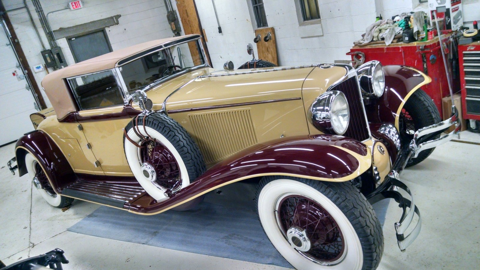

    What ever happened here? Did you get any further with the truck? I was thinking about this when I was matching an odd color on an older restoration, an L-29 Cord. I needed HOK Pagan Gold Kandy Koncentrate to nail the right tone on a tan color from the 70s. Yes, tan. The right front fender was blended at the peak. Made me miss lacquer real bad.
