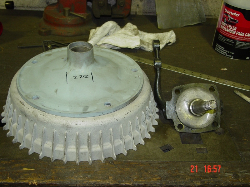

    Wide 5 Allu Drum 2.5'' Shoes 2 600p .jpg Wide 5 Allu Drum 2.5'' Shoes measure 600p .jpg
  7. oj
    Joined: Jul 27, 2008
    Posts: 6,589
    oj
    I'm working that combination out myself. This is the rear, correct? I haven't put everything together as yet but I think you'll need a '58ish buick backing plate to get the depth. The wide5 hub sets things back a bit and when the buick drum is mated to the backside of the hub the package moves back a good bit, I machined a '58 Buick (I have Buick on the front too, one is '56 and the other '58) backing plate to bolt up to a banjo rear. I'm in the process of rebuilding the banjo and haven't done a final fit for the brakes but I believe it'll take a 2 1/2" shoe.
    Here's a pic of the stock Buick backing plate and a machined one for the banjo, you can see how deep it is. DSC07588.JPG
    In looking at the pic, this looks like 1 front and 1 rear.

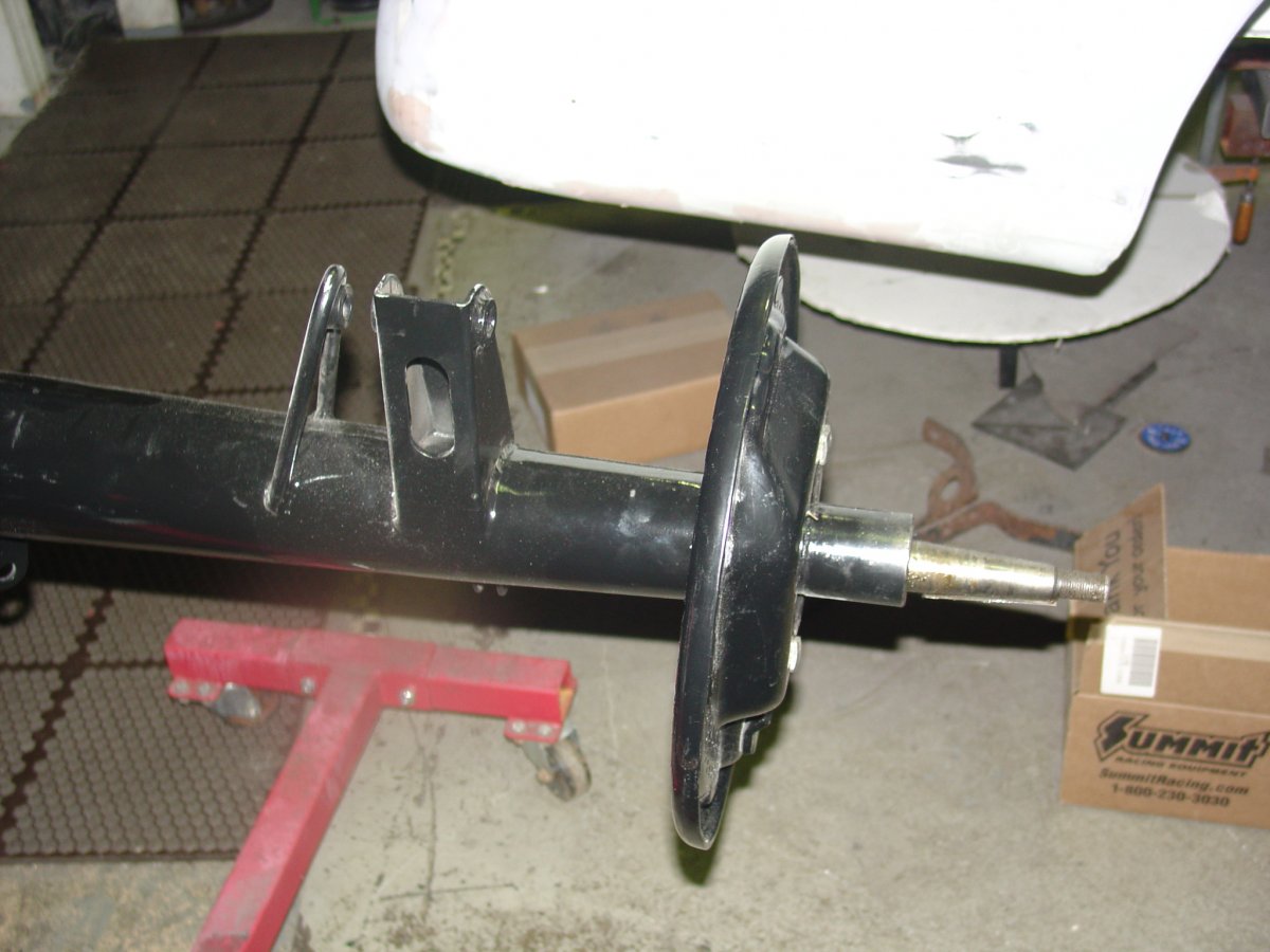

  8. oj
    Posts: 6,589
    oj
    I took a couple pics if that'll help. Your drums don't look like buick, maybe its the angle or something. I stuck a backing plate on mine and took a couple pics so you can see how far back you need to get.
    The rear is upside down, I have sticking straight up to rebuild and rolled it over for these pics. DSC00469.JPG DSC00470.JPG
    This is the front but it'll give you an idea of how big the Buick drum is and how they stack up and they are a full 2 1/2" deep at the shoe. modified 043.jpg
  9. Soviet
    Joined: Sep 4, 2005
    Posts: 729
    Soviet
    Ric, everything you need to know is mentioned or linked in this thread.
    Those drums are not modified Buick, they're Frankland and/or SRE.
    Ric Dean likes this.
  10. Ric Dean
    Joined: Dec 20, 2007
    Posts: 477
    Ric Dean
    from Central NY
    Yes I knew they were not Buick, one reason alone is they are twice the thickness, plus notice solid rim around the ribs or vanes whatever their called. I cant find any name on these.
    thanks,Ric
