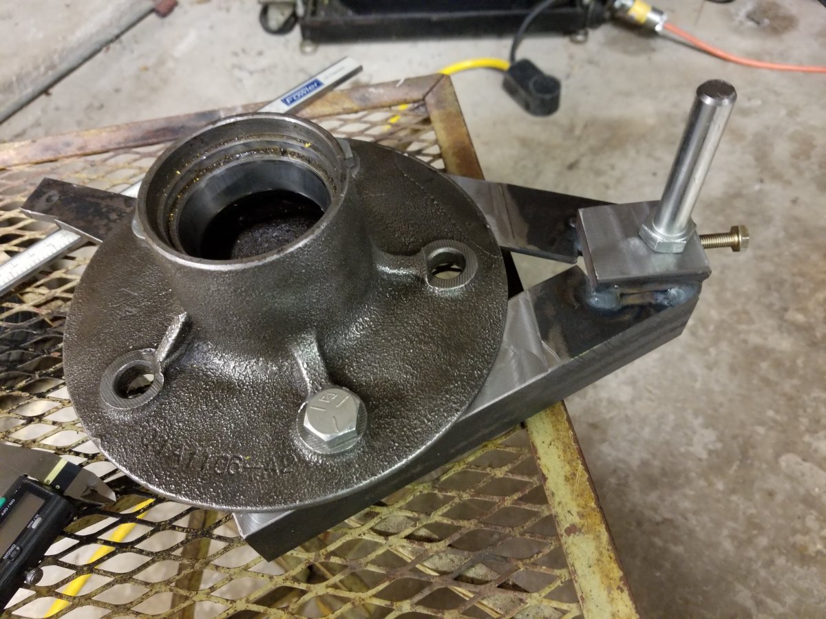

    I had the same problem. I made a big lever to bend the plates on the car. I used a strap from a wheel stud and measured to the backing plate. It just took a few minutes to get them flat.

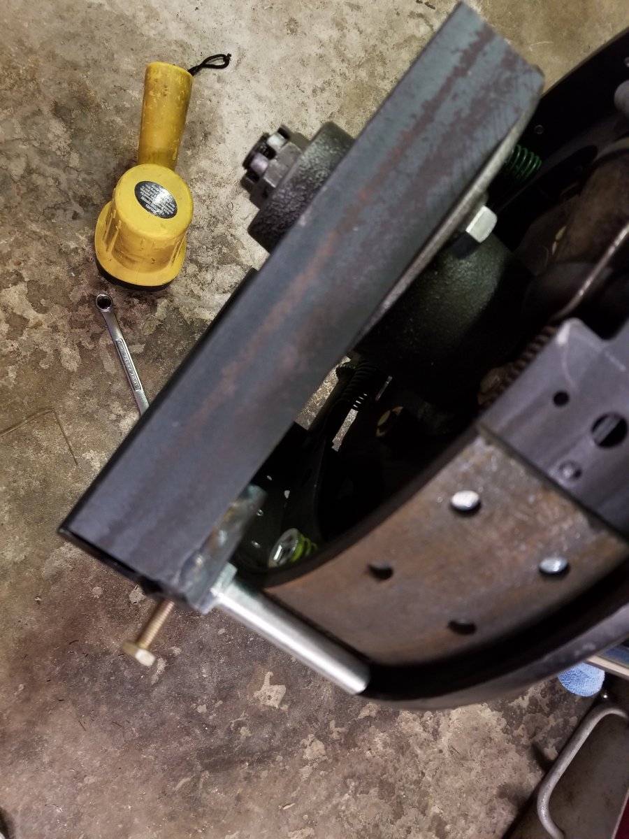

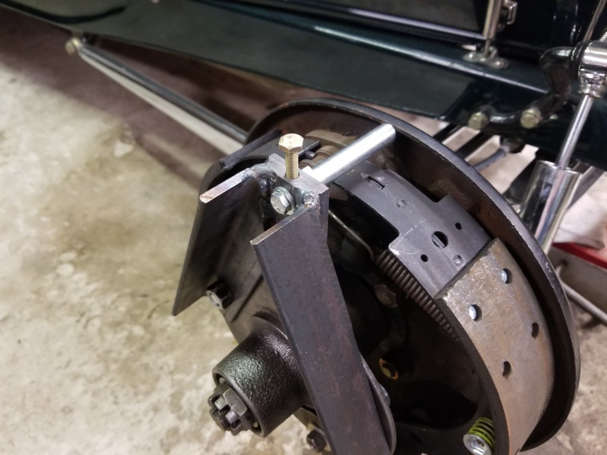

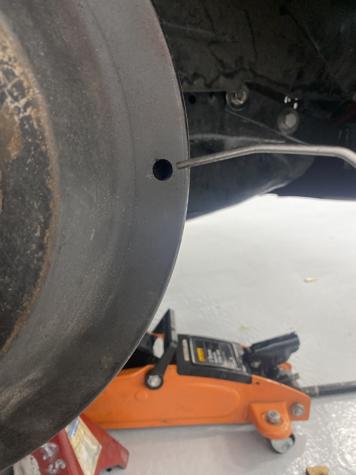

    5E0DE18A-E1D6-4622-929F-0B32D686F2B7.jpeg A friend knocked me up a pointer. The back plate was approx .080” out of square/true, a few bashes and it measures up ok
    after some whacking measuring through these handy holes in the drum I’ve got it to with in .007”
