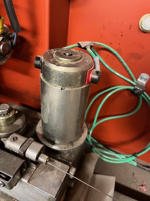

    Sounds like the drive motor may be shorting out. Put a voltmeter on it and see if it showing some stray current. Mine died about 2 years ago but did get a DC motor from McMaster- Carr. Had to modify the mounting to make it work. I could not find a replacement for a reasonable price. Let me know if you need the part number.

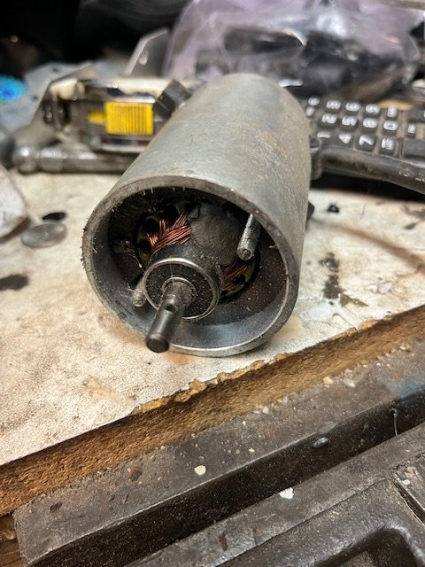

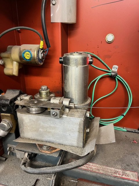

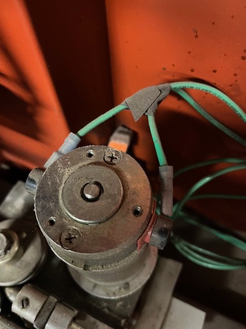

    Here is the info on the McMaster-Carr Drive motor. Part number 6331K67.
    I have attached pictures of mine. It has been a couple of years but I don't recall a big h***le.
    Had to pull the drive gear and the old base plate and put it on the new one.
    Works like a champ the last 2 years. Responds to wire feed setting just like the old one. New drive 1.jpg New drive 2.jpg New drive.jpg Old drive bottom.jpg
