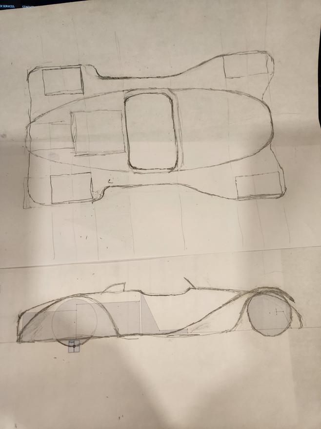

    I want to NOT do frankenferrari type work to the engine.....some flow work, cam, blower. But how can you have a blower without an intercooler? and flatheads love to detonate.....direct injection sorts that pretty well. So it will need decent rods which I was on about on the other thread, I'm thinking 300hp@4500-5000 is the engine goal. Nothing too crazy but I am wondering if I could adapt mechanical diesel injection to make it look more correct than electronic would look?
    It will likely get a modern transasxle....no real decision there but (avert you eyes) it might be an audi unit because they are cheap, light and work good. Again nothing crazy happening here...unless I can figure out how to make paddle shifters look 1930s o_O
    What I really want to do with this project is a car that drives and handles well, compe***ive at an autoX well and the lowish hp mean it has to be light...I'm thinking 1500lbs is do-able if I do a birdcage style space frame. I built a few of these years ago for fsae cars so I feel pretty comfortable I can do something decent for this build
    It will be a no-door step-in because the frame can be WAY lighter. The frame in the pic is plenty strong for a car like this and is made from 1"OD x x0.028" wall tubing...24lbs iirc? this is bigger and 2 seat, so the target bare frame is 80lbs I think.
    Then the layout and body...for years now I've been thinking cl***ic front engine full fender roadster. but last night I got thinking about maybe being a bit more creative. mid-engine race cars started to be a thing in the 30. The auto union cars were winning races in the late 30s but I'm not thinking race car look and having running boards to make stepping in easier would be helpful I suspect so off to google land.....

    and right now I'm here concept wise.
    It still needs a ton of work but the the lincoln V12, audi transaxle and 2 people should fit. as drawn its 4" off the ground, the body is 24" tall (so 28" off the ground) not counting the windshield or scoop. I'm not very artsy so this stuff is a struggle for me....its feeling like a workable direction though.

    where's the center of m***? that engine is heavy, so I think you'd want to scoot the rear wheels back or the driver forward as much as possible?
    If you want to get 50% more hp out of an engine with a positive displacement blower, and you put carbs on top of the blower, then you don't need to mess with intercooling. If you want to run a centrifugal blower, and efi at the intake, then an intercooler would be helpful.
    looks like you could spend a long time thinking about this problem.
    I wanted for years to make something with the engine in front, single seat. The bird cage construction is a neat way to go if you don't need doors. Worked for airplanes.
