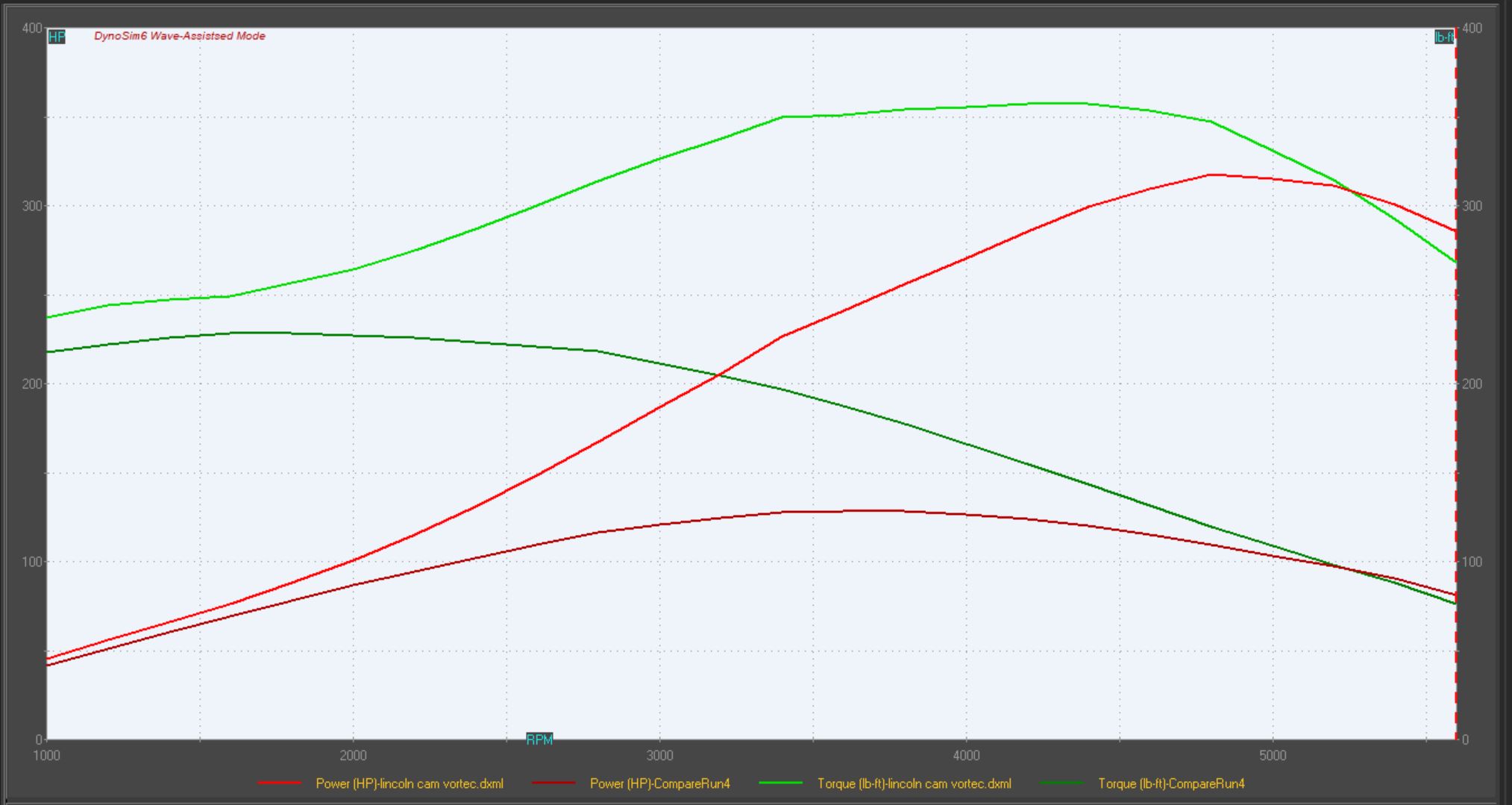

    I opened up the engine simulator imported and corrected the old files I had to work with the newer software version. I looked at my old thread....but I was thinking about boats back then. I got looking at a schnieder 262h-10 hydraulic (216@0.050") with bigger valves and good intake and 170-180hp, kind of what you'd expect. but it was the boost I really was trying to look at and....if I want to get near 300hp it ain't gonna happen with a roots blower. A screw type blower will get me there but after playing for several hours.....I really like a Vortec V1-S. I've always thought the centrifugal stuff was the worst of turbo and supercharging but on an engine that already makes mountains of low end this this really flattens out the torque curve pretty nice.....I kind of like it, at least on the simulator. I played with some turbo options that are pretty nice too but nothing I liked better than this yet.
    This is stock (which looks about right) v the built engine

    I wasted another evening on the engine simulator. I've decide it just doesn't understand how anything can flow this bad o_O. I have a book, "flathead ford V8" and its got a bunch of builds in it with dyno numbers and its got typical flow numbers. The lincoln has the same valves as the V8 and the same people designed it so I figure its pretty safe to use the data. If I use the stock ford flow data, I need to time the cams at 130/115 to get the hp peak at about the right rpm, actual cam timing and the peaks is 3000ish not 3800ish, but I get 120hp which is probably spot on. When I plug in the V8 engine data from the book, I need to roll the cam and still can't quite get the hp. But when I take the ported v8 flow and give it V12 cylinder displacement (so 50% more flow/cylinder than a V8 has) though it seems perfectly happy, 273hp happy which seems very believable when V8s are making 200-220 with the same flow numbers in the book and the V12 was 125hp when the V8 was 100 with the same flow
    (I think) and same 2 barrel carb.
    then added a screw type blower with an intercooler and BAM! 400hp
    The main concern I have is the V12 is 8 port intake and exhaust. The way the ports are mated in/ex there is not less than 240 degrees between events......the 262h cam is 216 degree @ 0.050" but they says 262 gross duration so there will likely be some cylinder to cylinder interference ...but not horrible and longer duration probably doesn't really help much nor does header and intake tuned lengths as there will be interference between the cylinders.

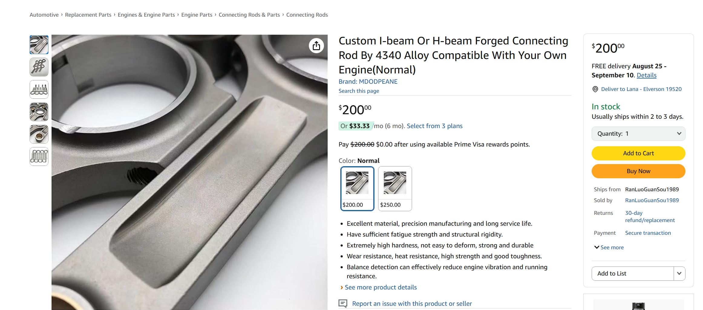

    well isn't this interesting....I pinged them.

    Rod (singular) times 12 equals 2400. Good luck, they have their finger in a number of different auto parts.
