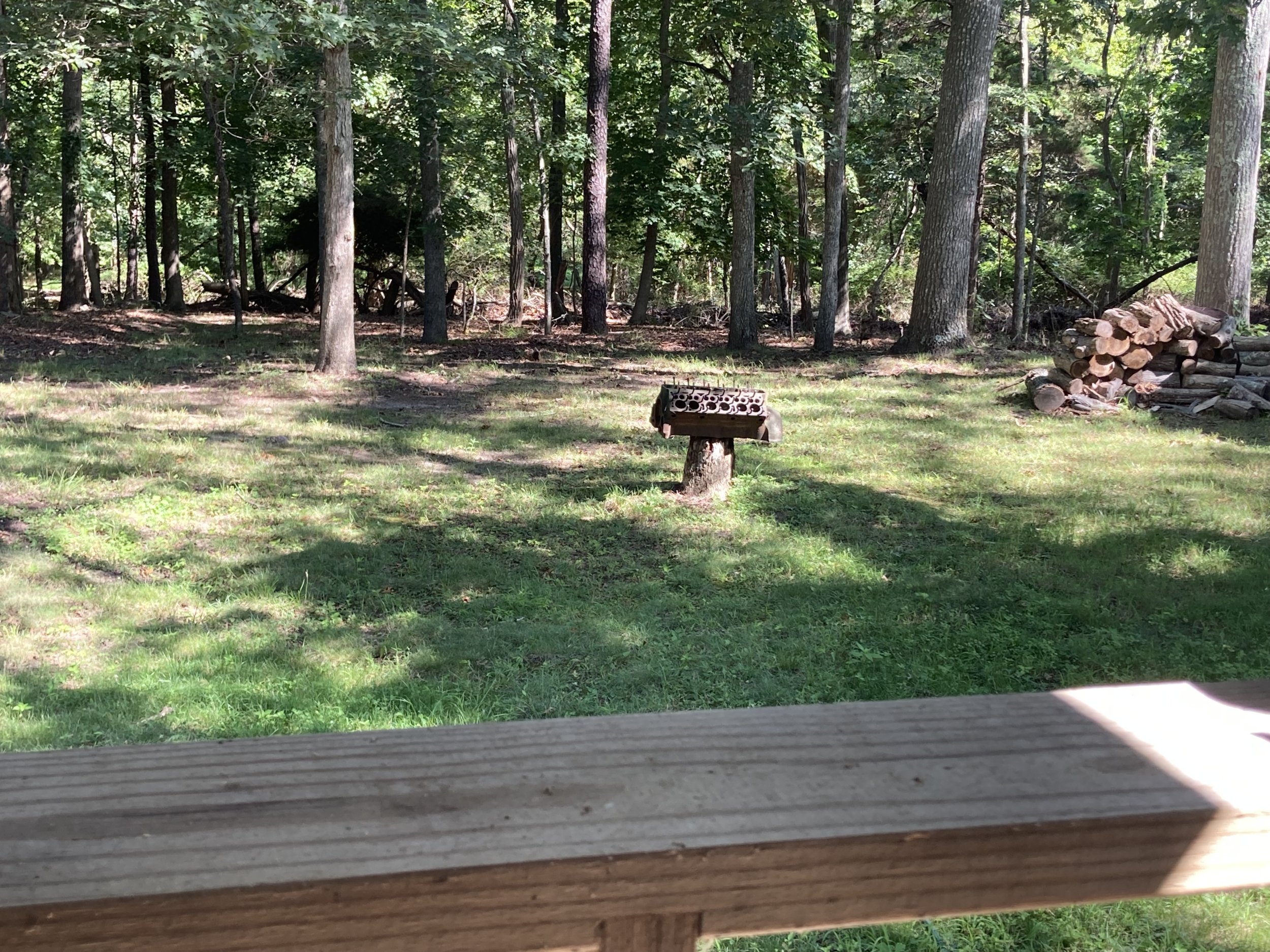

    This one sat in a field for about 20 years before I decorated my yard with it. I think it wants to join in on the discussion.
    duecesteve and Ned Ludd like this.

    Oh the poor thing!
