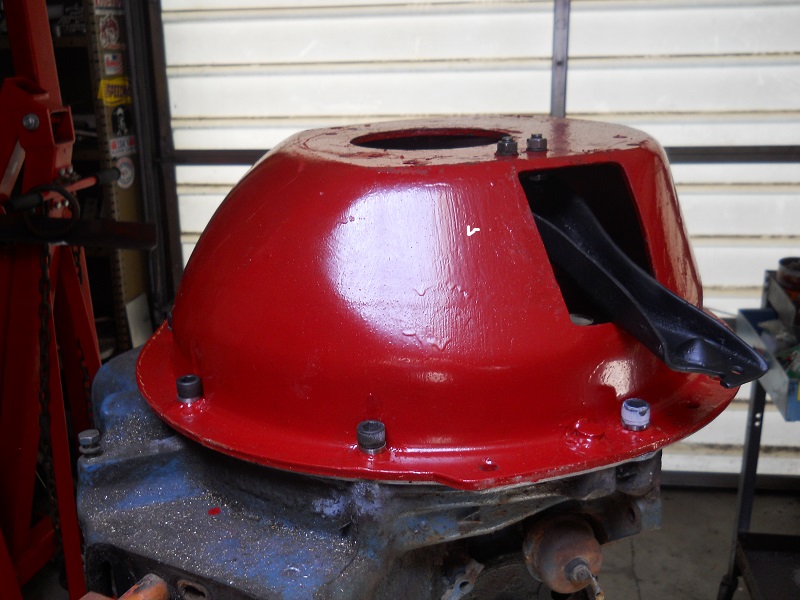

    DSCN0126.JPG No there is no high performance equipment made for the Lincoln Y block.. Nothing like Stack injectors and there is no way to bolt a standard transmission to one. Especially no SFI accepted flywheel shield. 017.JPG

    The FE flywheel fits and so the FE starter and clutch parts work. I think just the intake is the hard part. As you were advised, check out MartinRP2@aol.com and the Engine Masters story.
