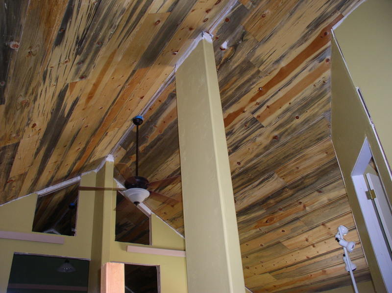

  9. I use Linseed oil/turps on wood such as my bug killed spruce ceiling. It WILL stop corrosion but as said, if it cant soak in it takes forever to dry. Cleanup is a mess.

  11. Here is it on wood;)
    Just doing a picture test, finally got my pic abilities back!

    Wow that looks great!
  14. Thanks Mark! Been working on the shed instead of car stuff for the last couple years. See you at World of Wheels?

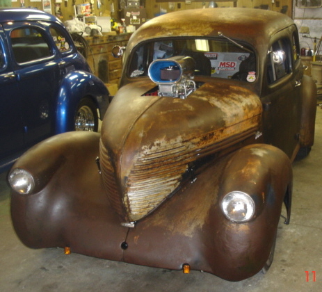

    My 37 Willys has a coat of linsead oil on it, I thinned it a little and put it on thin and it was dry in a couple days. I drove the car all last summer this way, worked great. It also will not effect a future paint job, as it is actually an additive for paint. Wipes off with acetone. I use it to preserve the factory rust on my car, as do a couple friends of mine. Definately need to use Boiled linsead oil though. Rusty

    What the heck is "Factory Rust"?!
  22. KreaturesCCaustin
    Joined: Sep 3, 2008
    Posts: 1,258
    KreaturesCCaustin
    from Austin, TX
    Ever seen a Mustang?
  23. Weasel
    Joined: Dec 30, 2007
    Posts: 6,696
    Weasel
    Standard on 1970s Italian cars....:rolleyes:
