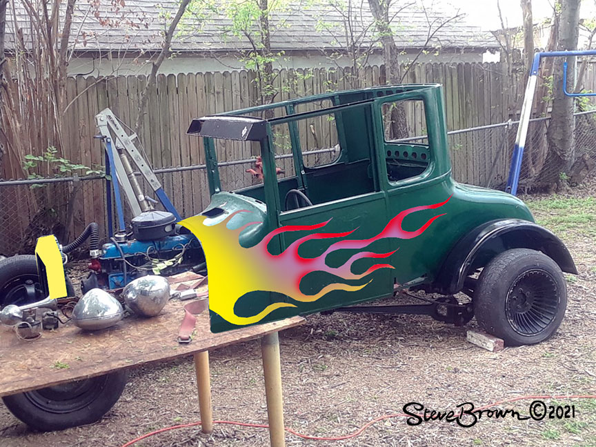

    I would do flames in this style.
    Looks good and can be done with brush or rattlecan.
    I think orange or red would look best on the green.
    The photo is from the net.

  15. 210413LipstickpigT.jpg Sorry 'bout the copyright thingy, ignore it. Feel free to use the layout/image as a basis/springboard etc. should you wish (it is yours!).
    Cool lil' car mate.

    Thanks Anders. I like it!

    Thanks Spoggie. I think between what you and Anders posted, I know what I want to do. I also checked out some of your featured threads. The Friday night art show looks awesome! I didn't know about it. I'll check it out more later.

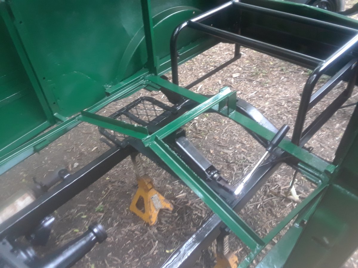

    I pulled the 3rd member to paint the inside of the body and the frame. It is getting closer. Please forgive the homemade sub frame for the body. I couldn't afford a new one, so I made my own.
    The scissor jack is what operates the flip top body.
