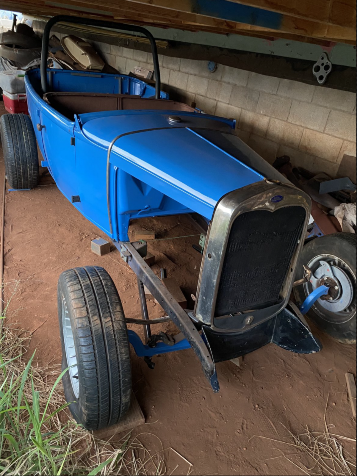

  9. indyjps
    Joined: Feb 21, 2007
    Posts: 5,396
    indyjps
    Be Safe. I know you're using any materials available to get a driver, just be safe.
    Can't argue with John D**re Green, cl***ic color.
    Gotta ask about the seat. Is it from a vehicle, or did it start life as furniture ? I like the look of the upholstery.
    chessterd5 likes this.
  10. indyjps
    Posts: 5,396
    indyjps
    Just noticed the rear wheels and heavy offset, rear wheel swap to a centered wheel would allow the tires to tuck under the fender more.
    Looks like the body was set up on frame for a raked body look. This does create challenge with the cowl sitting low and the hood line to radiator. If no hood is planned, it's less if a concern.
    Level channeled body, unchopped, is a great look if you ever decide to make changes.
    I cant tell how the fenders attach, but it looks like they could be moved up on the body if you decide to level the body.
    Keep the updates coming, Go Drive and have fun. See what you like and what you want to change.

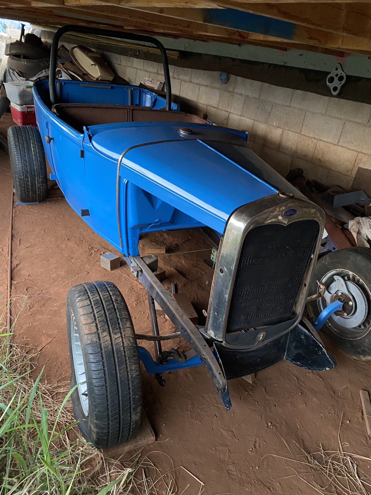

  11. chessterd5
    Joined: May 26, 2013
    Posts: 903
    chessterd5
    from u.s.a.
    Yes sir, of course. I have paid attention to scrub line, Akerman angle, and checked suspension travel multiple times. I plan on a professional alignment when I get to that point.
    I will also have the drive shaft cut down and balanced professionally. I am also going to install a drive shaft loop. All the ball joints and tie rod ends appear in good service, no obvious unintended movements.
    The frame is boxed with quarter inch plate and the suspension mounting brackets are half inch.
    I will be installing new bolts and nuts in the body mounts soon.
    I still have the steering to do as well as the brakes. There are new brake hoses, star wheels and hardware already installed. I have already started doing research on which master cylinder and proportioning valve to use.
    The seat is part of a phootan couch. I'm working on brackets to mount it to the body. I also have seat belts to install when I get that far.
    AHotRod and hotrodjack33 like this.

    Yes sir, the rear of the body is on top of the rear crossmember. The front is channeled the width of the frame. It does give it a raked look.
    The rear fenders are mounted in the stock location on the body, in the stock holes.
    I would like to put different wheels and tires on it later.
    I wasn't planning on a hood. The body is pushed back 6 inches on the frame.
    I do think cycle fenders on the front would look good.
    AHotRod, AndersF and indyjps like this.
