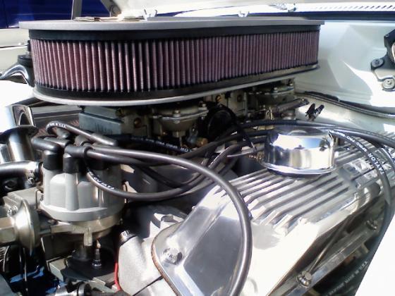

    I have an Offy dual quad on my '57 Fairlane 390. I'm running holleys (they mount backwards). I haven't run it yet but it looks cool. I bought repro linkage and fuel log. I got it on ebay for a good price. The only thing I don't know is how to set up the carbs. How to jet them and set them up.

    I put an Offy on mine, got it on a trade. Some people don't like um, but I'm a tuner and love it. I have 61 low riser heads, worked over good, and a .560 lift 290 dur cam w/long tube headers... 3.50 gears and stick..My car has tons on bottom and pulls very hard on the top..600 vac sec Holleys...Plug the power valves in both carbs....Happy Motoring....
