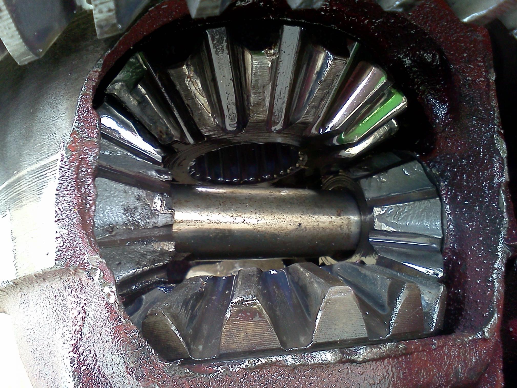

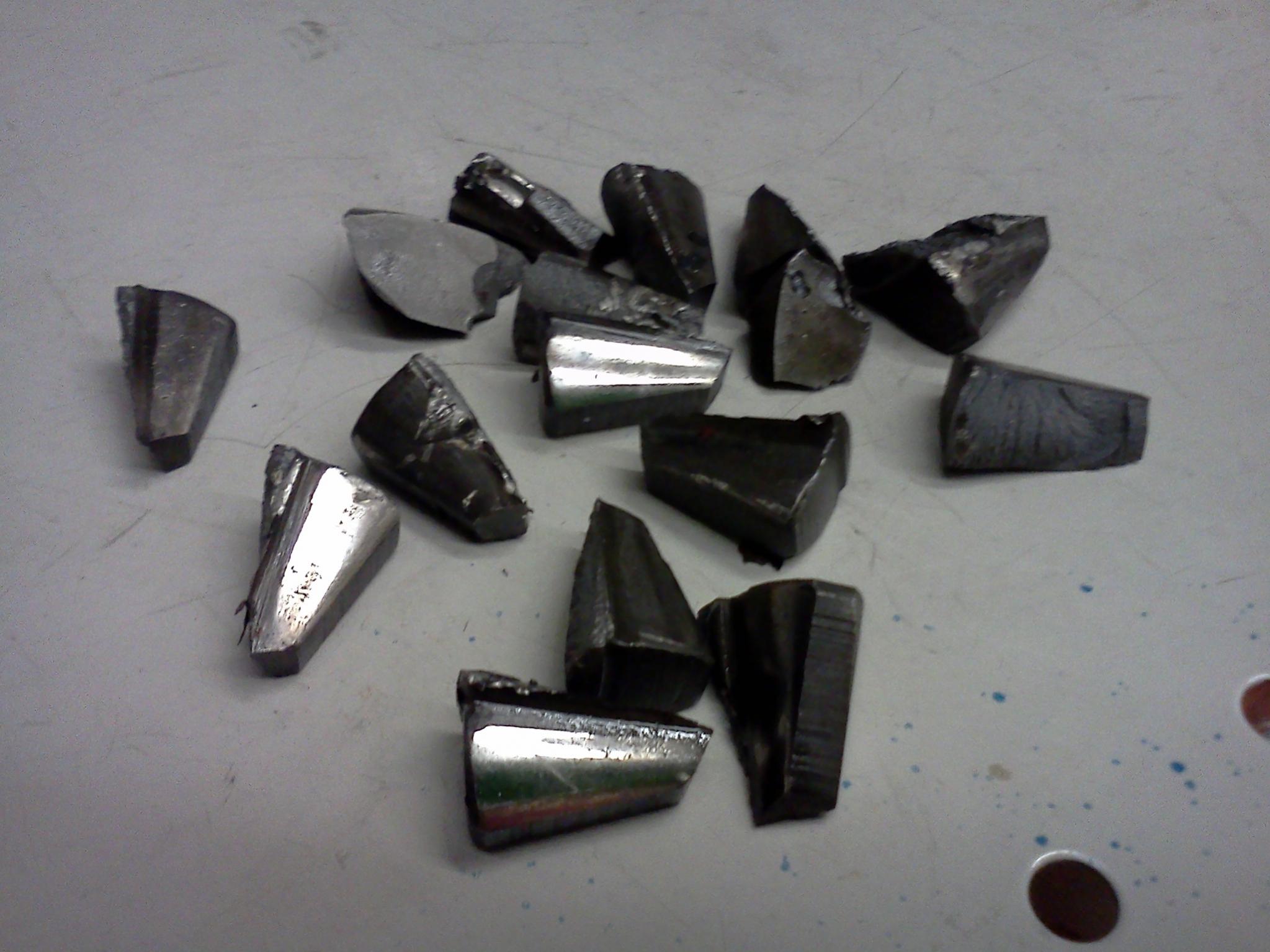

    Doing a little showing off got me this.

    seemslike a perfect time for a upgrade on the driveline

    looks like you found a weak spot.:D

    Its the 5th one lunched ,down to my last spare. time for a upgrade is right haha

    Ouch, shim the axle to spiders and weld them together and make it a spool

    Yeah I've found out the 55-64 chevy rears are weak.5 pumkin's and one broken axle in the past 14 years i'snt to bad i guess.

    One with 4 spider gears.
    A 2 spider 9" will just do the same thing.
    Some type of limited slip or locker would be a good idea. The one-wheel burnouts overload the spider gears.

    Looks like you lost all your wisdom teeth.:eek::eek::rolleyes:

    It never really smoked the tires,just hooked and took off. Until the ring and pinion or spiders let loose. Yeah well these things happen. Already got the spare pumpkin in,just gonna have to keep my foot out of it till i find a rear that'll hold up better.

    Looks like you just need a posi to prevent the breakage. The stock posi is 4 pinion and has no slop if it has Belleville plates.

    Your mum always wanted you to be dentist didn't she....

    Oh yeah, they pop like penny candy in the stock form when put to abuse. Especially if they haven't been gone through in decades.

    That was my initial thought... although welding 90-weight makes me queasy at times.

    I think I would check if the rear end were warped slightly

    I had an '09 in a '62 Impala in the 70's that would do that. After I was told that both wheels were wobbling I pulled the axles and both had about a half round of twist. Than car kept me broke buying trannys and diffs
