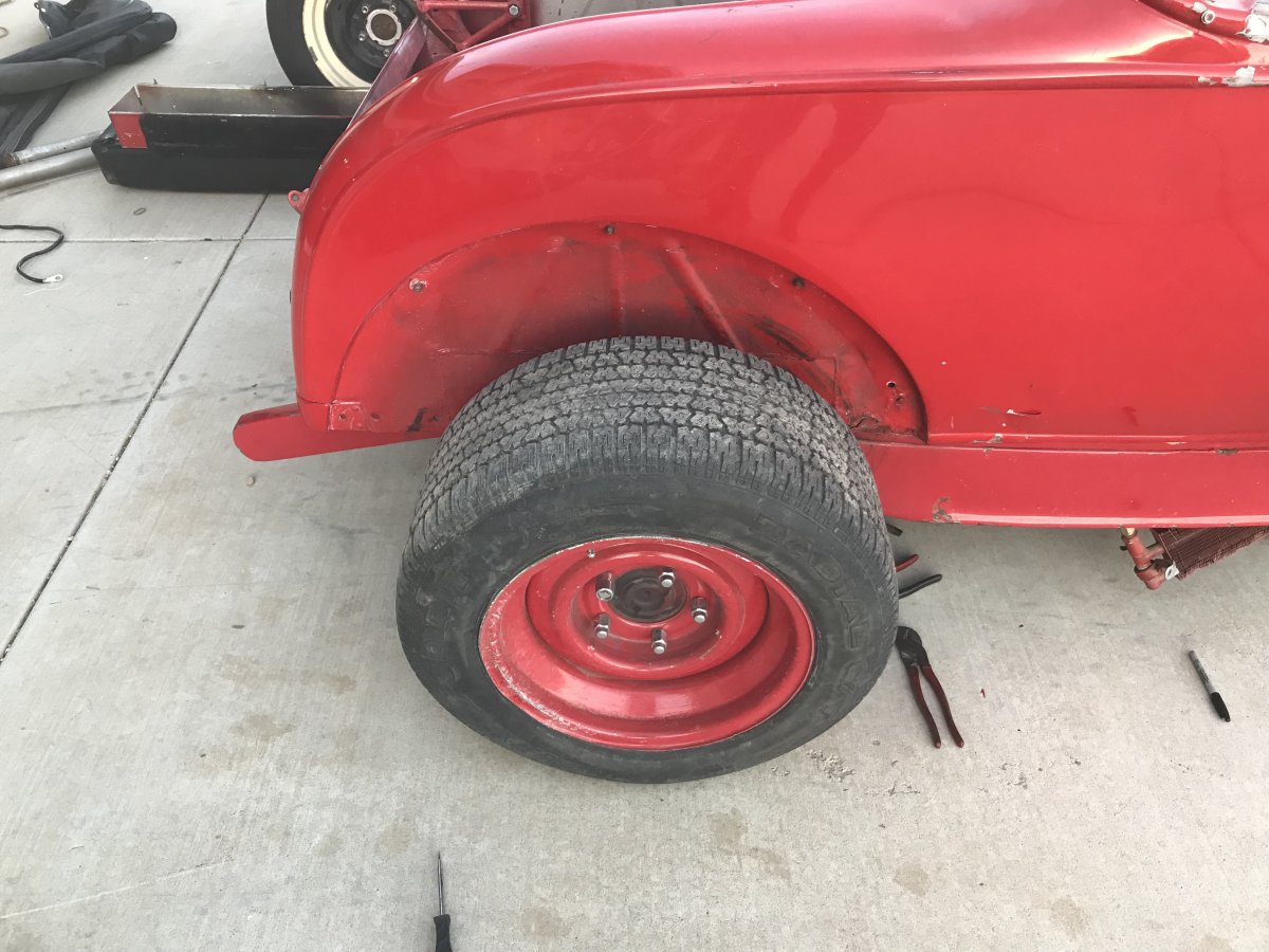

  1. What I see in the photos is that hitting a Brick wall seems to have done Nothing but scratch some paint on the frame horns plus the body damage. The spring shackles are not bent or twisted. The Hair pin frame mounts are not disturbed. There is noting to indicate that incident could have twisted the Frame as I see it. The damage to the 10 bolt is not fresh at all. There's grease in the Weld Crack. It was like that prior to the Krash. I feel the frame Twist is from the Rear Tires doing there Job behind some pretty good H.P. and the fact there is not a single diagonal brace in the chassis to stop or control torsional Twist. Find a Fab Shop that can anchor it and read a framing level. Then add some K legs to keep it where it belongs.
    The Wizzard
  2. Look specifically for Kinks, dimples, or Rips in the Frame flanges and around the crossmembers.

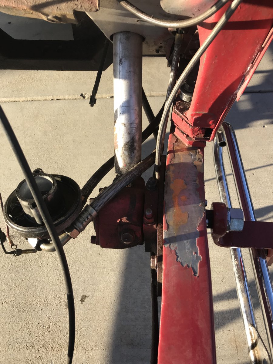

  9. For me I'd keep it simple. The Body fit the Frame once and for a long time. I'd read that carefully and go back there, it may or may not be the same as someone else Blue Print.
    There is No way I would use Brass for any structural weld. That said, look close and notice there is no split or tear in the Brass. I think it's a non issue but I'd keep going and find out why it's there.
    No doubt a New chassis would be the Cat's Ass but then while your replacing things with New so would a Better Body. Then what would you have?
    I'm really curious about that steering box. It looks to have an extended sector shaft. Something I don't recognize for sure as of yet.

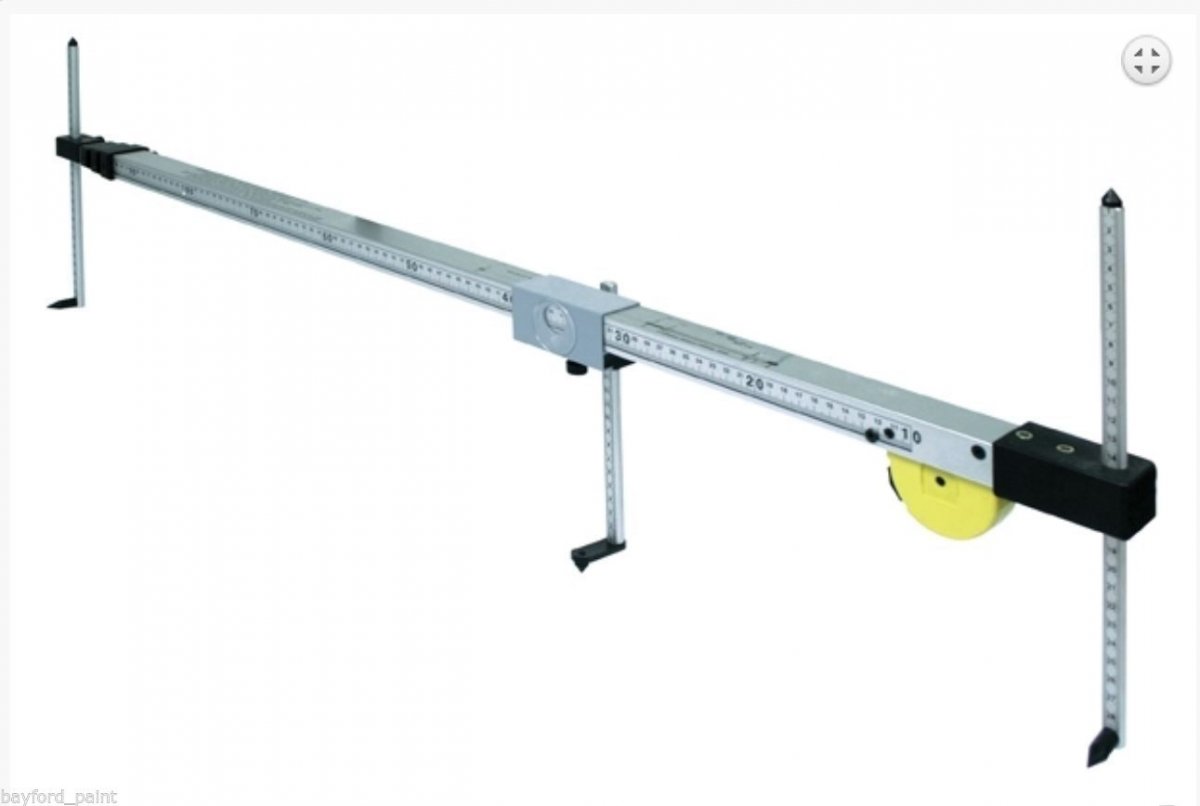

    IMG_8463.GIF From the damage to the rear end and side sway and diamond in the frame plus the straighten wheel it looks like the car was hit hard on the right rear wheel causing all the damage to the frame. From the bent axle tube to the cracked 3rd member housing.
    If you can get or borrow a set of center line gauges you may be able to straighten the frame out . Autobody Toolmart Sells these or you maybe able to find a set in a older body shop that does not use them any more. I still have mine that I bought over 50 years ago . These and a tram bar is all you need. IMG_8463.GIF

    I’ve been told recently that the steering box looks to be from an F3 1 ton or bigger Ford truck. I’m not sure if I’ll keep it or convert to F1

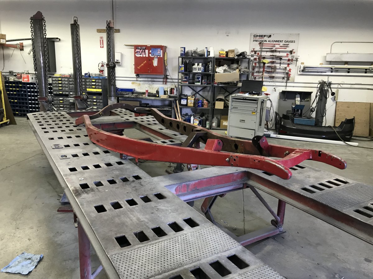

  18. Fyresq
    Joined: Nov 18, 2017
    Posts: 67
    Fyresq
    from Minden, NV
    921A2E37-4FB7-42FE-9C23-EDF98C51E1B3.jpeg The frame is on the torture rack

  21. Ah Yes, Between what the Frame is sitting on and what I see hanging on the wall this is the Right Guy for the job at hand. Once done there and were it me I'd add a pair of diagonal legs from the center crossmember back to just where the Rails start the rise up and over the rear axle. That would give it a fighting chance to stay where the Frame Guy brings it back to.
