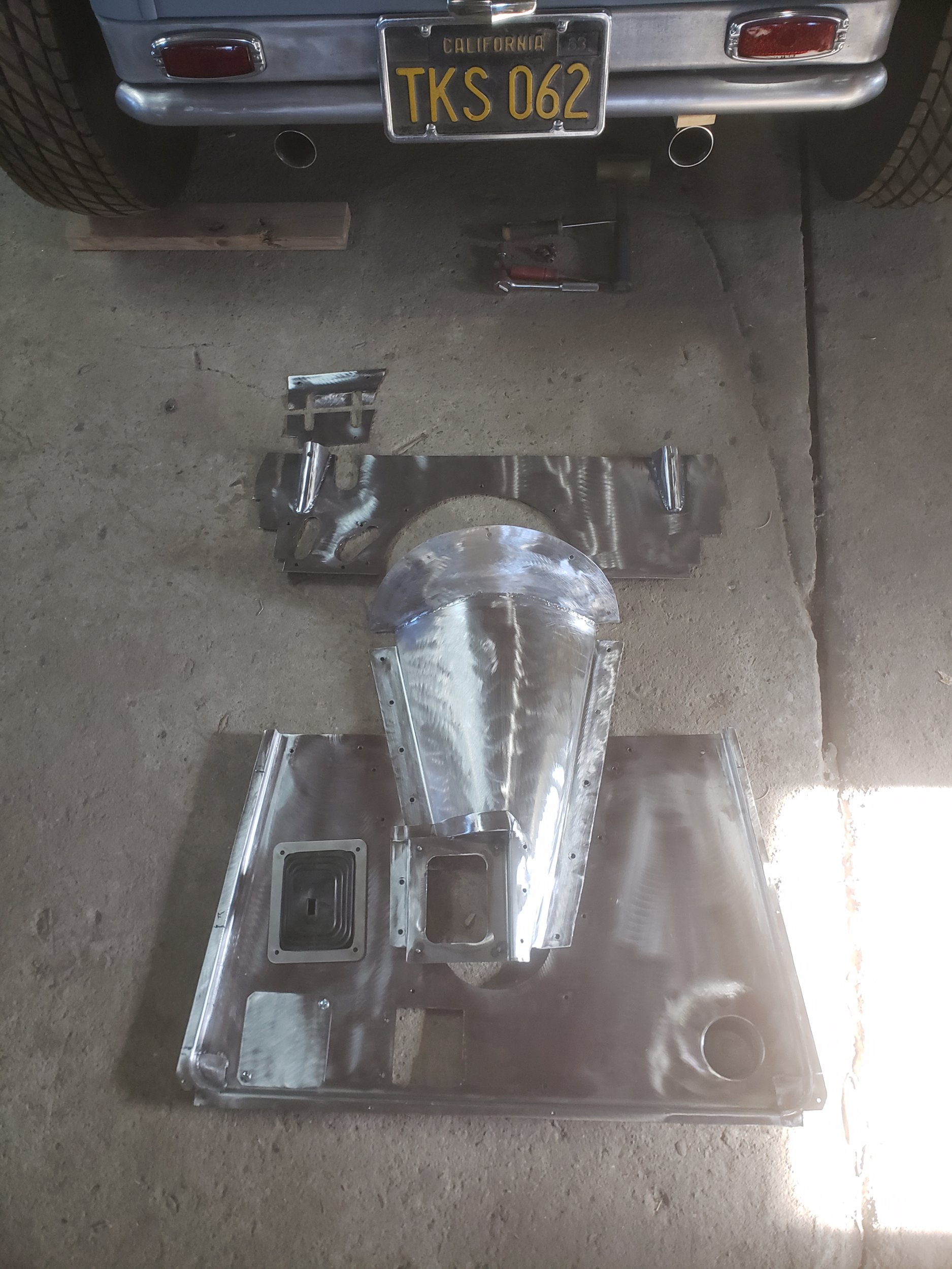

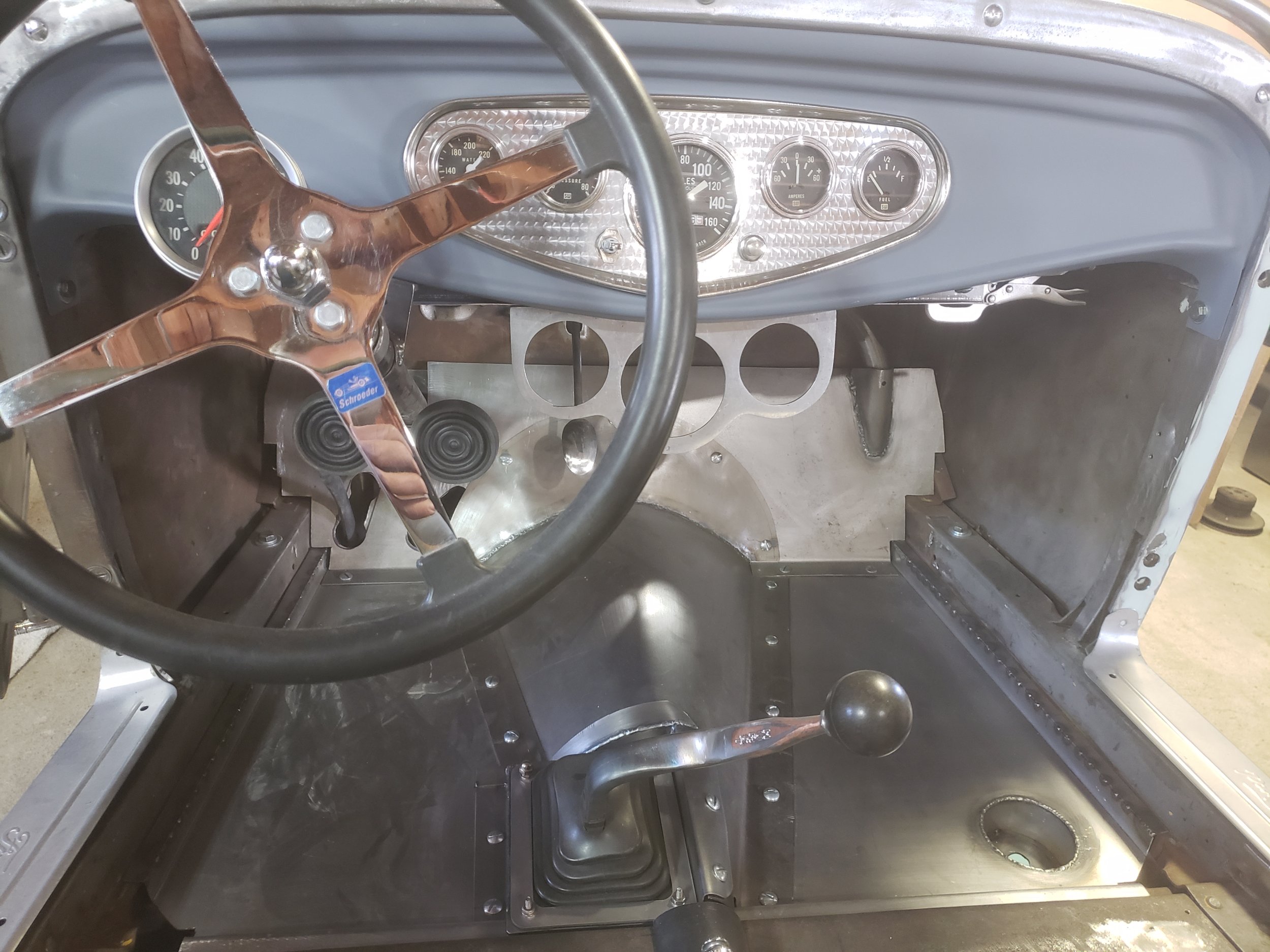

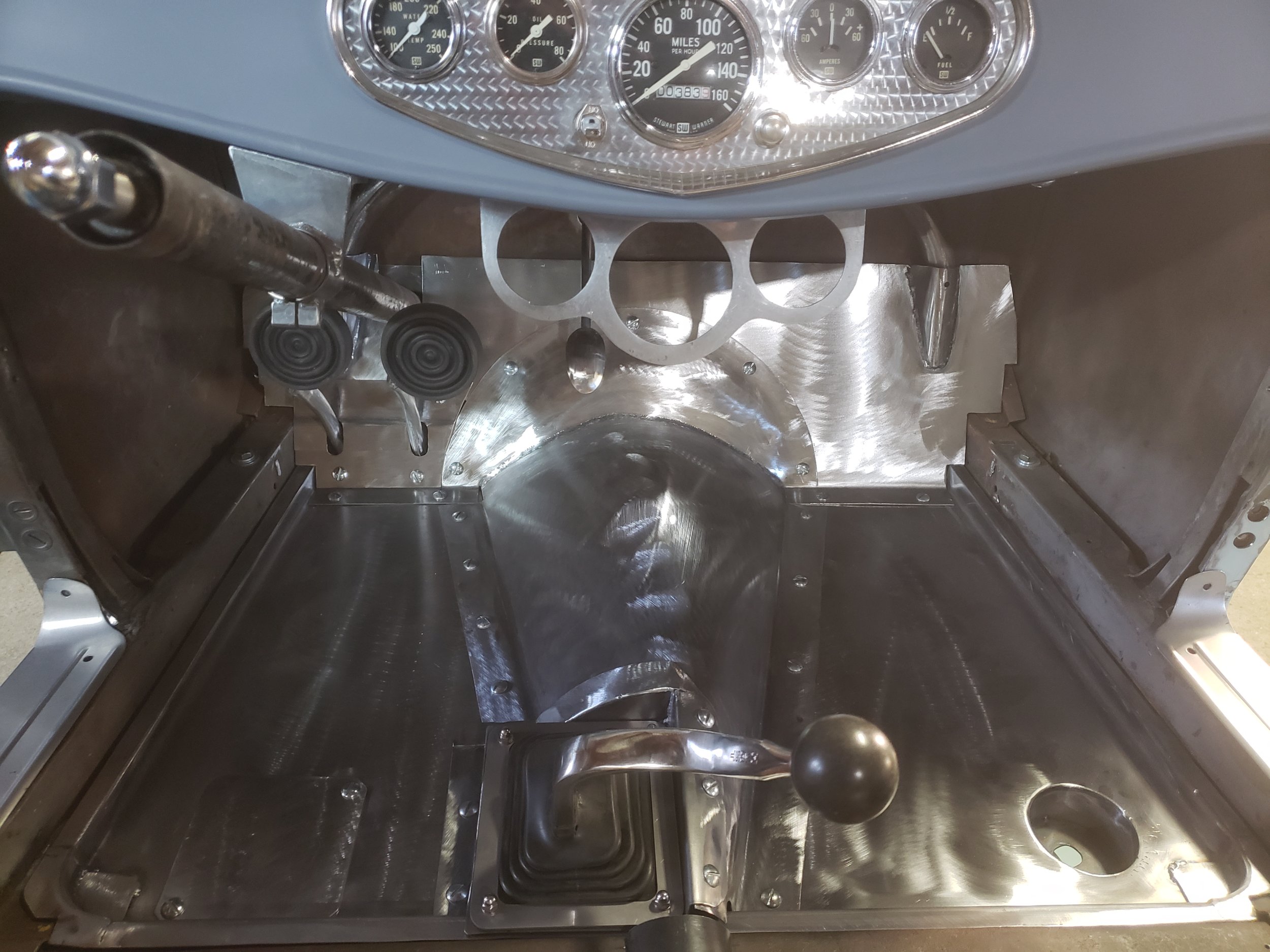

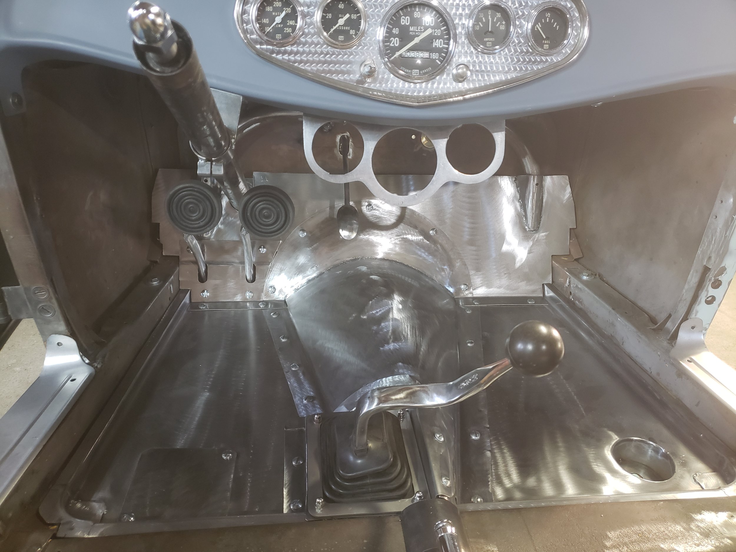

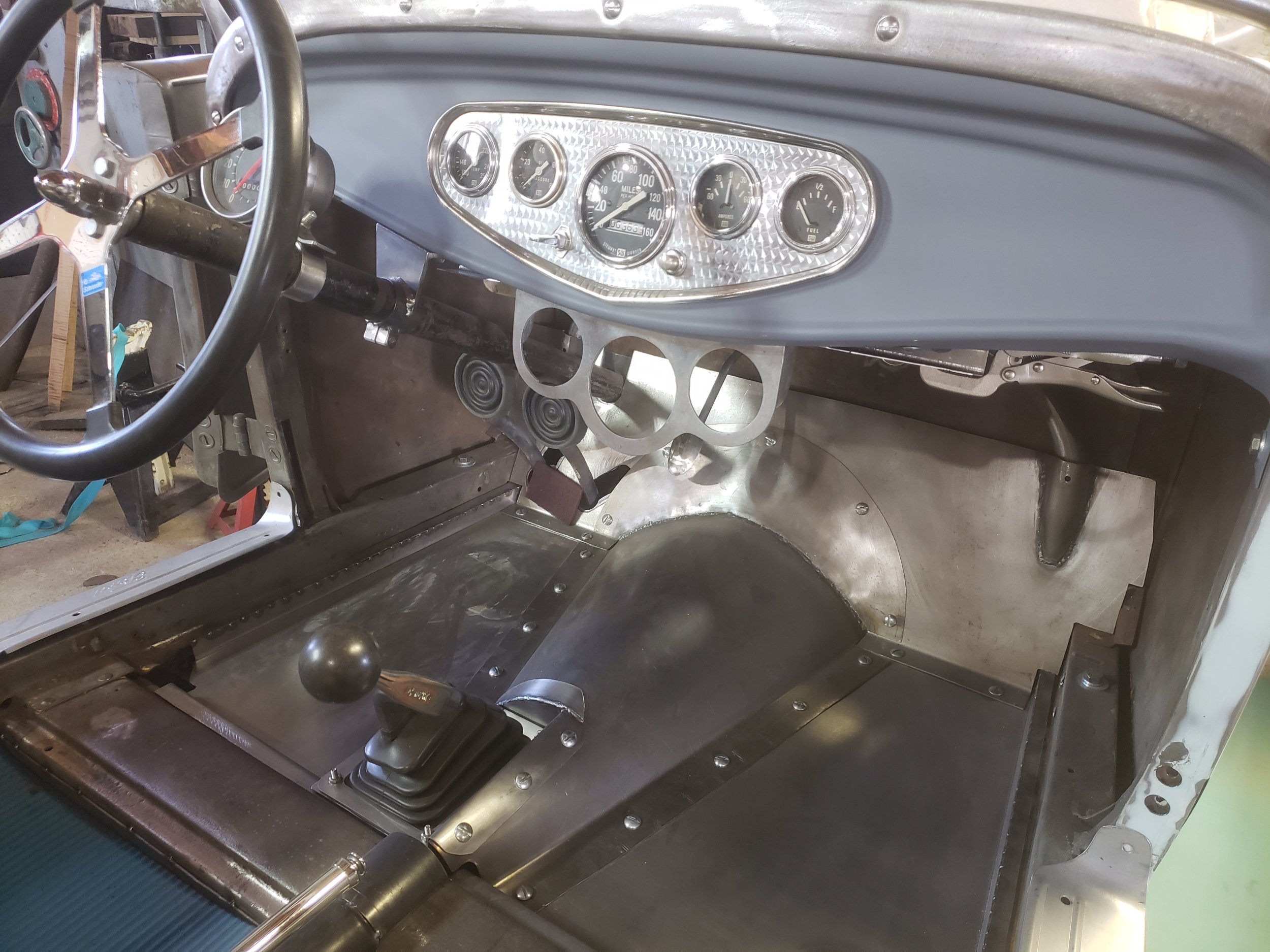

    The hood is pretty much done, now I just have to make everything fit inside. Moving on to the ****pit, I chose a set of Ford F1 pedals they were part of the original design too. As for the gas pedal, I couldn't get myself to cut up an original s**** pedal so made one that is stronger. I prefer a mechanical linkage, not a cable. The pedal ***embly is based on a Ford design from the early 60's. I had a Hurst Compe***ion Plus shifter for the Muncie. I had to bend the handle over to the right so I could fit in the car. There is no extra room in these Model T's. The floors are all removable in case I need to adjust shifter linkage or clutch linkage, inspection hatches for master cylinder service and battery disconnect switch.
    I originally design the car to use a gas tank out of a 28 Chevy. That tank fit well, but the capacity was too small. So I built a new tank with a whopping 25 gallon capacity. Gas stations can be few and far between when cruising on scenic roads.
    As I work around the car I find things I am not happy with. For example, this car has a narrow rear I.E. less than the standard 57". I like the rear wheels ****ed in, but the front wheel track is too wide for me, especially with the brakes that I really want to run so I can create center point steering. I will be digging through the axle pile to figure out how to narrow the front track. 20230331_173154.jpg 20230331_172848.jpg 20230331_171745.jpg 20230331_171905.jpg 20220306_162527.jpg 20220212_175822.jpg 20220212_145206.jpg 20220211_172221.jpg 20220211_161729.jpg 20220211_164537.jpg 20220211_124835.jpg 20220211_164449.jpg 20220209_181527.jpg 20220205_171300.jpg 20220204_175816.jpg 20220402_073120-1.jpg 20230130_144810.jpg 20230130_151106.jpg 20230127_174947.jpg
