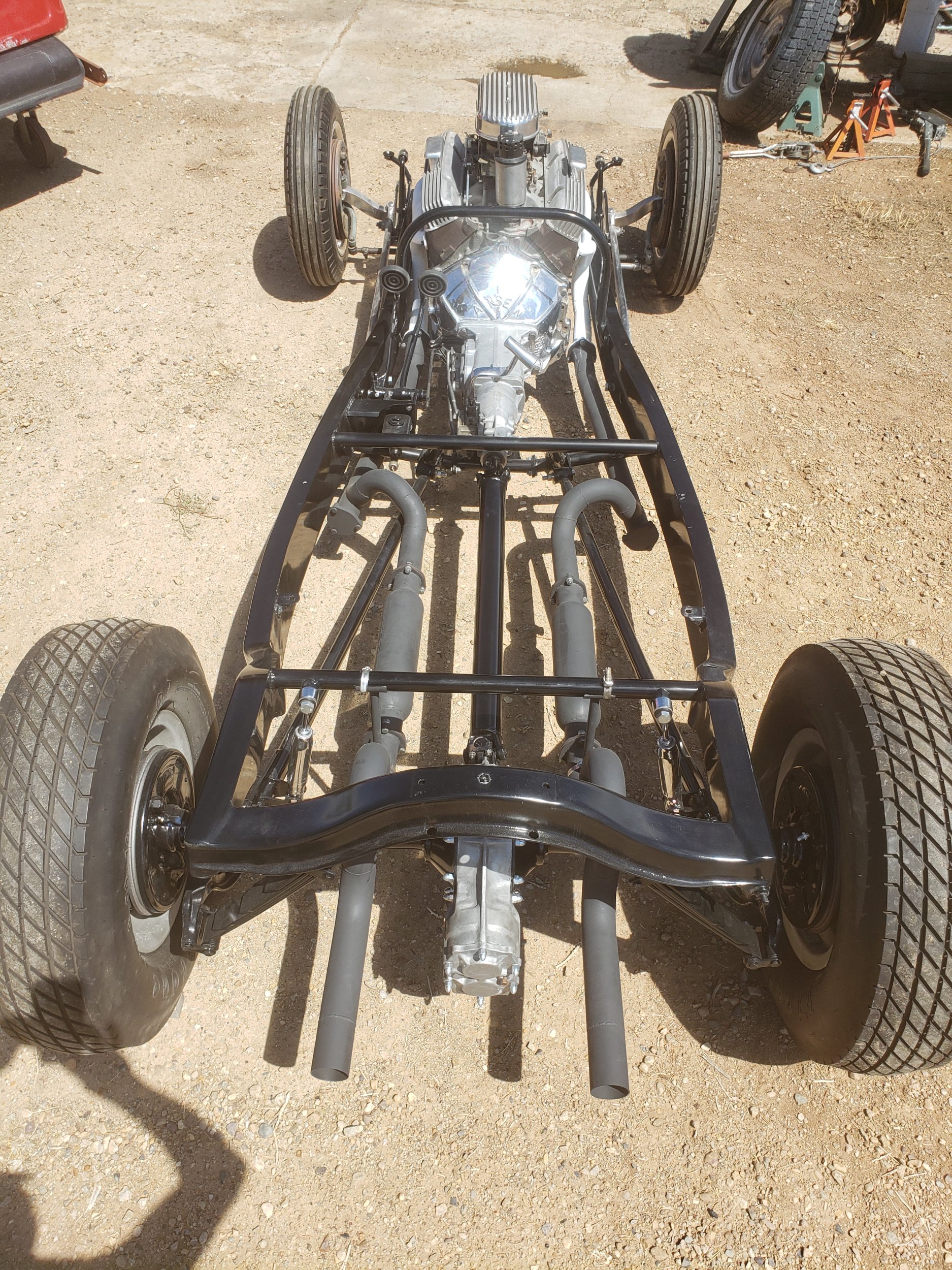

  6. 270bob
    Joined: Mar 26, 2014
    Posts: 152
    270bob
    Adding some more progress photos, you can see how sharp the car will turn with the new set up. I set the camber with Dad's old fixture and rosebud and personalized the axle. Made some coolant piping to adapt to the flathead radiator and finished up the exhaust, 2.5" out the back and optional header block off plates. There will be no nylock fasteners on the car, I chose castle nuts and cotter pins. I am almost ready to blow it apart to finish the ch***is and prep for paint. I added a picture of the Deuce pickup that I originally was going to build before I found this roadster. I built it for my dad and he is now enjoying it and finishing all the little stuff like paint and wiring. 20230422_174724.jpg 20230410_070232.jpg 20221229_182301.jpg 20220515_143529.jpg 20220501_112301.jpg 20220501_113027.jpg 20220501_110736.jpg 20220423_114314.jpg 20230818_114810.jpg 20230514_091943.jpg 20230514_091912.jpg 20221223_161541.jpg 20230513_180840.jpg 20230513_181504.jpg 20230513_182605.jpg

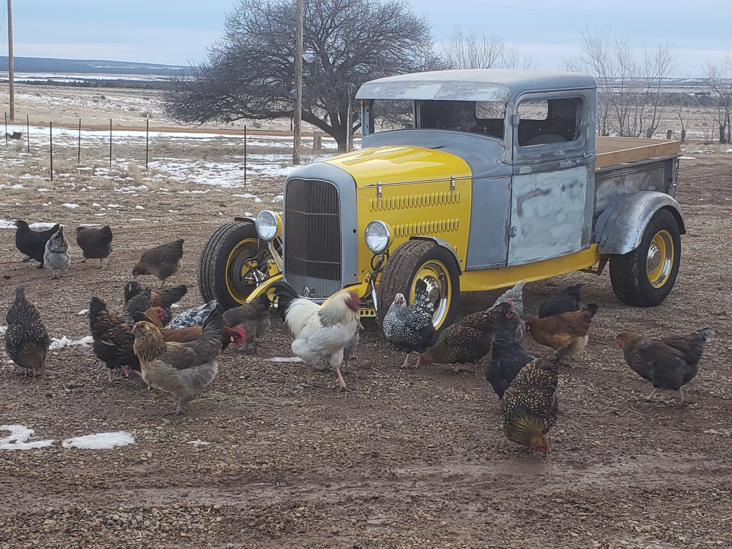

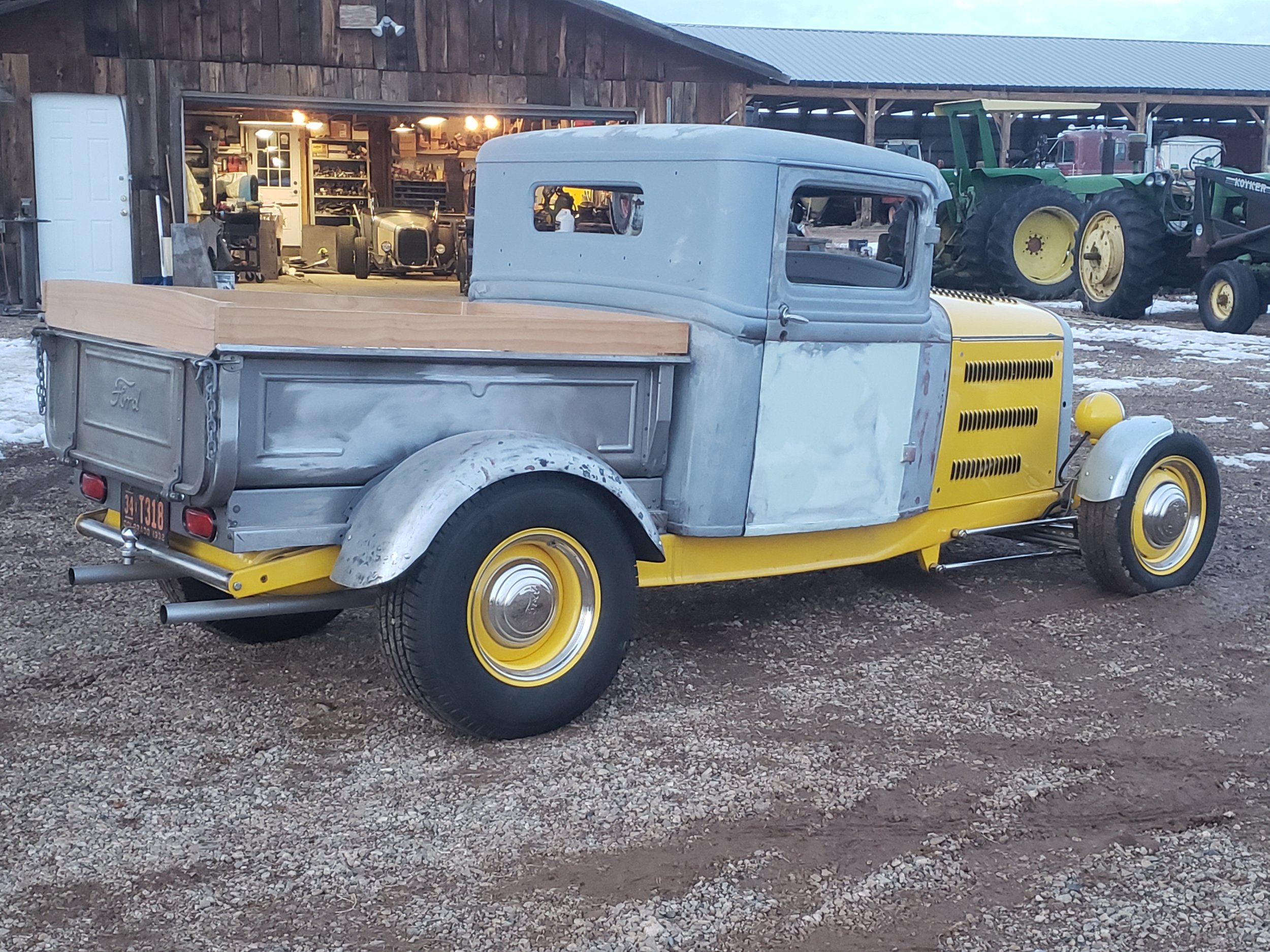

    I like your roadster build, but would love to see any pics of the Deuce pickup that you might like to share!
    hook00pad likes this.

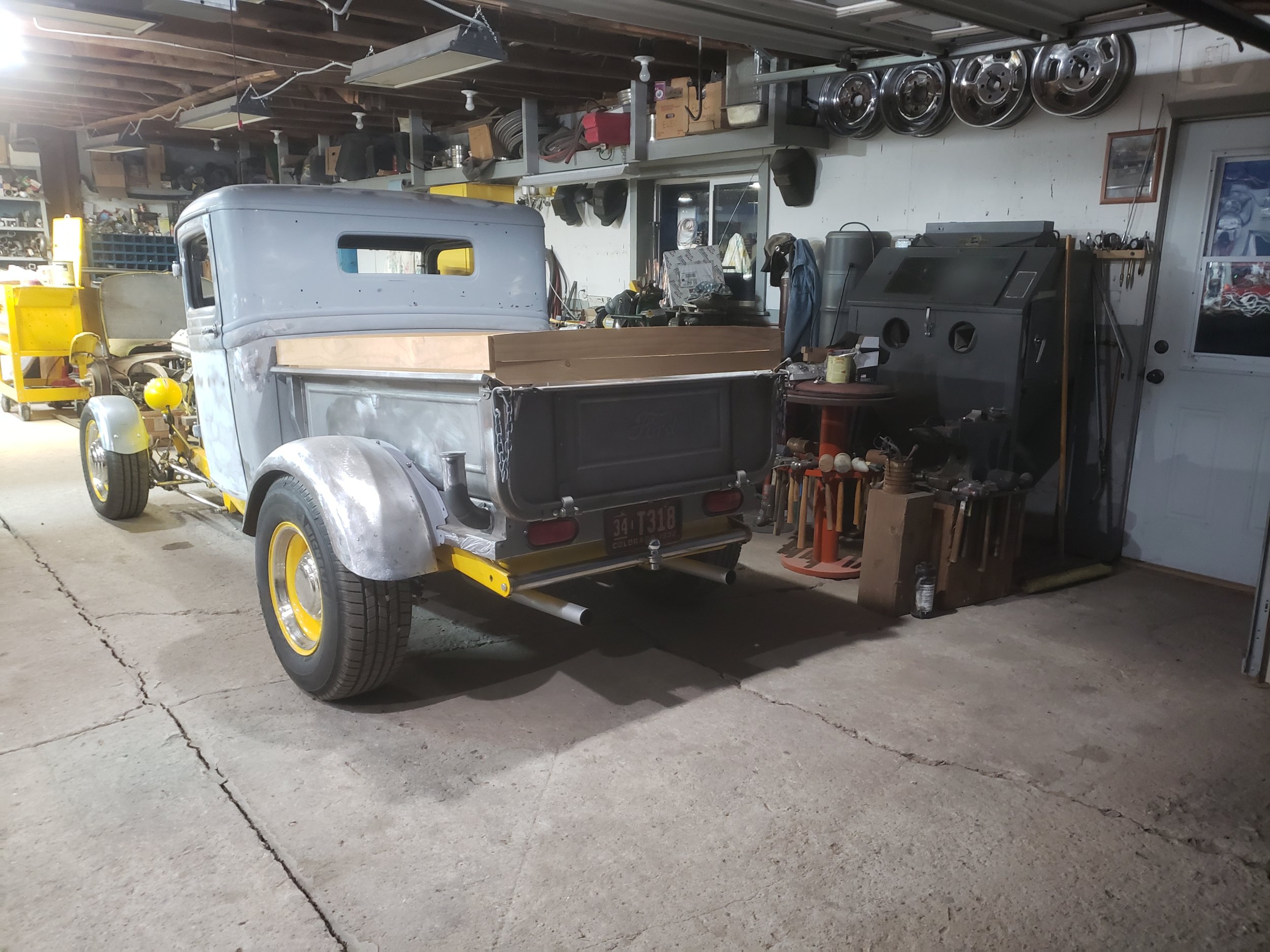

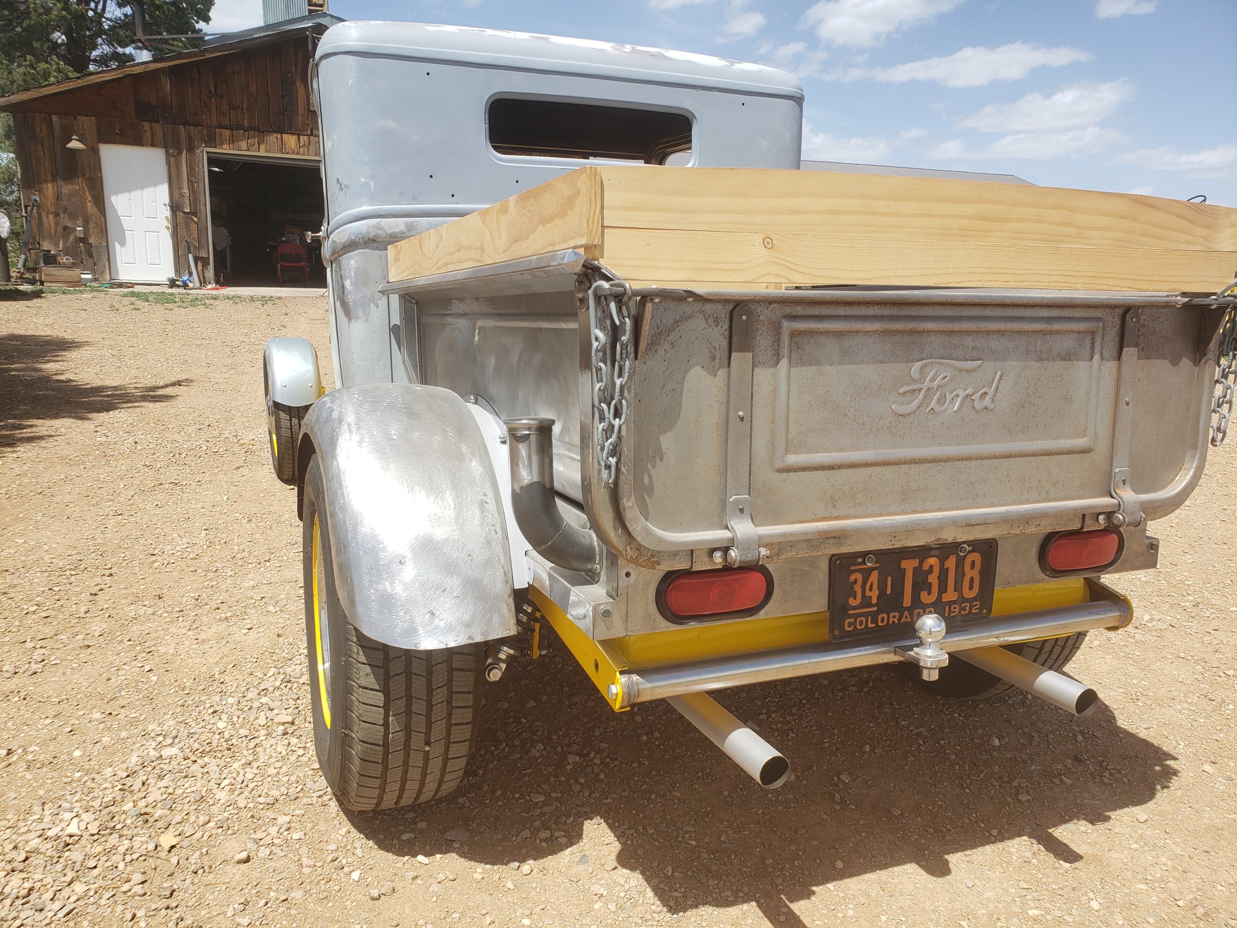

  9. 270bob
    Posts: 152
    270bob
    Thanks, I hot rodded this one too.

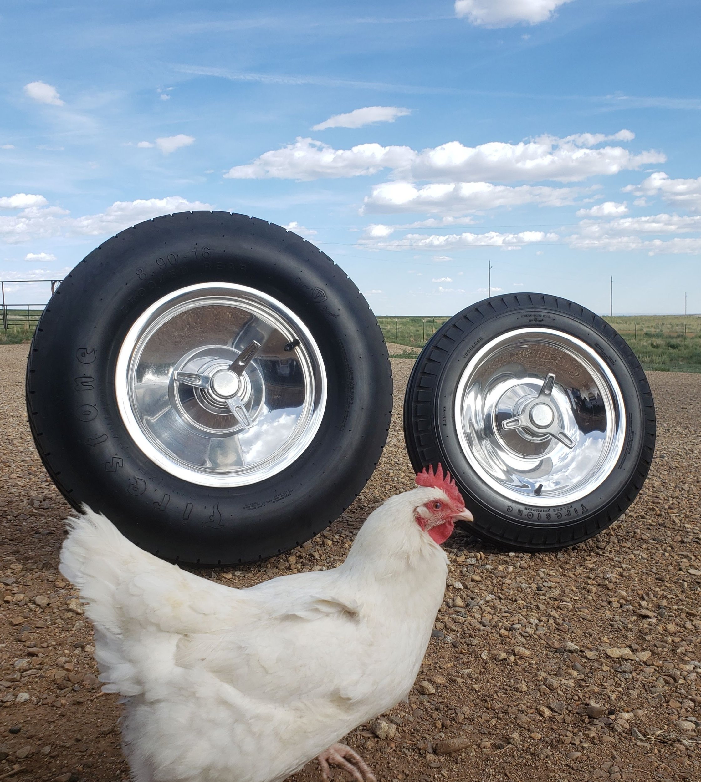

    I see a lot of wheel/tire combos. Please tell me you’re sticking with the solids and dirt track tires. They look so right on this car.
    Outback likes this.
  16. 270bob
    Posts: 152
    270bob
    Thanks, I think so too. They look so right on everything I put them on, but I also restored an original set of Ford chrome reverse too. 20220225_145902.jpg 20211120_103758.jpg 20210601_174652.jpg

  22. V8-m
    Joined: Jun 11, 2020
    Posts: 283
    V8-m
    from Alaska
    20210601_174652.jpg Very nice wheels...chicken approved

    I have to polish these wheels all the time, I also polished the highlights on the reverse side. I put together a set of chrome reverse wheels for this car too. I will cover those details later. Thanks for all the kind responses. Headed to the shop now, I am still hammering on these springs. 20230403_194908.jpg 20230226_182524.jpg 20230226_165139-1.jpg 20230514_090332-1.jpg
    Thor1, alanp561, catdad49 and 8 others like this.
  28. alchemy
    Joined: Sep 27, 2002
    Posts: 23,465
    alchemy
    Those are the newish aluminum Halibrands, or are they some other brand?
    catdad49 likes this.
  29. 270bob
    Posts: 152
    270bob
    They are the real deal, early Halibrand magnesium.
    hotrodtodd1960 likes this.
  30. alchemy
    Posts: 23,465
    alchemy
    Ok. I’d just never seen the webs on the back cut down like that. Somebody must have clearanced them for some lobster claw calipers way back. Are the fronts 5”?
