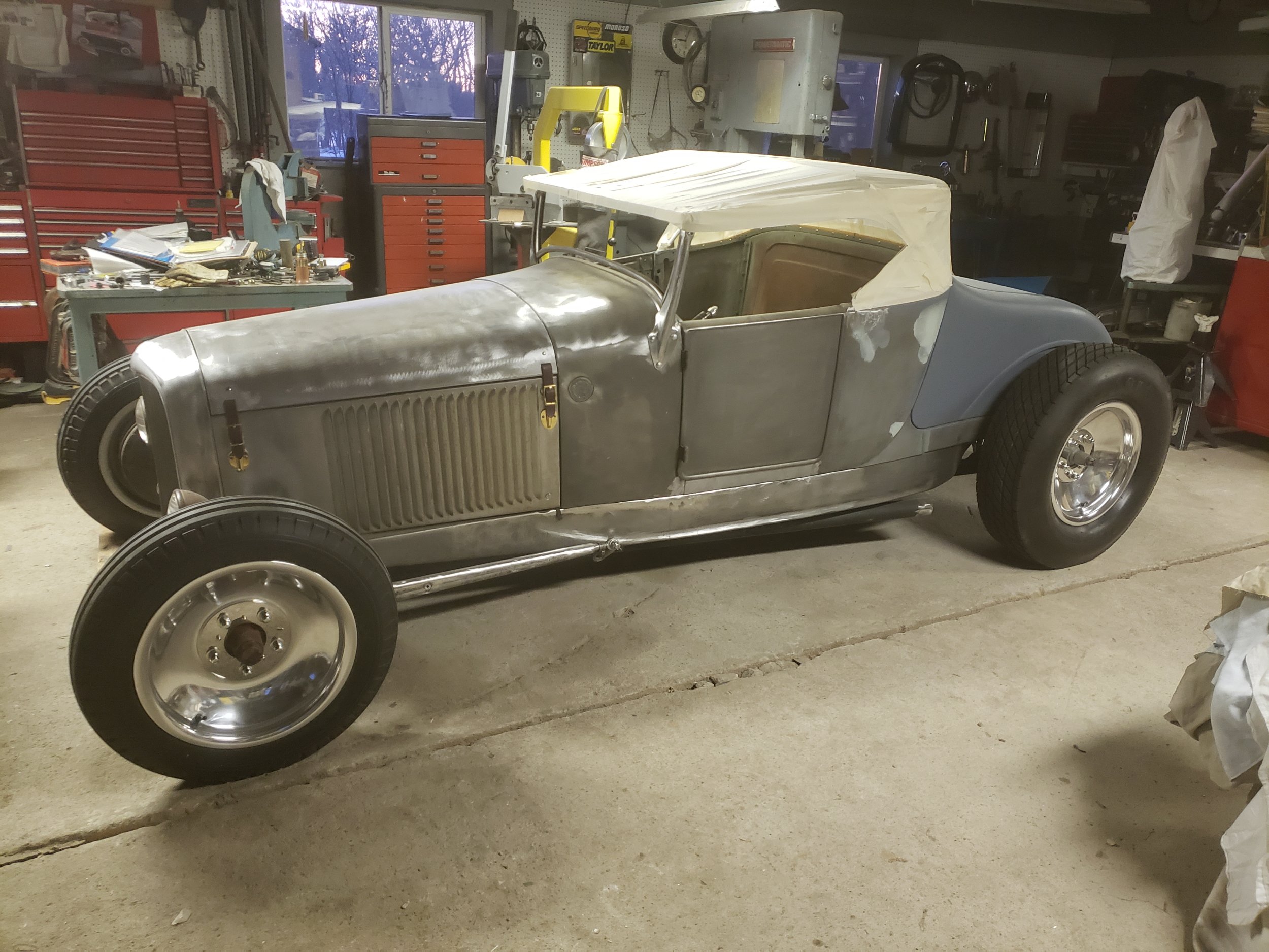

    As I stumble through the body work I wanted to share some details. I always like using original parts. Here you see the restored hinges and door latches. When I decided to put a top on the car, I removed the original Model T post that protruded out of the side of the body and installed my own take how the top should fasten. Little Runaway will get painted with acrylic laquer. The paint was purchased from a friend Don Coleman 30 years ago. @ct1932ford FB_IMG_1742552238586.jpg FB_IMG_1742552265480.jpg FB_IMG_1742552205002.jpg FB_IMG_1742551996899.jpg 1692467896691.jpg

    I wanted a top on this roadster. So I copied a Bob Lee top, used some cheap masking tape to mock it up. 20230118_181516.jpg 20230330_180725.jpg 20230103_181746.jpg 20230225_190503.jpg 20230226_182650-1.jpg 20230304_163056.jpg 20230226_184743.jpg

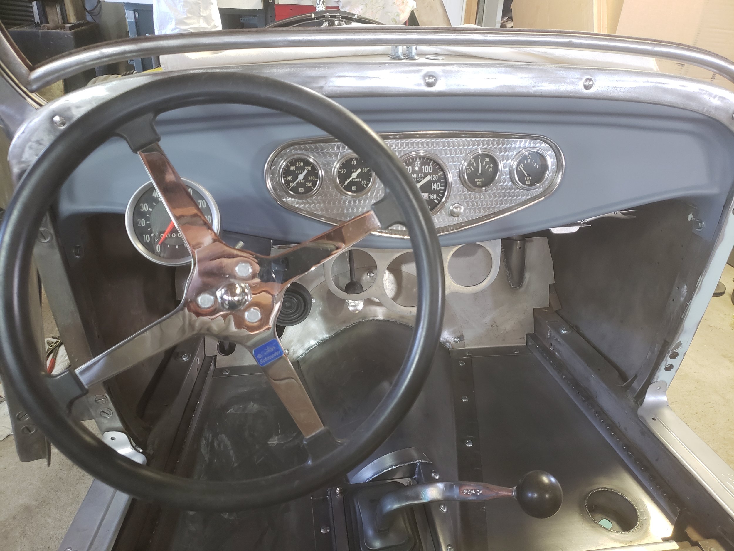

    The dash is done and the gauges are ready to go.
