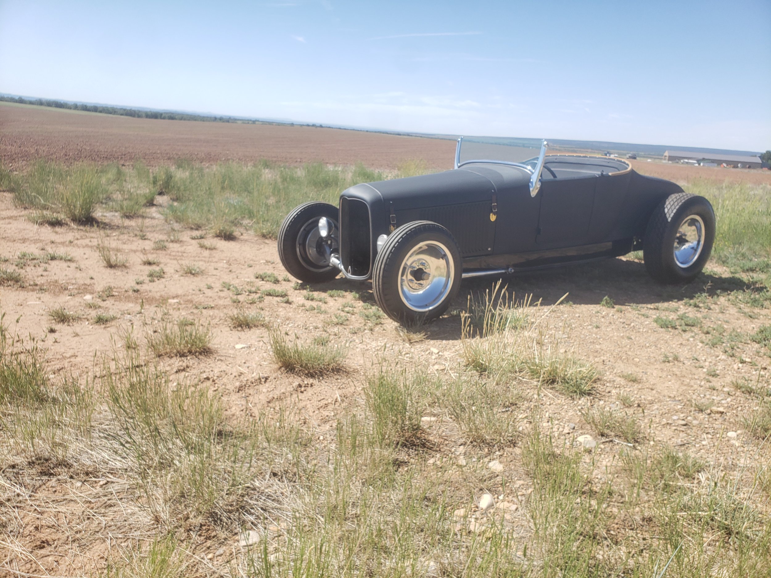

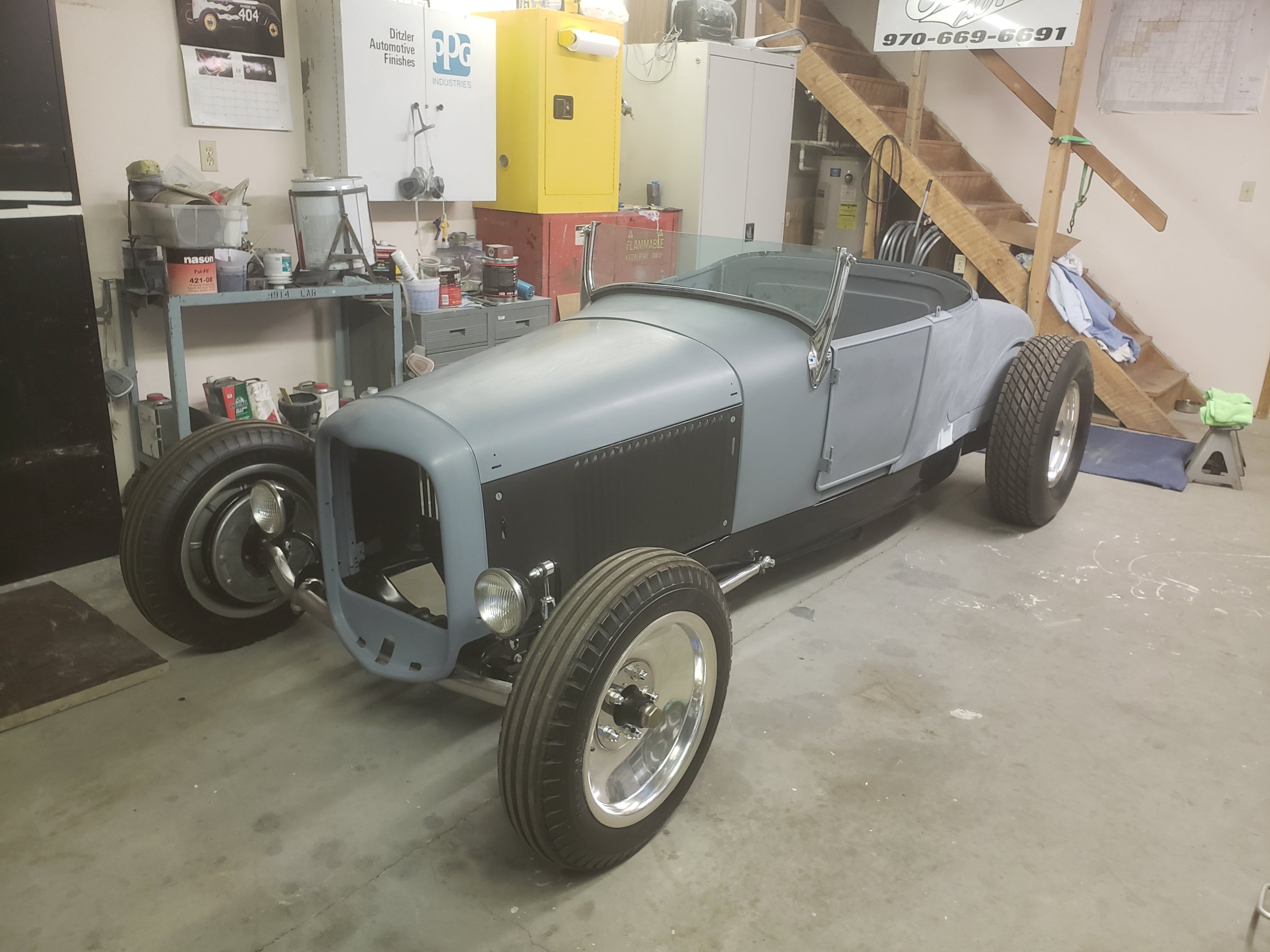

  5. 270bob
    Joined: Mar 26, 2014
    Posts: 152
    270bob
    This is the current status of Little Runaway. I decided to leave her in primer and put her together. 20250526_201308.jpg 20250523_205736.jpg 20250523_194349.jpg 20250525_152507.jpg

  9. 270bob
    Posts: 152
    270bob
    Thanks, I had to make a new upper coolant pipe. The first one only fit the 2×4 intake. That motor wasn't going to be ready in time. Just need to make battery cables, go through the carburetor and run fuel line.

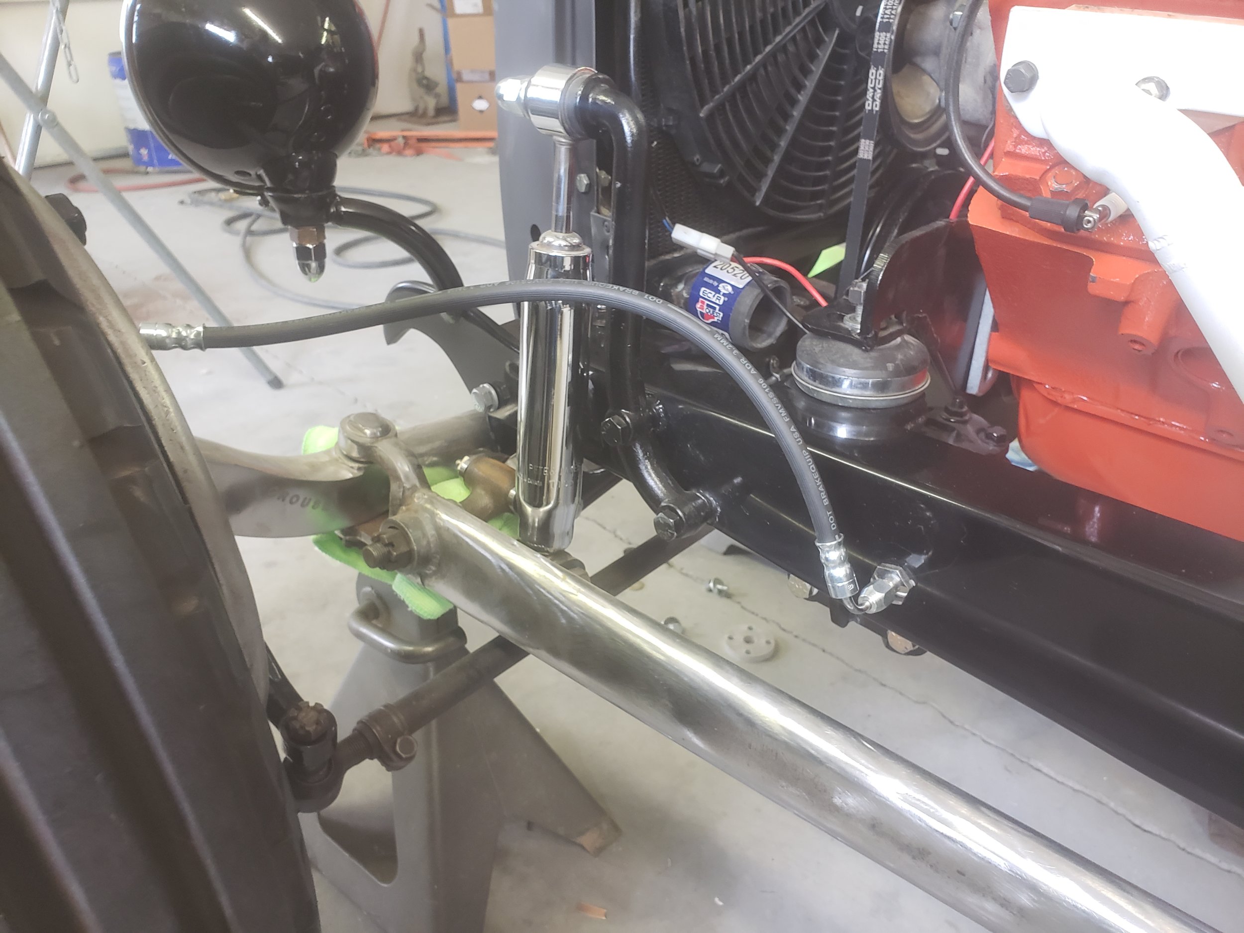

  14. 270bob
    Posts: 152
    270bob

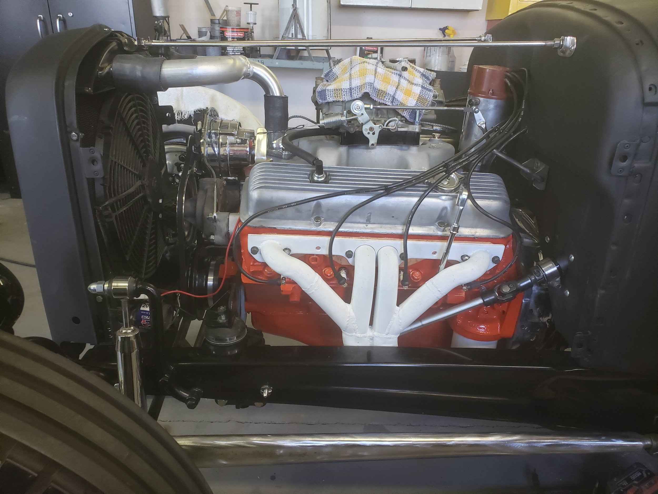

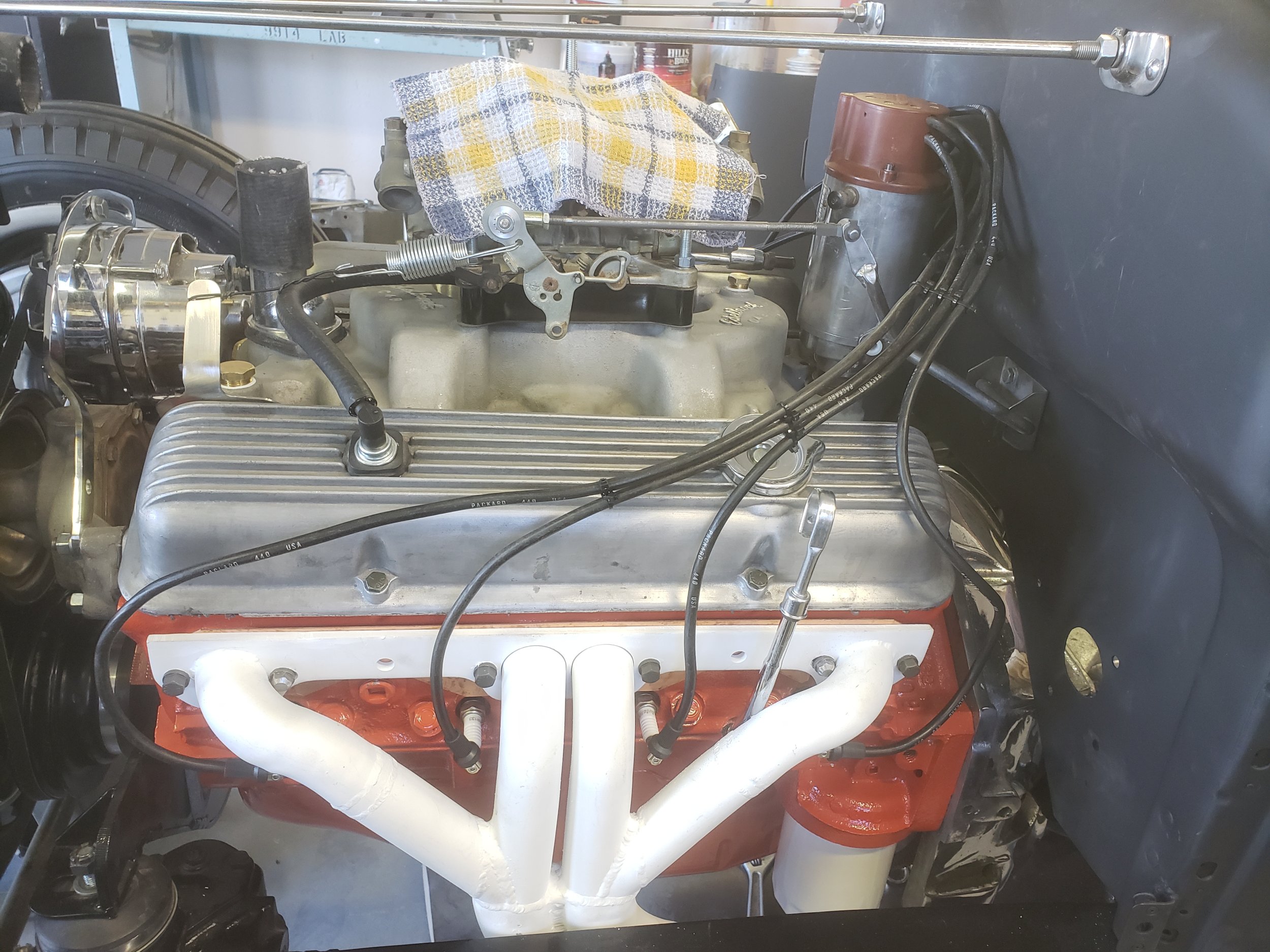

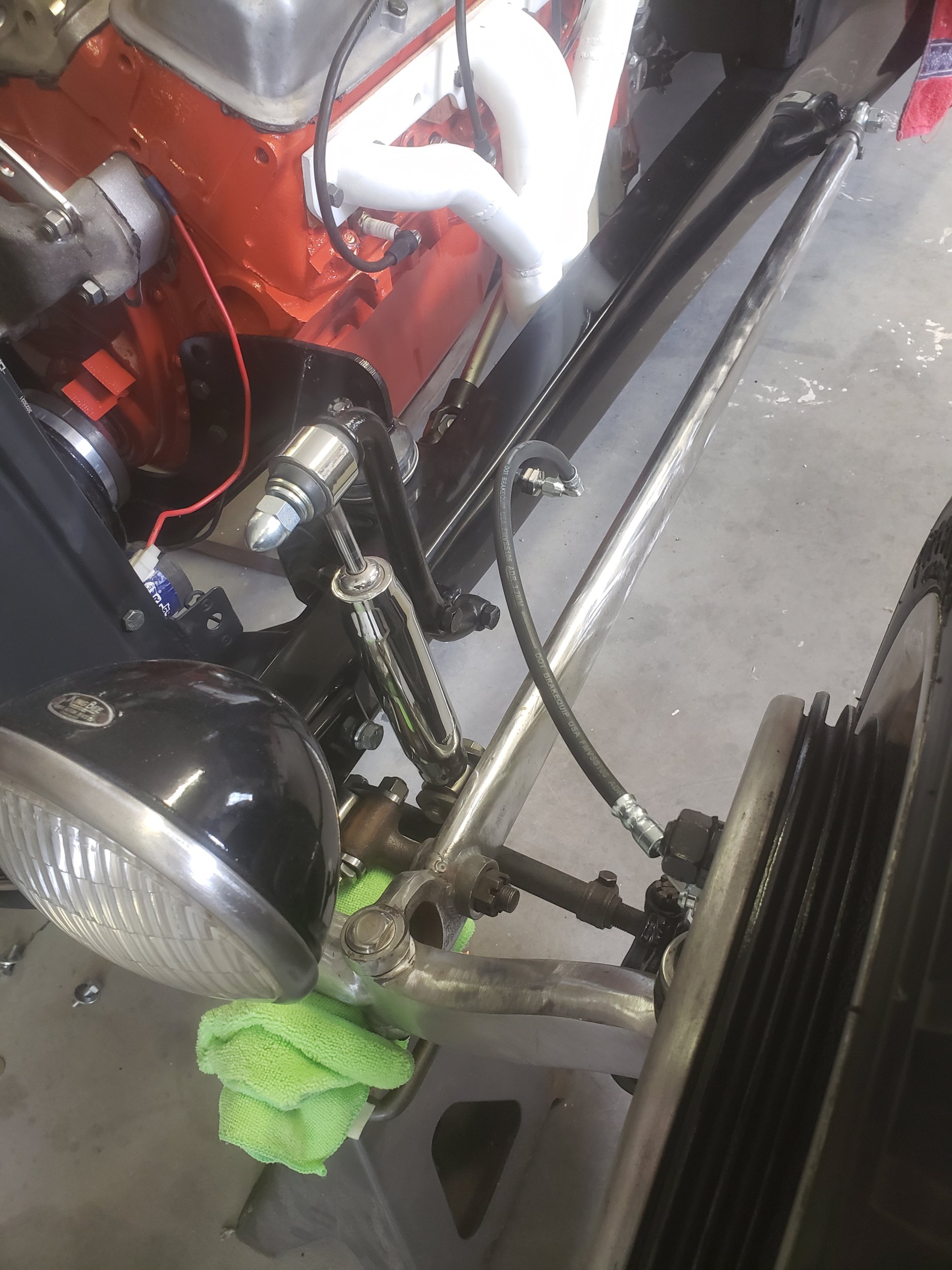

    Every car has a story. For me, every part on this car has a story. Some I will share and some I won't. However, the motor has an interesting story. I was having issues getting parts for my original motor, so Dad says, "take this motor and freshen it up till you get your parts. It will require good gas because it has a lot of compression. " He informed me that he bought this motor brand new in 1969 and put it in his 1960 corvette. I ran the numbers on the engine and it is a factory DZ 302. I am running the Duntov 30/30 cam, Edelbrock C4B and Holley carb that he ran. I added the mag and Packard 440 wire, but it is all about the same. Can't wait to here this run. Finally got the brake hoses made the way I wanted them. 20250528_174832.jpg 20250530_160207.jpg 20250530_160219.jpg

    Thanks, hoping to fire it this weekend. I will report back when I do. It was pretty cool freshening up the motor. Ir is standard bore and everything checked out within tolerance. I found the front timing cover was damaged and had to weld up a small hole and fix some dents. Dad said the original plastic timing came apart and that is what the damage was from. The motor has a new double roller in it now.

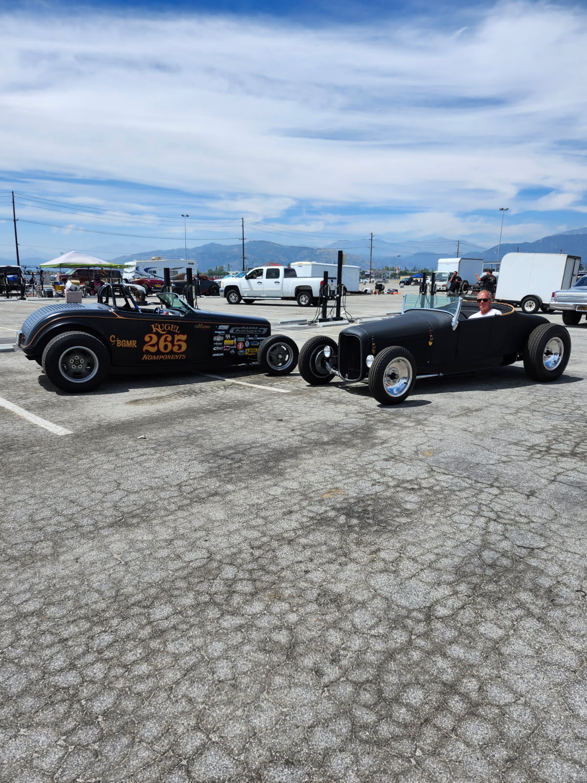

  20. 270bob
    Posts: 152
    270bob
    See you all in Pomona! 20250611_101143.jpg 20250611_101143.jpg 20250611_101134.jpg 20250611_101207.jpg

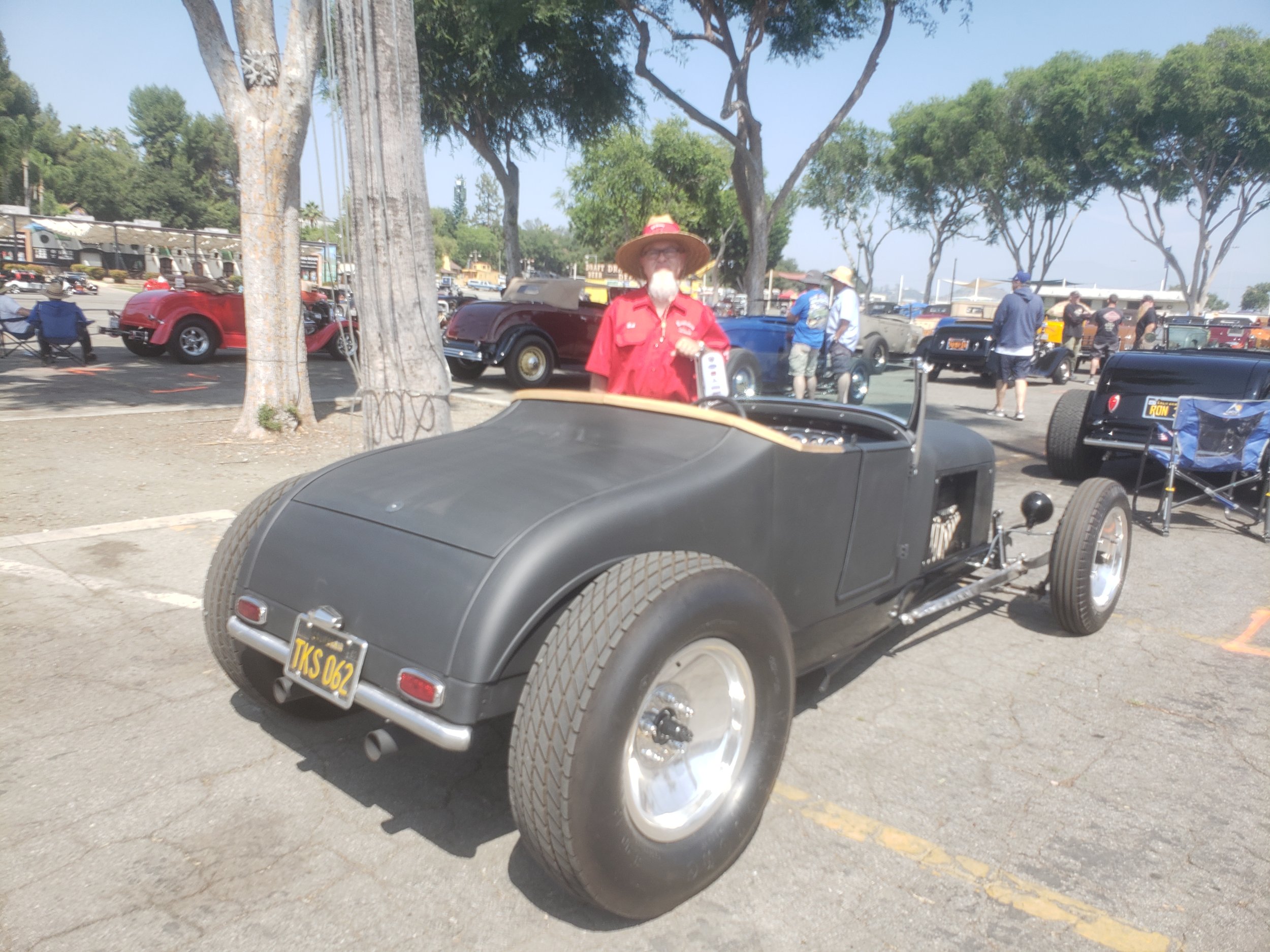

  24. 270bob
    Posts: 152
    270bob
    Had a great time at LARS, the car worked great too. 20250614_074549.jpg 20250613_102230.jpg 20250613_102137.jpg image000000.jpg

  27. El Hueso
    Joined: Nov 24, 2001
    Posts: 2,454
    El Hueso
    How low is your seat? Did you sink it in? It seems like you have a pretty low seating position for a T.
    Uncle Ronn likes this.
  28. 270bob
    Posts: 152
    270bob
    Great question, I made seat pans so I could sit low. That is why I chose a Deuce frame and shaped it to the outside of the body. I never liked the original seating position and if you use an A or T frame the are directly under your ****, so you end up sitting on top of the car instead of in the car. Thanks

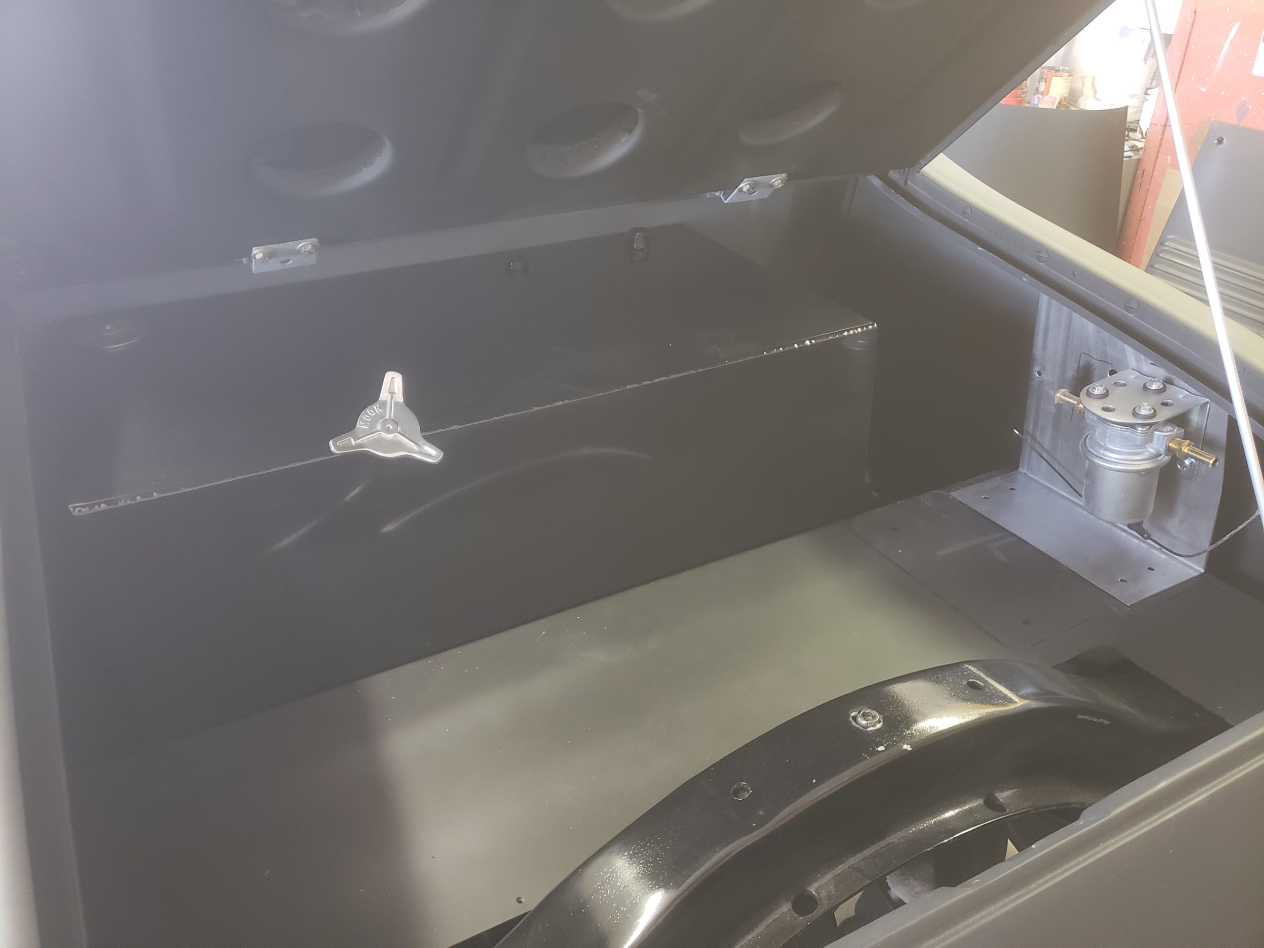

  30. 270bob
    Posts: 152
    270bob
    Here are a few photos of the seat pan and how you sit in the car. I have a top built for the car and you can see it in the photos too. I found the cartoon illustration in a Street Rodder magazine from 1997. The view from the back of the car is really cool, you can only see the top of the driver's head. I will upholster a traditional roadster bustle and will make it appear as if you are sitting lower in the car. Thanks Resized_20220213_164624 (1).jpeg 20210913_134633.jpg Resized_20220213_164505.jpeg 20210904_101623.jpg 20221223_154734.jpg 20230225_190503.jpg 20230226_182524.jpg 20230504_192842.jpg
