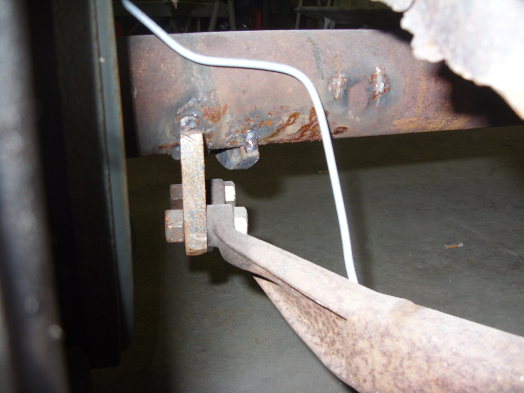

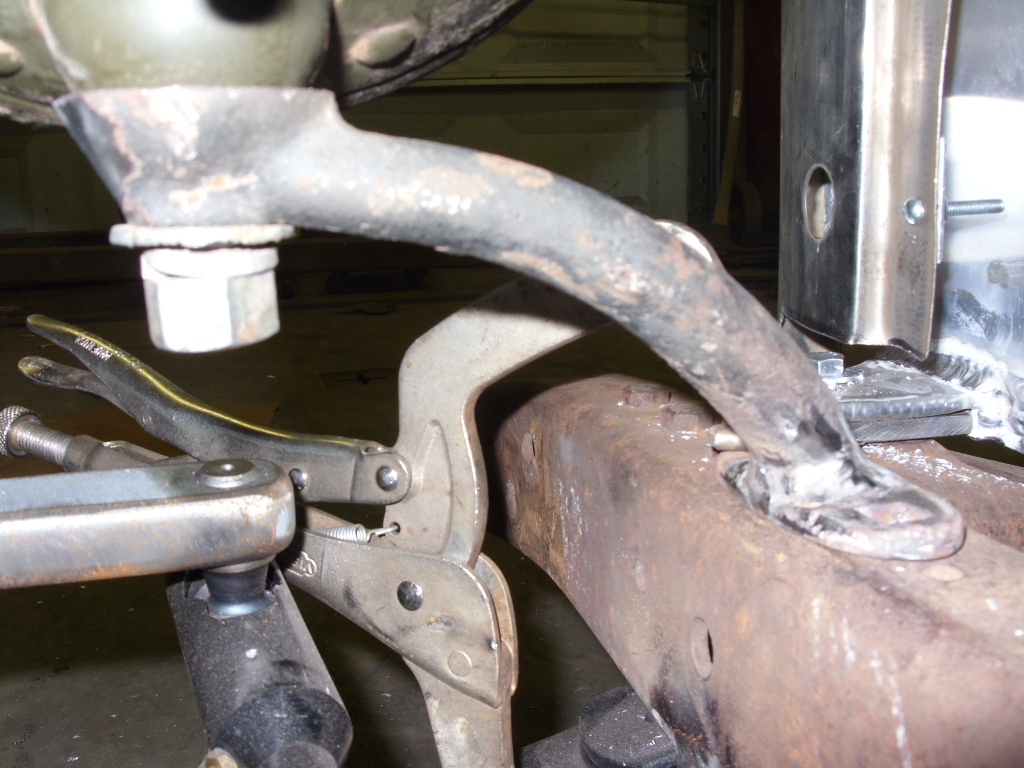

    Nice x member ,I did mine the same way but heavier ,Rear radius rods also / That will keep the motor and trans to the center of the frame more and you can tuck up your exhaust ,Slick move.....Looking great ebay pics 410.jpg just a rear shot I also have 2 in front ,You might want to consider that A true x has no flex

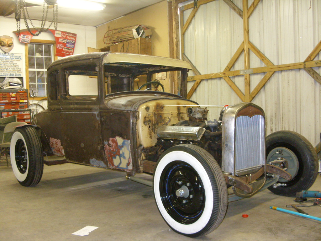

    Looks like you had to lengthen the Model A frame a bit to get the Caddy to fit without butchering the firewall. What, about 4 or 5 inches added to the frame?
  19. Southfork
    Joined: Dec 15, 2001
    Posts: 1,465
    Southfork

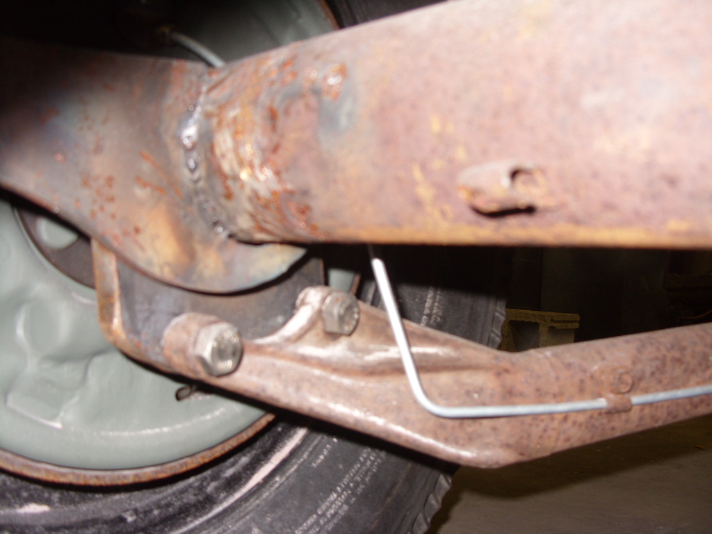

    Also. what about rear radius rods? Got any pics of the radius rods connecting to the 9 inch Ford rear end?
  20. 39 chevy kustom
    Joined: Aug 9, 2008
    Posts: 427
    39 chevy kustom
    I went from the 103 wheel base to 107. That is with the rear axle about 1" forward from stock. I will get some pics. of the rear radius rods and mounts on here today.
  21. 39 chevy kustom
    Joined: Aug 9, 2008
    Posts: 427
    39 chevy kustom
    Keep in mind this is not all hard welded yet . The radius rods will be triangulated and have a top mount similar to ladder bars when completed.
  22. JeffreyJames
    Joined: Jun 13, 2007
    Posts: 16,626
    JeffreyJames
    from SUGAR CITY
    Looking good Tommy!! I normally like the Wheel bases at the stock measurement but your's looks good. I think it's because it's not chopped so the whole thing doesn't look really squashed and long ya know?
    I also like how you ran the two rear lines to two rubber lines. On my '35 I did the two hard lines down the wishbones but I am putting them to a br*** "Y" junction block and then to only one rubber line out through the frame to the MC. The catch is that I cannot find a damn "Y" they are all "T's"!!!! I think I have a line on one but the two rubber lines is a nice option.

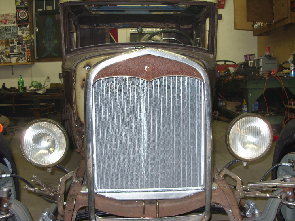

  26. 39 chevy kustom
    Joined: Aug 9, 2008
    Posts: 427
    39 chevy kustom

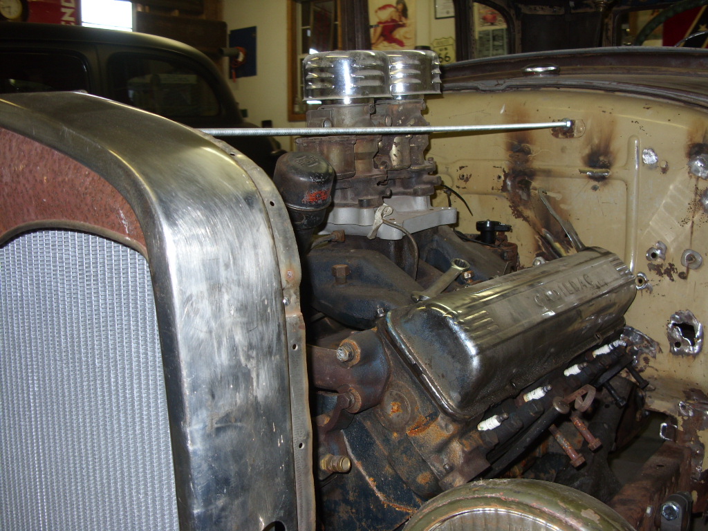

    Some pics. with the radiator and grill shell mounted. I made the headlight stands from an a model light bar . The headlights are said to be 1930 oliver bulldozer
  27. hotdamn
    Joined: Aug 25, 2006
    Posts: 2,651
    hotdamn
    the A shell doesnt look bad by any means but I think the duece shell is where its at!
    but really though, its that 55 caddy steering wheel that sets it off!!!
    I'm gonna run the same wheel in my 54, but damn its a lot of work though!
    I've gotta splice my steering shaft because of the difference in splines...
    but looking good aint always easy:D
    looks great Tommy, keep it up!!!

    Love it. Bulldozer lights, what else would a redneck use?

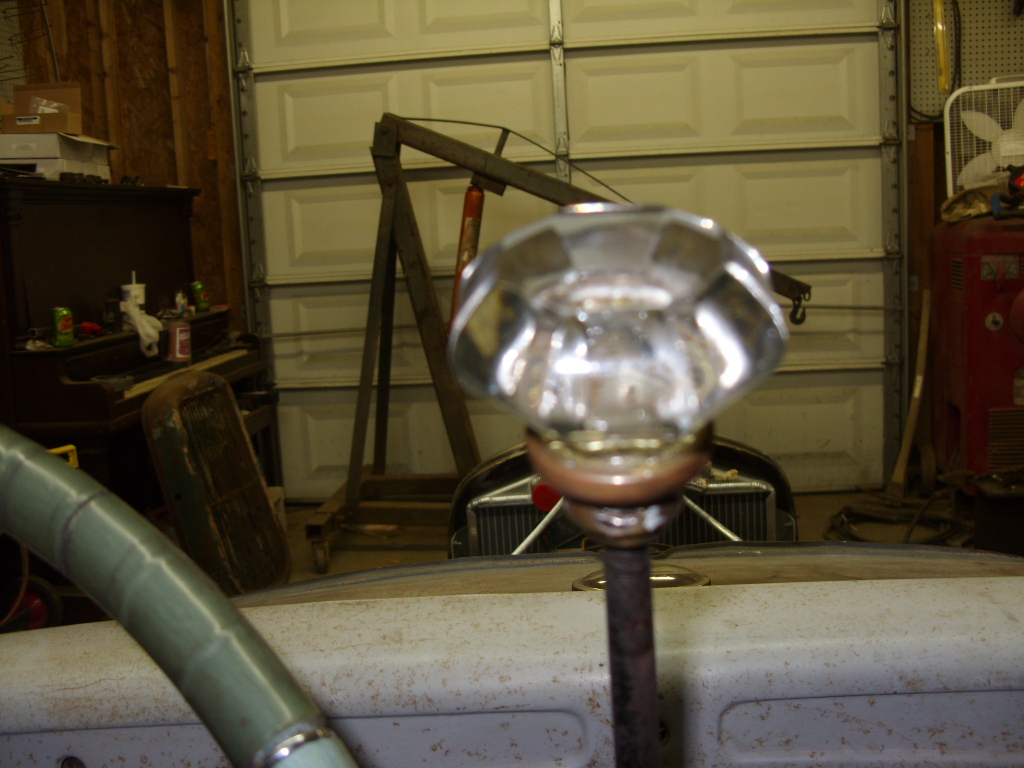

    Some more pics. Just aquired from my friend Mike Overcash ( BigO on the H.A.M.B.) a pair of 94s and a vintage speed adapter plate and air cleaners. Also a pic. of my perfect gl*** door knob shifter knob. Just to give props where they are due I gathered a lot of parts for this build from BigO Thanks to him and also thanks for the comments guys , I am very excited that this is coming together as well as it is .
