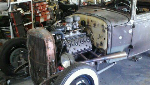

  4. 39 chevy kustom
    Joined: Aug 9, 2008
    Posts: 427
    39 chevy kustom
    Got them from smith and jones in sc , I am pretty sure they were made by howells ,fit very well . I cut what was left out of the cowl bottom and used a 1/2 inch flanger so the panel and the original fit flush . I plan to do the other side in the next day or two and will post more detailed pics. of what i did.

  9. 39 chevy kustom
    Joined: Aug 9, 2008
    Posts: 427
    39 chevy kustom
    I am not planning on using a kickdown . all shifting will be with the shifter. The rear spring is a 40 ford front spring.

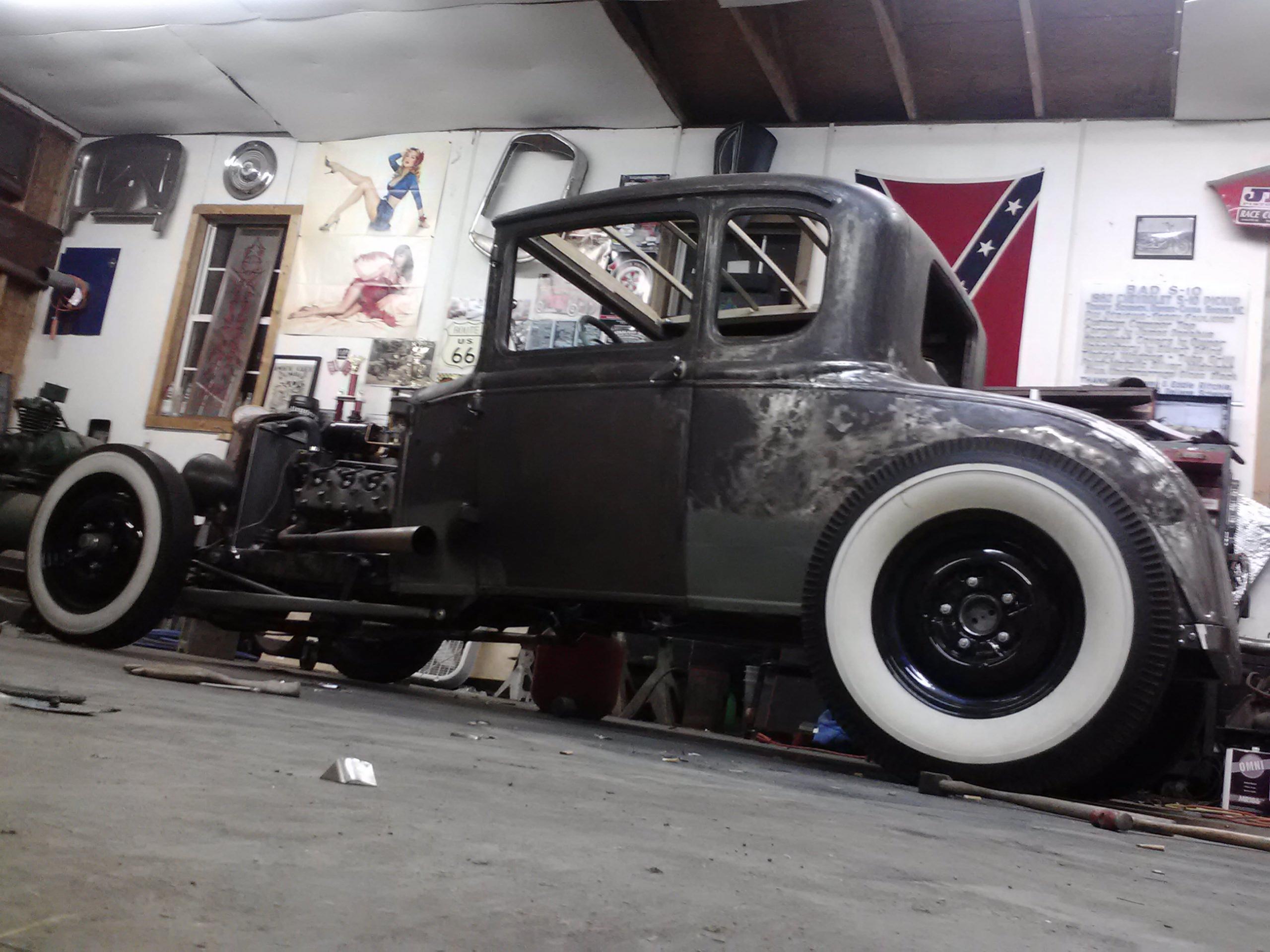

  18. 39 chevy kustom
    Joined: Aug 9, 2008
    Posts: 427
    39 chevy kustom
    I will as soon as I figure out how to post pics. from my new stupid phone. easy to post to profile but have not figured out how to post to a thread . There are some new pics. on my profile.

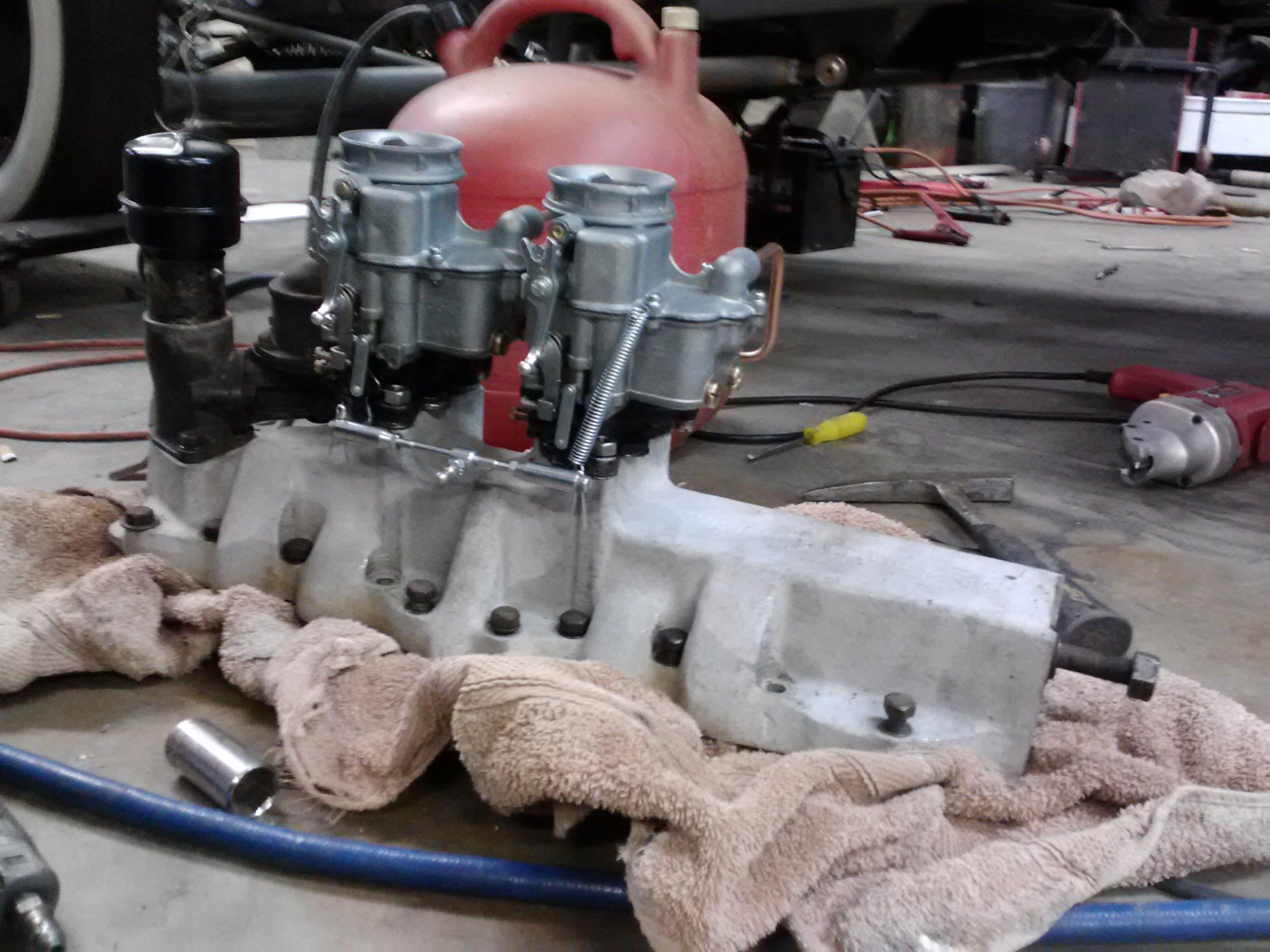

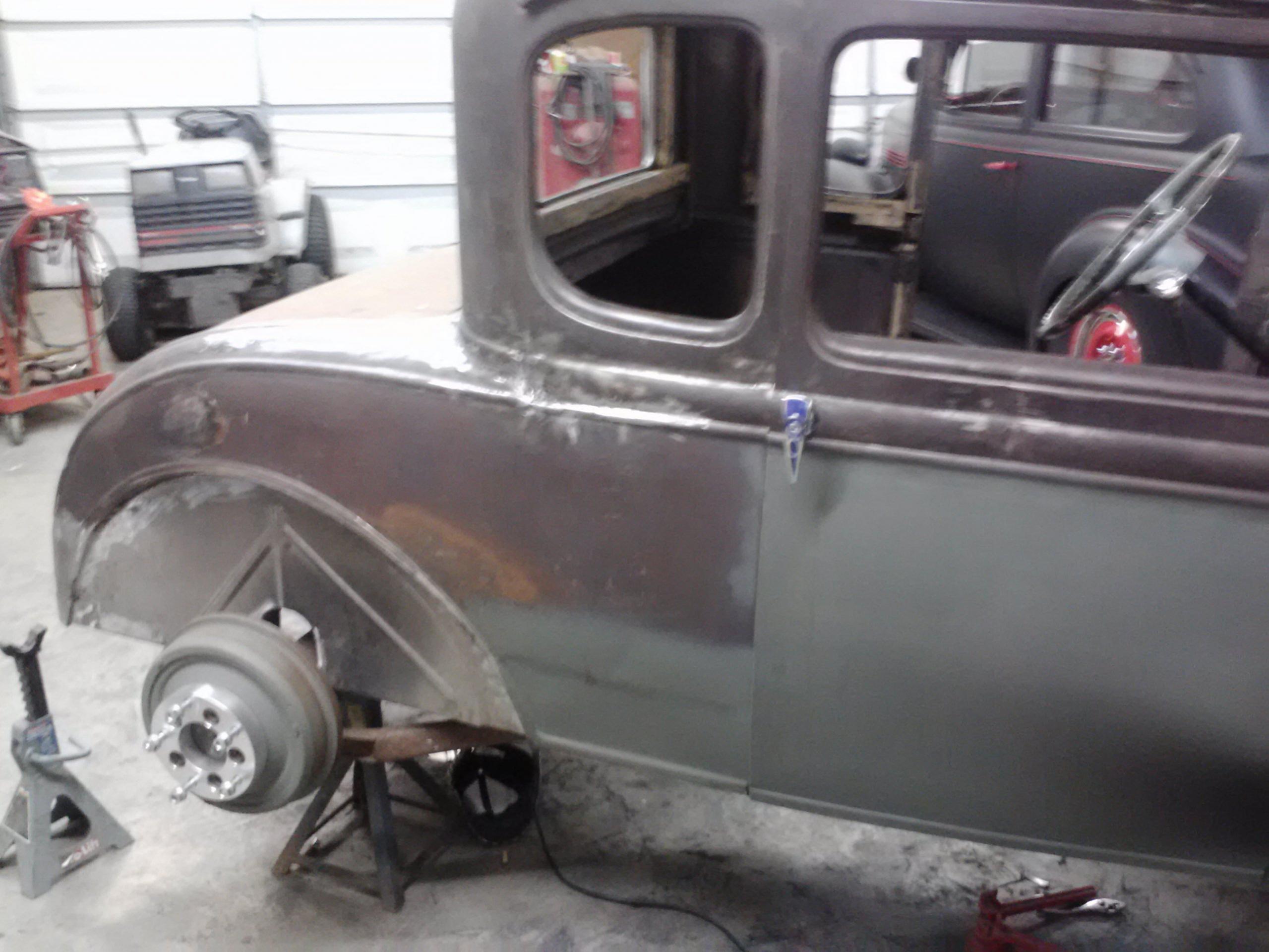

  19. 39 chevy kustom
    Joined: Aug 9, 2008
    Posts: 427
    39 chevy kustom
    So it has been almost a year since any new pics. sorry bout that . anyway if you had followed this thread before you know how rough this thingg was. And I had planned on caddy power but with a realitively fresh and warmed up flatty in my garage and the cost of building the caddy it was a no-brainer. 35 or 36 flatty with mild cam , johns lifters edmunds 2x2 and apair of fresh 94's , lakes headers. Used Howells 9'' rear corners and made them work with a lot of m***aging . It now has a rear end and looks like a car.

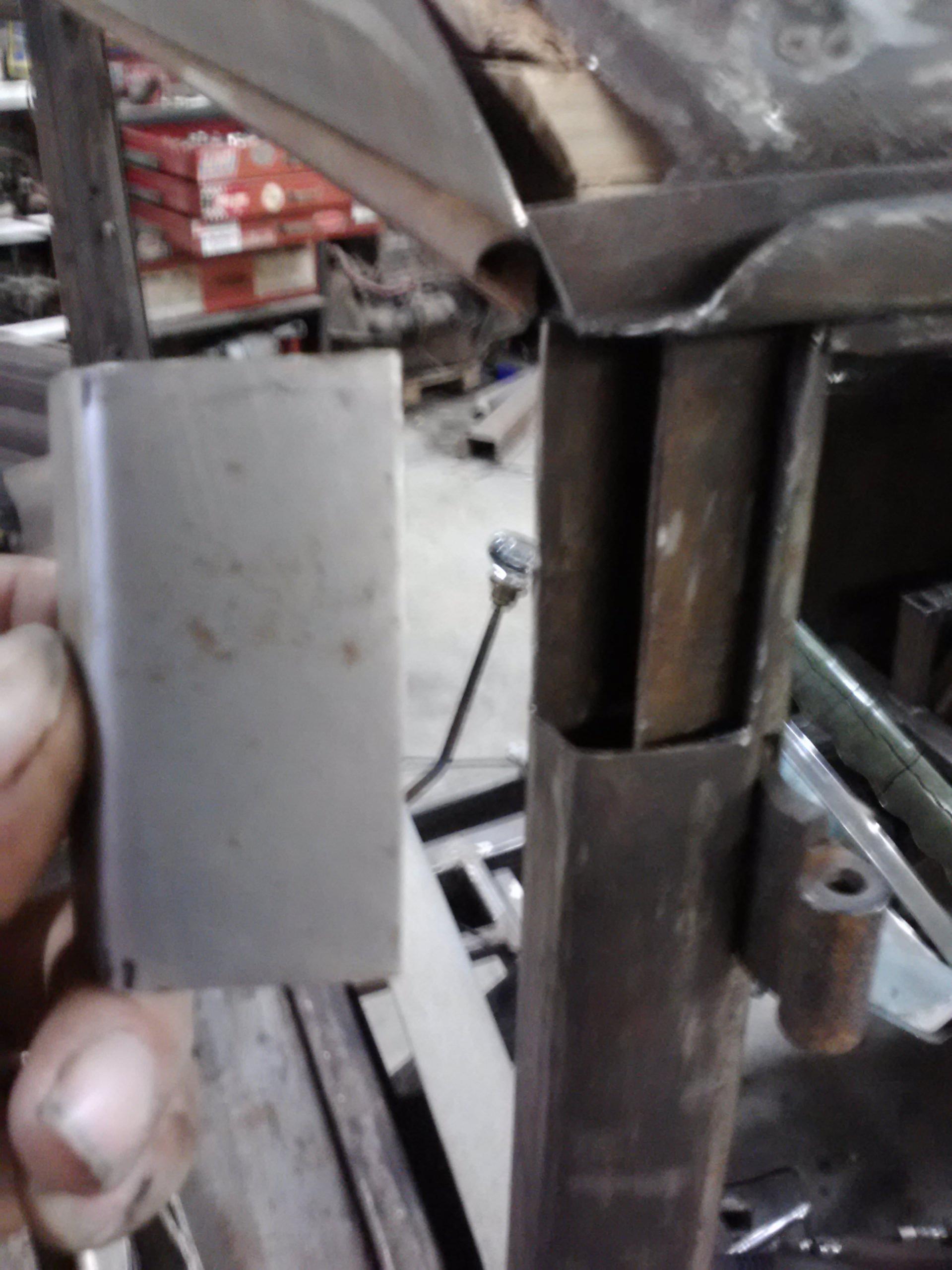

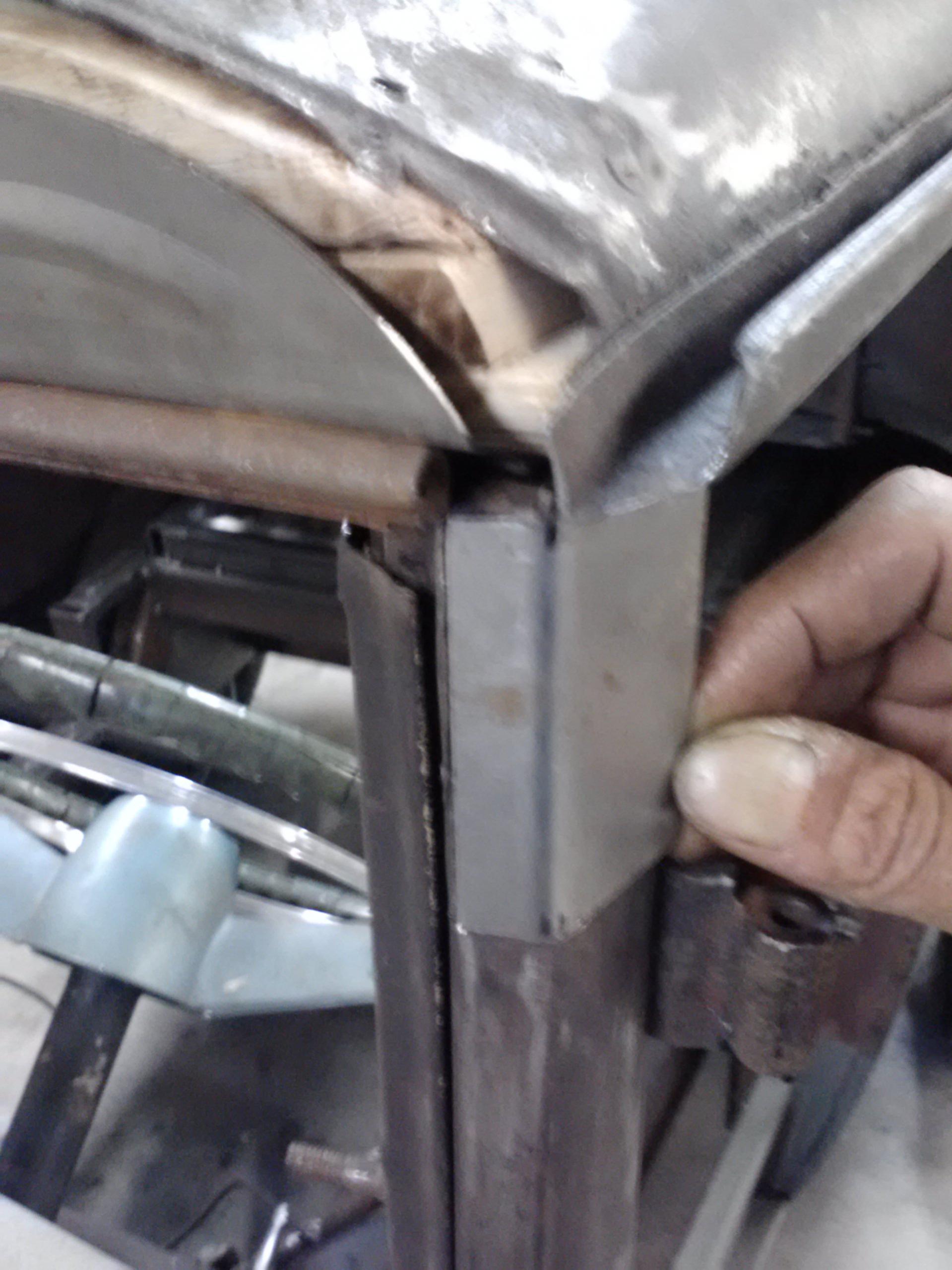

  20. 39 chevy kustom
    Joined: Aug 9, 2008
    Posts: 427
    39 chevy kustom
    door post repair from scratch

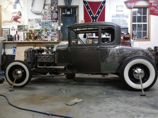

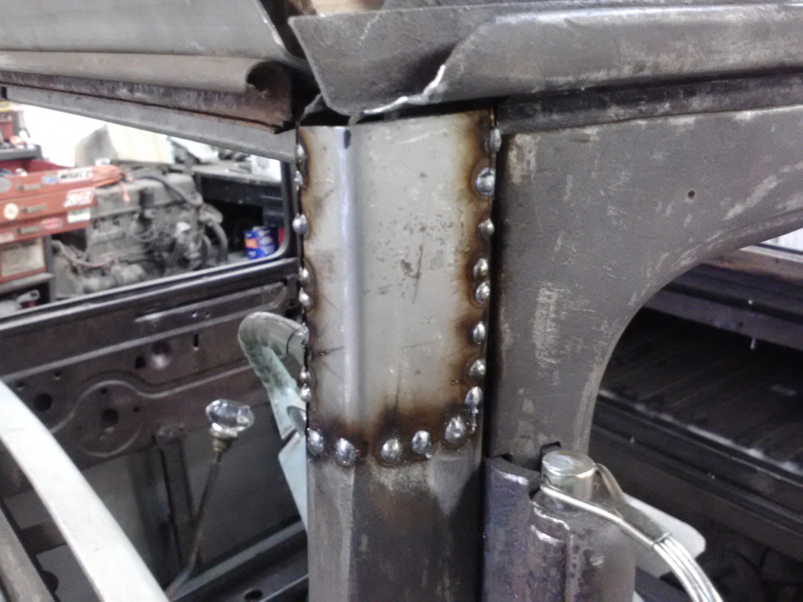

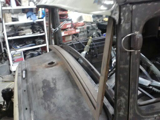

  21. 39 chevy kustom
    Joined: Aug 9, 2008
    Posts: 427
    39 chevy kustom
    made one decklid out of three. wheel weells in and a working nice winsheild frame. nothing and I mean nothing aftermarket fit e
    with out major modifications . probably have 30 or 40 hours in the wood header and sheemetal that covers it. in and out , in and out...
