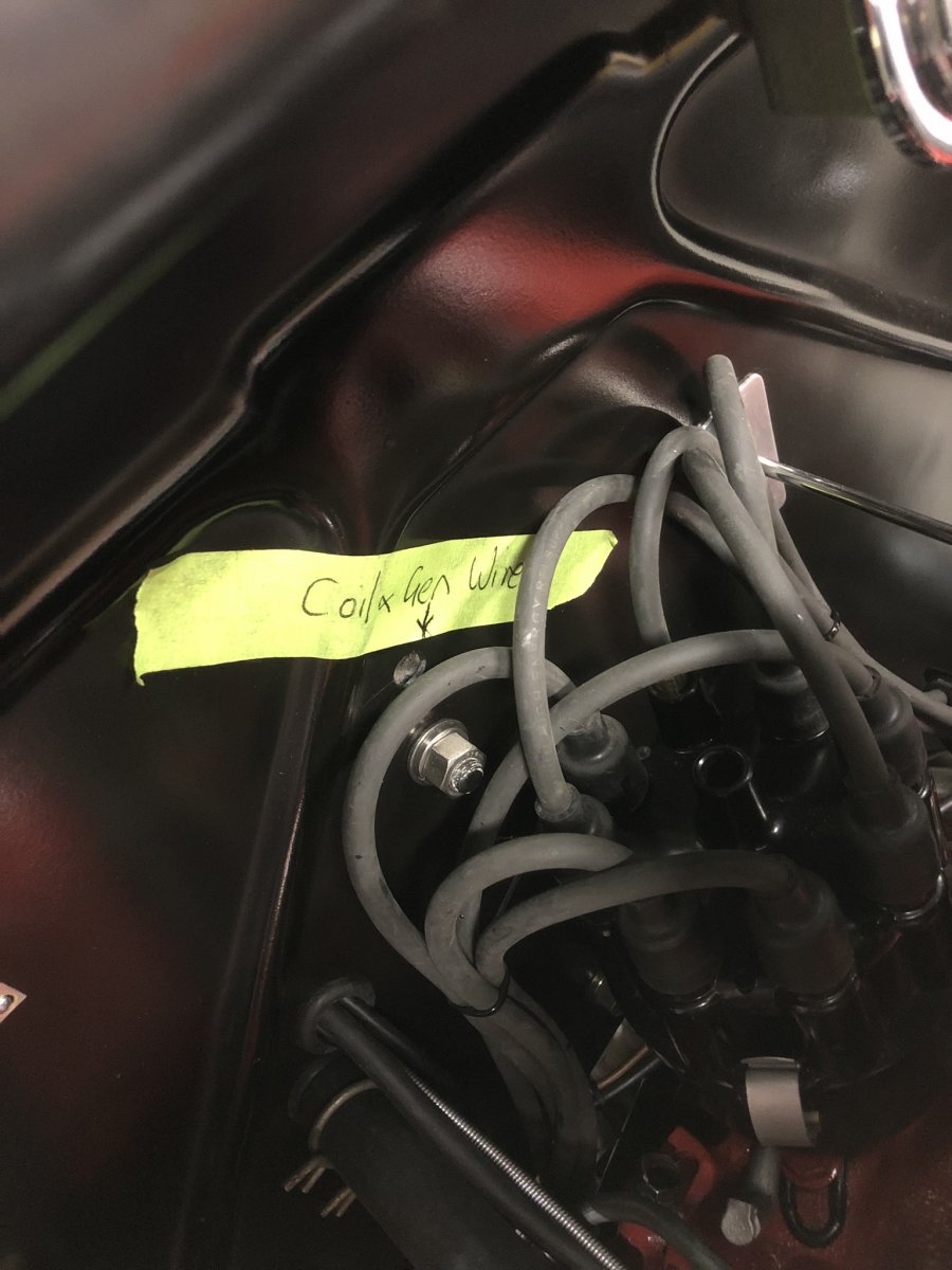

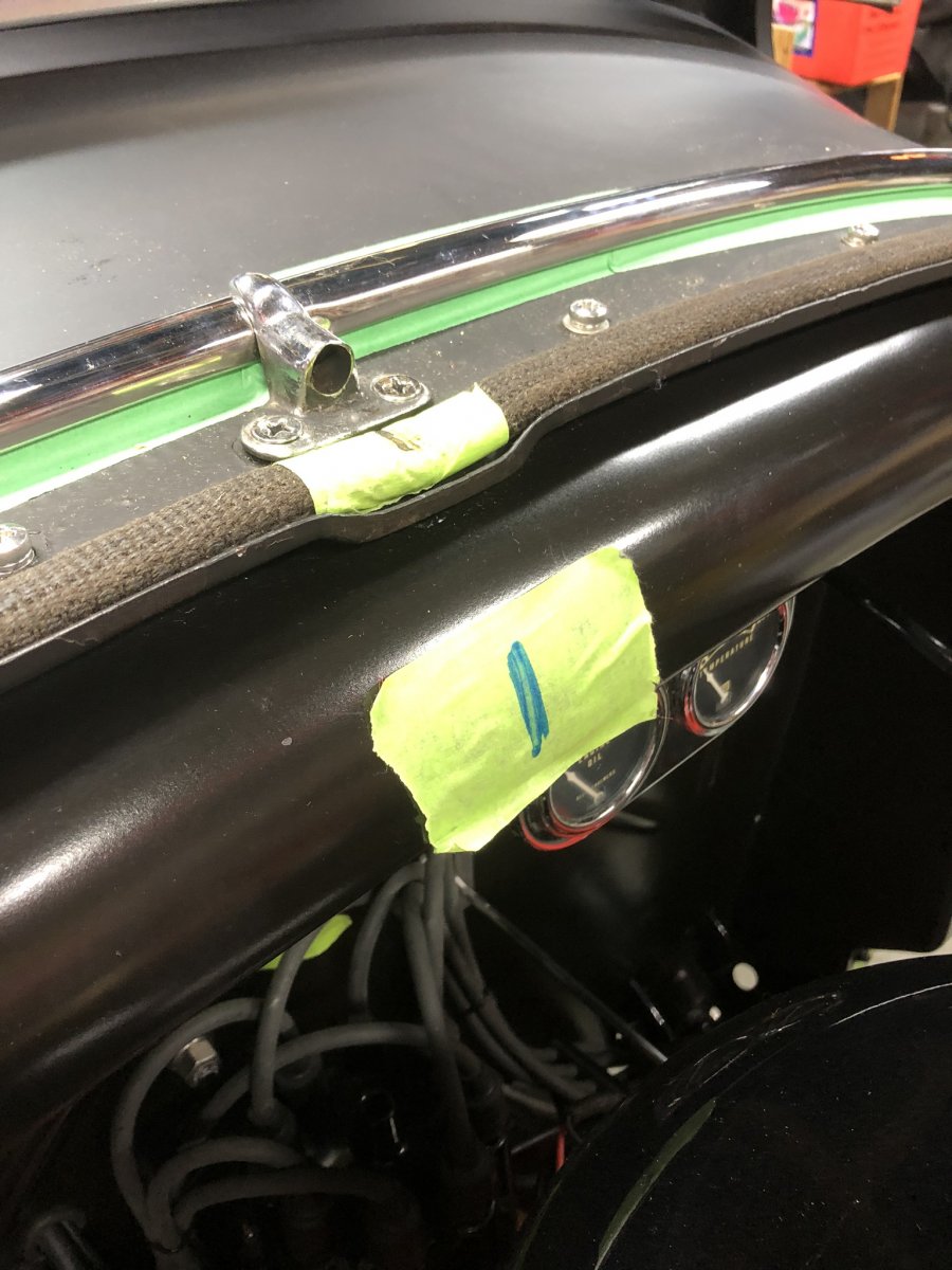

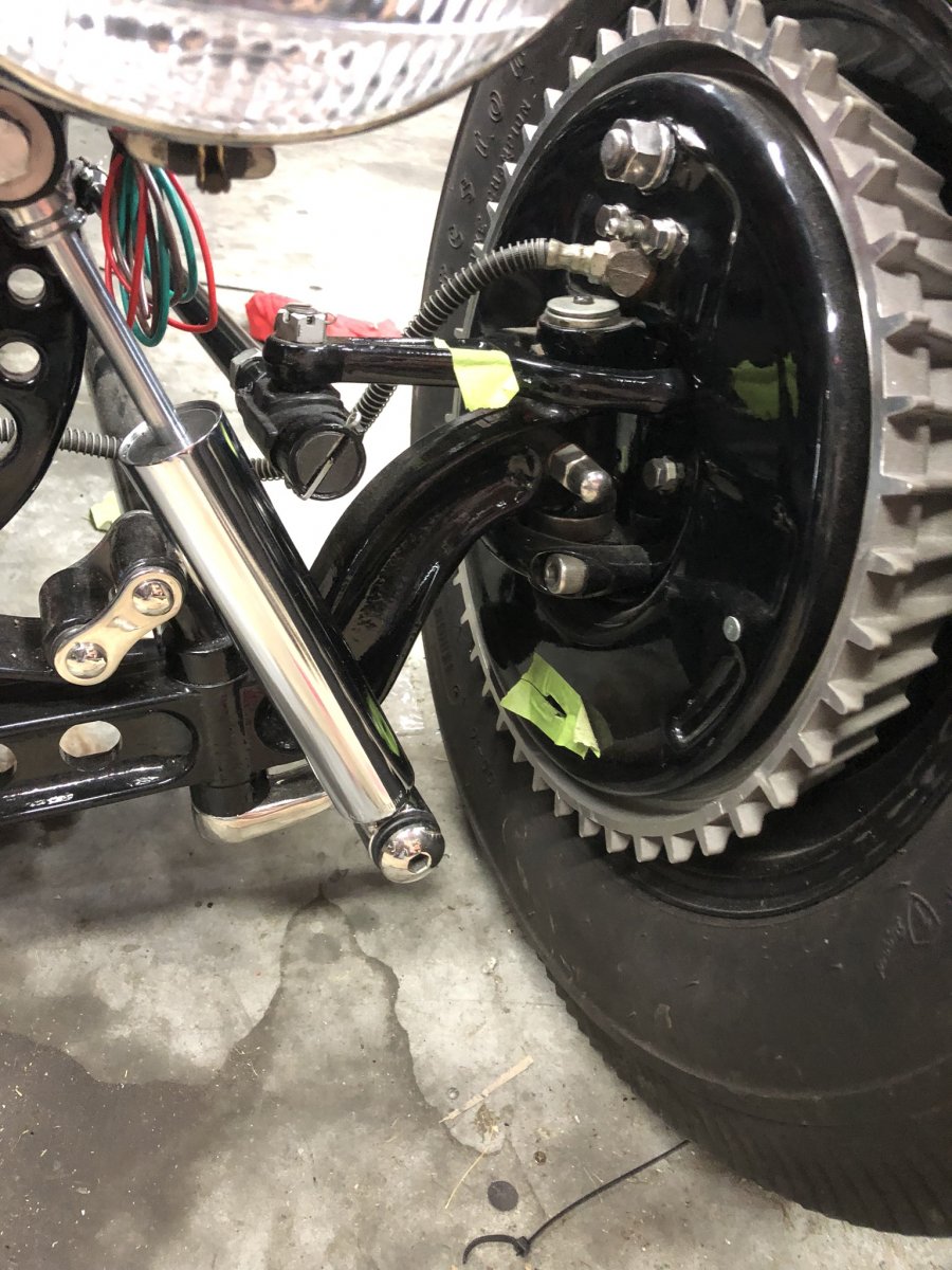

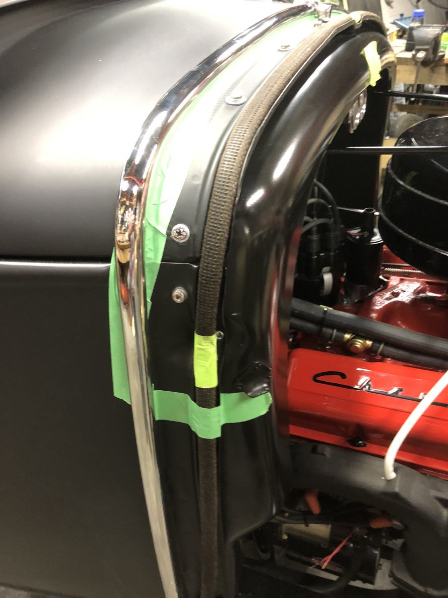

    I use masking tape all the time when working on my car
    Ideal for holding chrome or stainless trim in place,or around parts so not to scratch the paint, IMG_6499.jpg or for making lines on the car,like a centre line so you have a reference point each time your fitting a trial part IMG_6500.jpg or for the electrical wiring to remind your self what wires go through certain holes, IMG_6498.jpg or when you chip paint while ***embling stuff, so you can go around and touch up all the chips in one go,
    Or to remind yourself to adjust the brakes,with tape round the adjuster slot
    If your installing say suspension parts ,I use tape an wrap it quickly around any bolts or fasteners that may need tightening later once the entire ***embly has been ***embled

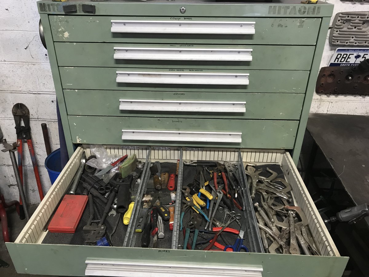

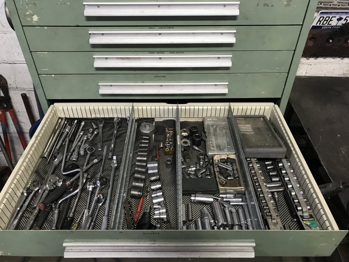

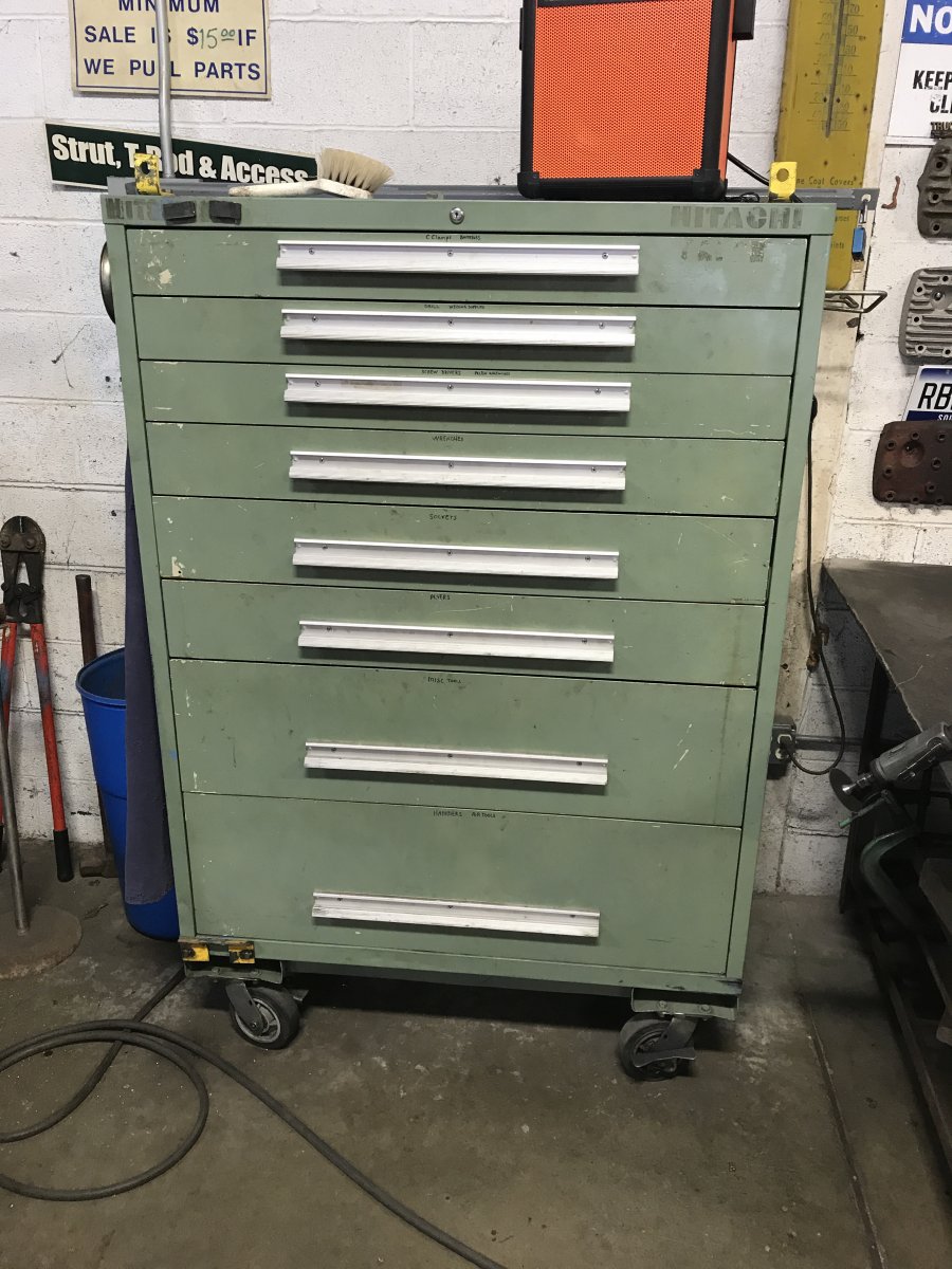

    This is not really a trick, but it is a way to beat the system.
    I had an old Mac tool box that was the cheap version without roller bearing drawers. It was a pain to use when full so I wanted to upgrade. Sticker shock set in when I priced new tool boxes and I believed that there had to be a better way. I stumbled across "Stanley Vidmar" industrial cabinets. Super heavy duty with roller bearings and all. They show up on auctions when large industrial plants are closing down, but I found one on a Craig's list search for $550. I sold my old Mac box for - you guessed it - $550. So I got a huge upgrade with no cash out of pocket. You would be surprised what you can find if you know what to look for. 2019-10-08 16.00.29.jpg 2019-10-08 16.00.58.jpg 2019-10-08 16.00.44.jpg

    great score, still using my old ones but upgraded the roller sidles with kitchen cabinet roller slides from a garage sale find

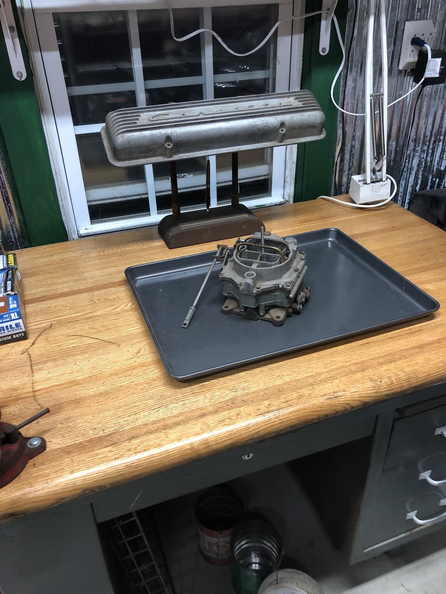

    Love that light shade.

  29. I’m a junky for stuff like that! What else do you do with a flawed single cool valve cover?
